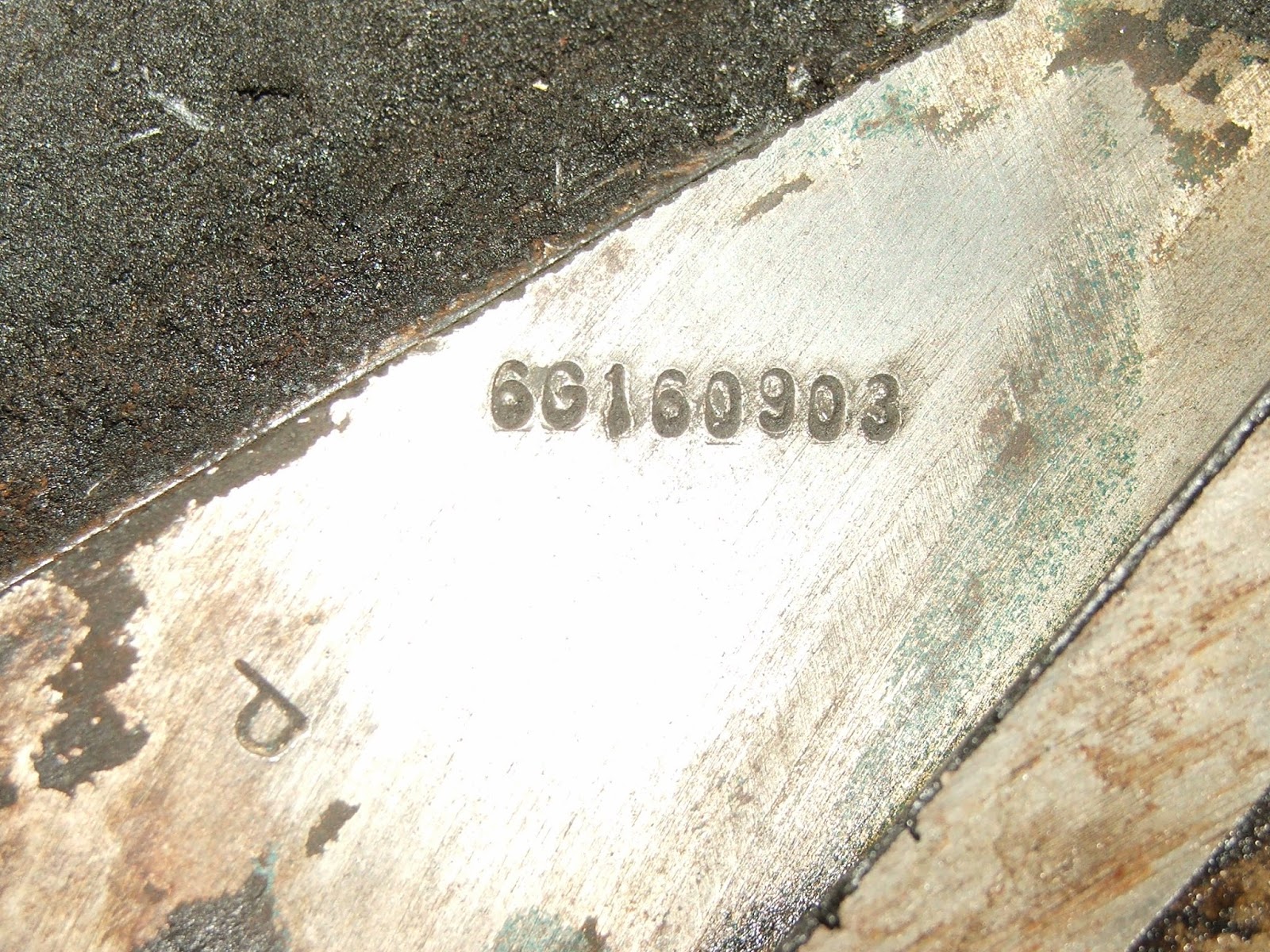

The partial VIN's are located on the drivers side, rear of the block, just underneath the cylinder head.
There is a small flat pad there where they stamp the partial VIN on.
It will have the year, the plant, and the consecutive vehicle number only.
The attached example is a 70 429 block from Lorian, and because the first digit starts with a "5", it was used in a Mercury, Lorian was an "Intermediate" facility so it most likely was in a Montego or Cyclone I believe.

Post Options Post Options   Thanks (0) Thanks(0)   Quote TV 2M8O Quote  Post ReplyReply Direct Link To This Post Posted: 28-February-2016 at 10:06AM
WOO HOO.... found it. Mine's a number matching car!!!
