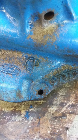

Alright, was on vacation for a while so i couldnt get back to you guys but heres the news.Finally got to stripping the motor down. And i found the issue... Nastiest blockage ever. Just rock solid.
Took me forever to get it cleaned up nice. A little scared that the motor might have some spots like this... But ill be able to see it when i take the heads off to do a gasket swap.
Thanks for all the help guys! Big smile
71 Ranchero, 302.
Points: 9608
Post Options Post Options   Thanks (0) Thanks(0)   Quote californiajohnny Quote  Post ReplyReply Direct Link To This Post Posted: 20-August-2017 at 3:09PM
 Shocked wow holy crap!! yep that'll do it!

Post Options Post Options   Thanks (0) Thanks(0)   Quote Rockatansky Quote  Post ReplyReply Direct Link To This Post Posted: 21-August-2017 at 3:43PM
exploratory surgery successful
might wanna check the oil screen in the pan for timing gear teeth & valve stem oil seals
those may need replacing too
