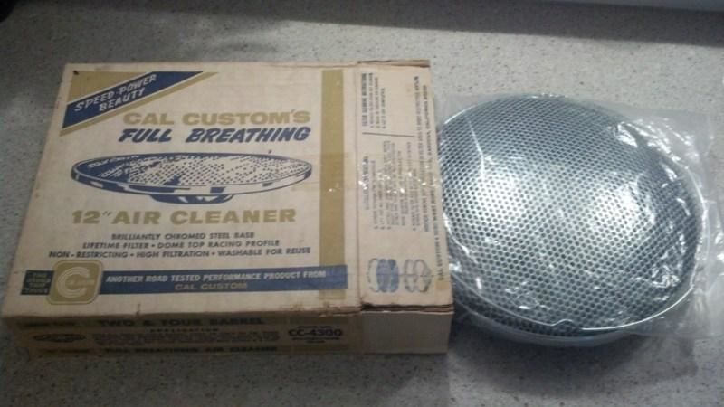

actually this is a Fly's Eye
apparently they were produced and distributed by several outfits including the original Stelling & Hellings, Cal Custom, Mr Gasket, Competition Products maybe more. here's a thread with good info https://www.yenko.net/forum/showthread.php?t=78862
