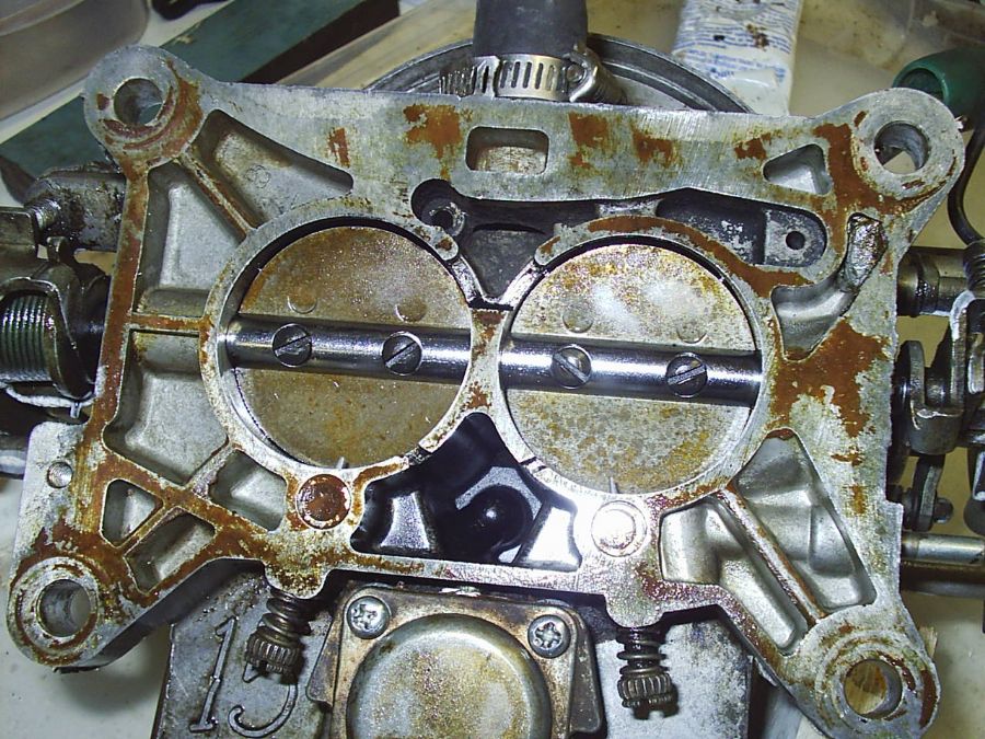

Another question, the motor I am working with is a 1971 351C 2bbl. I am working with the original carb and I think it is boiling the fuel in the carb bowl. Car runs almost perfect in the shop, take it out for a 5 mile run and upon return the carb is leaking at the base and very hard to start unless you open the throttle right up and crank it many, many times. I have yet to check the float level. Is there supposed to be a spacer between the carb and intake ( but not a EGR spacer ). I have a 3/8 inch spacer in my pile of used parts and maybe I should put it on ? Currently there is a paper thin metal spacer but I am thinking maybe the correct spacer is missing. IF I ad the 3/8 spacer the length of the mounting studs will be a challenge but will work with no threads to spare....Advice please .....

the thick insulator gaskets are good for directly under the carb, rut again i wouldn't press one of those into service between the manifold and EGR spacer. Rock-auto (pun intended) is a great reference resource even if you're going to buy local. i have an extremely Angry time using some of the discount chain websites sometimes to the point of giving up.
now i just notice up above you're working on a 1971 351C-2V, is there an EGR spacer plate present on this engine? R/A does not show the EGR to manifold gasket for a 1971 but i believe some did use them. they do show the gasket for 1975 though. STANDARD MOTOR PRODUCTS VG206 contains 3 gaskets, 1 is the exhaust rated gasket i'm stuck on LOL. there's another brand listed that i'd pass on, the gasket looks to be of light duty material. IMO a classic case of you get what you pay for, $0.44. these are found under the sub-header 'EGR Valve Spacer Plate Gasket' which in turn is under 'Exhaust & Emissions'
https://www.rockauto.com/en/catalog/ford,1975,gran+torino,5.8l+351cid+v8,1129531,exhaust+&+emission
what is this 1/8" aluminum plate? does the intake manifold have a functional carb heat passage drilled through
in a 'worm channel' in the carb pad beside the throttle bores, but no EGR plate?
is this 1971 351C-2V in your 74 Cougar or something else?

Quote : what is this 1/8" aluminum plate? does the intake manifold have a functional carb heat passage drilled through
Yes, this motor (1971) is in my '74 Cougar.....The thin metal plate is over top of the worm channel. There was a thin gasket between this plate and the manifold but after 49 years it has burnt away. Go figger. Then there was a fabric gasket and then the carb. I have limitations for remounting the carb considering the length of the studs but I could put in the spacer I have which came with the walker carb rebuild kit. No picture of this gasket on their instructional website. No EGR vaive on this puppy. I want to do the best I can the first time.

Points: 825
Post Options Post Options   Thanks (0) Thanks(0)   Quote 72 RS 351 Quote  Post ReplyReply Direct Link To This Post Posted: 18-October-2020 at 8:34AM
If that thin AL plate is just sealing the intake surface, and the minimal thermal barrier, you can skip the gasket and use just a thin film of RTV, Ultra black or copper etc. Those can seal any two surfaces well and not be affected by heat or most chemicals.
Can you post a picture of the intake and carb surfaces being mated/sealed together?

So here are some pics, taking VOTES now on which parts to use, including RTV sealant only as an option...........note the gasket material that was on the manifold side of the aluminum plate. Note: manifold has been cleaned up today.
