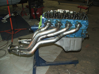

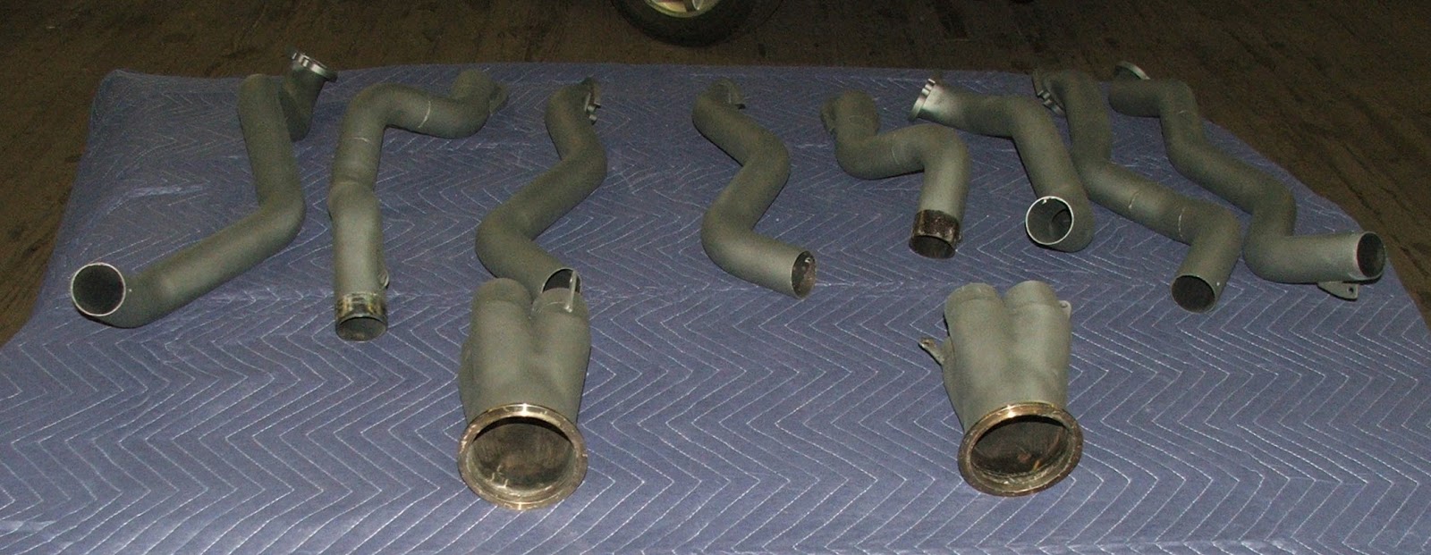

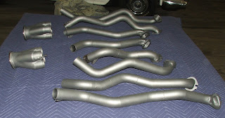

When I got to the dealership Saturday, my 460 headers from Crites Restoration Products had arrived! I pulled them from the box to check them out and then I did a quick assembly on my 460 mounted on the engine stand to see how easily they go together.... I did have to ream the front mounting slot a bit deeper on cylinder #7 but that was the only snafu putting them together. 2" primary with 3 1/2" collectors... can't wait to hear these muthas rumble!!!
** CLICK ON PHOTO TO ENLARGE AND CLICK AGAIN TO SUPERSIZE**
The true test however will be installing them with everything in place (ps steering box, transmission, etc). They are guaranteed to fit, so time will tell.

wow those headers are bigger than your engine! 2" primary tubes? they outta flow! (geez joe, are planning on putting a 671 blower on there???

Look sharp...some big headers. Looks like you have to weld the collector to the tubes.
I would assume you do this once the motor is in place. Or do you just do all this before installing the motor?

No, they are slip fit collectors that you bolt to the tubes once assembled. Double click on the second photo to enlarge the photo large enough to examine all the details....

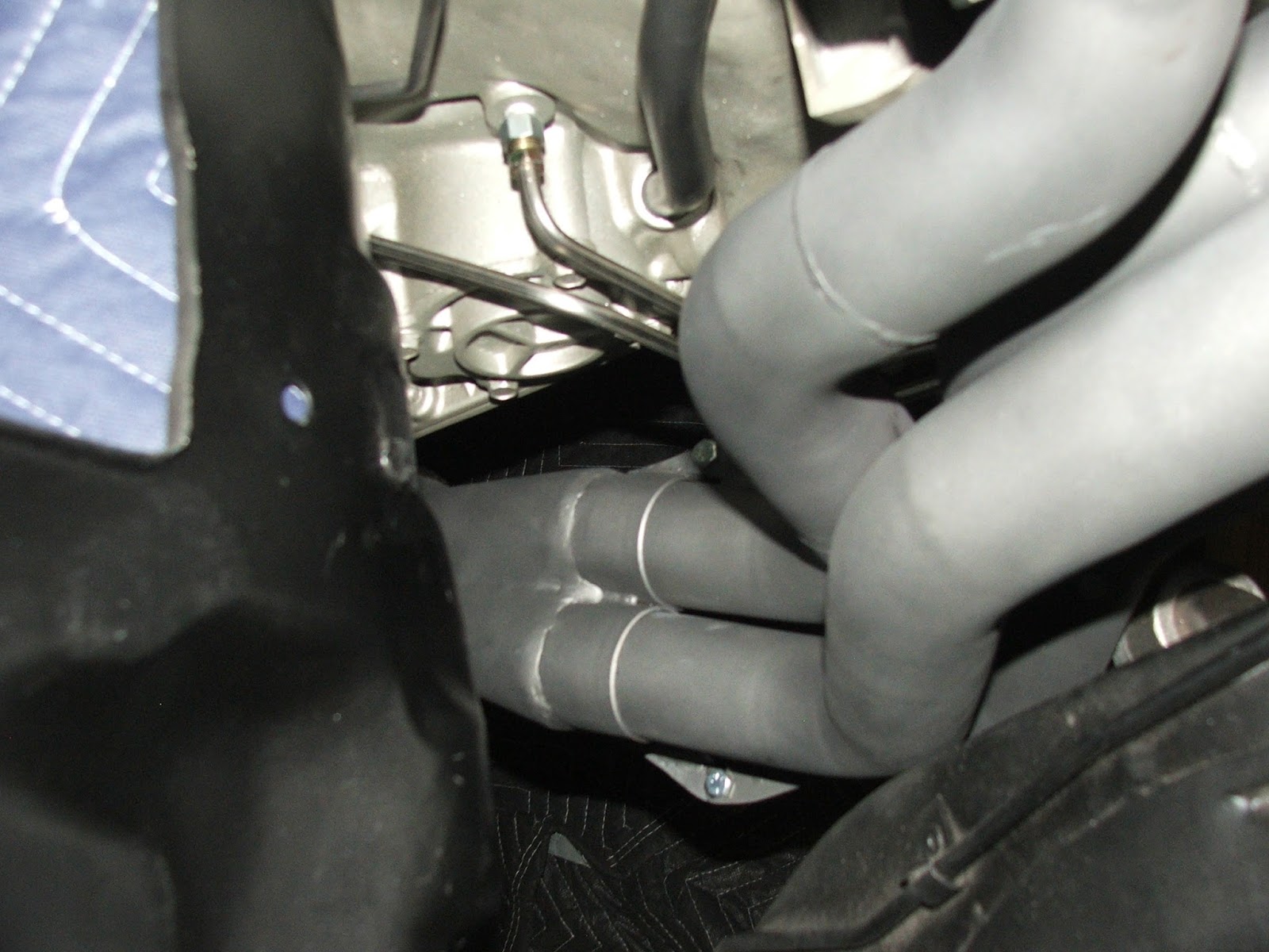

I am concerned about the side that would passenger. Looks like the header comes way out and then in at an angle. Hope you will be able to adjust that out. My hookers hug the engine tight and go up to the reliefs on the trans cross member straight. Worried you will have interference issues with the upper control arm and frame on that side.

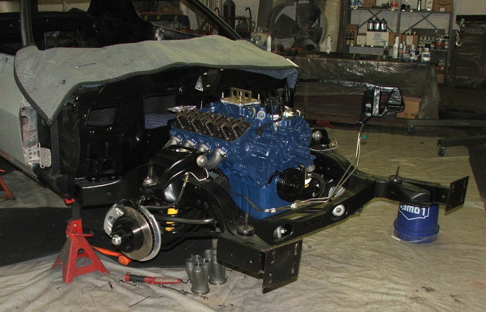

Guys, I'm still a ways off before being able to mock up the motor/chassis/suspension/AC box/transmission/crossmember assembly to check for interferences, but I hope Crites did their homework meticulously!!

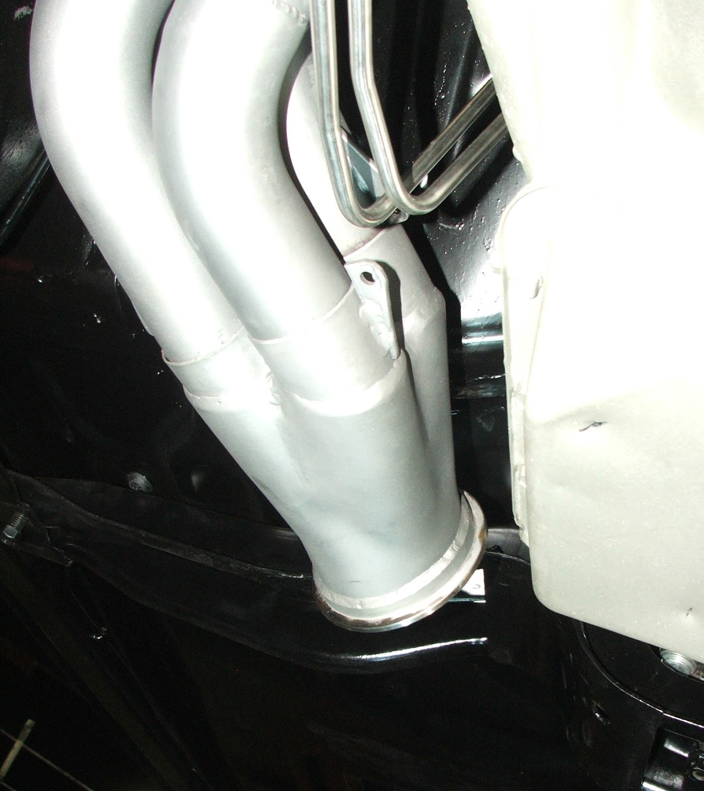

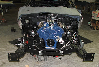

The headers are installed (mock up) and they fit beautifully with OEM mounts! See my project thread (http://forum.grantorinosport.org/project-tv-2m8o_topic7279_page24.html) about 3/4 of the way down and follow along. They clear the AC Evaporator housing on the firewall as well as power steering hoses and steering box... the pitman arm just does touch the tube so I plan on adding a well placed dimple just in case the power assist pushes it a bit more that direction before sending them out for powder coating.
It's pretty congested at the base of the steering column with all the tubes snaking their way thru there, so I can understand why Crites does not recommended them for column shift applications!

The other reason they don't recommend them for column shift cars is that they may melt the shifter cable.
Fixed it. typed too fast. left out the "f" in "Shift" Couldn't figure out why there was an asterisk in the middle of the word. Embarrassed

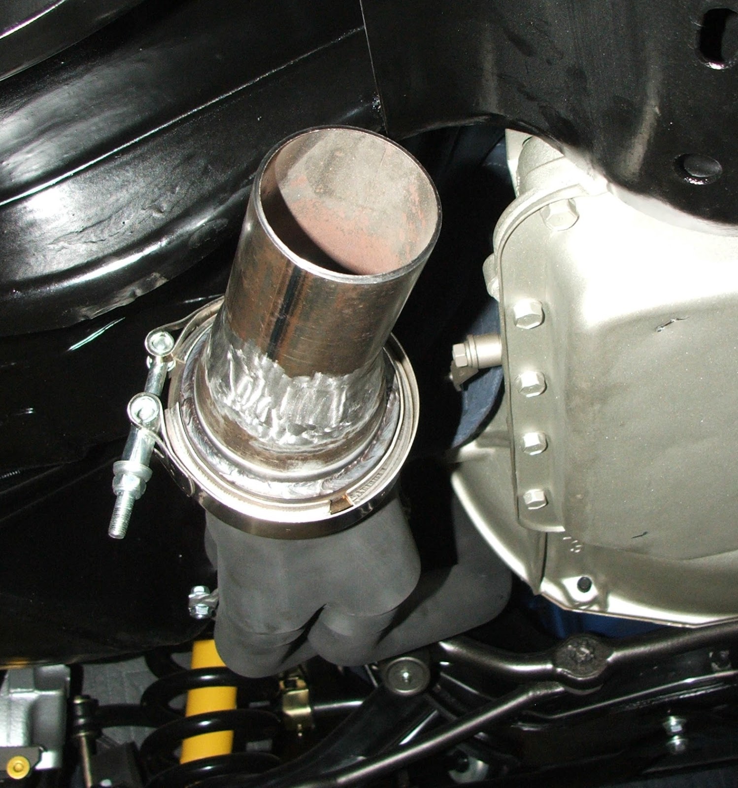

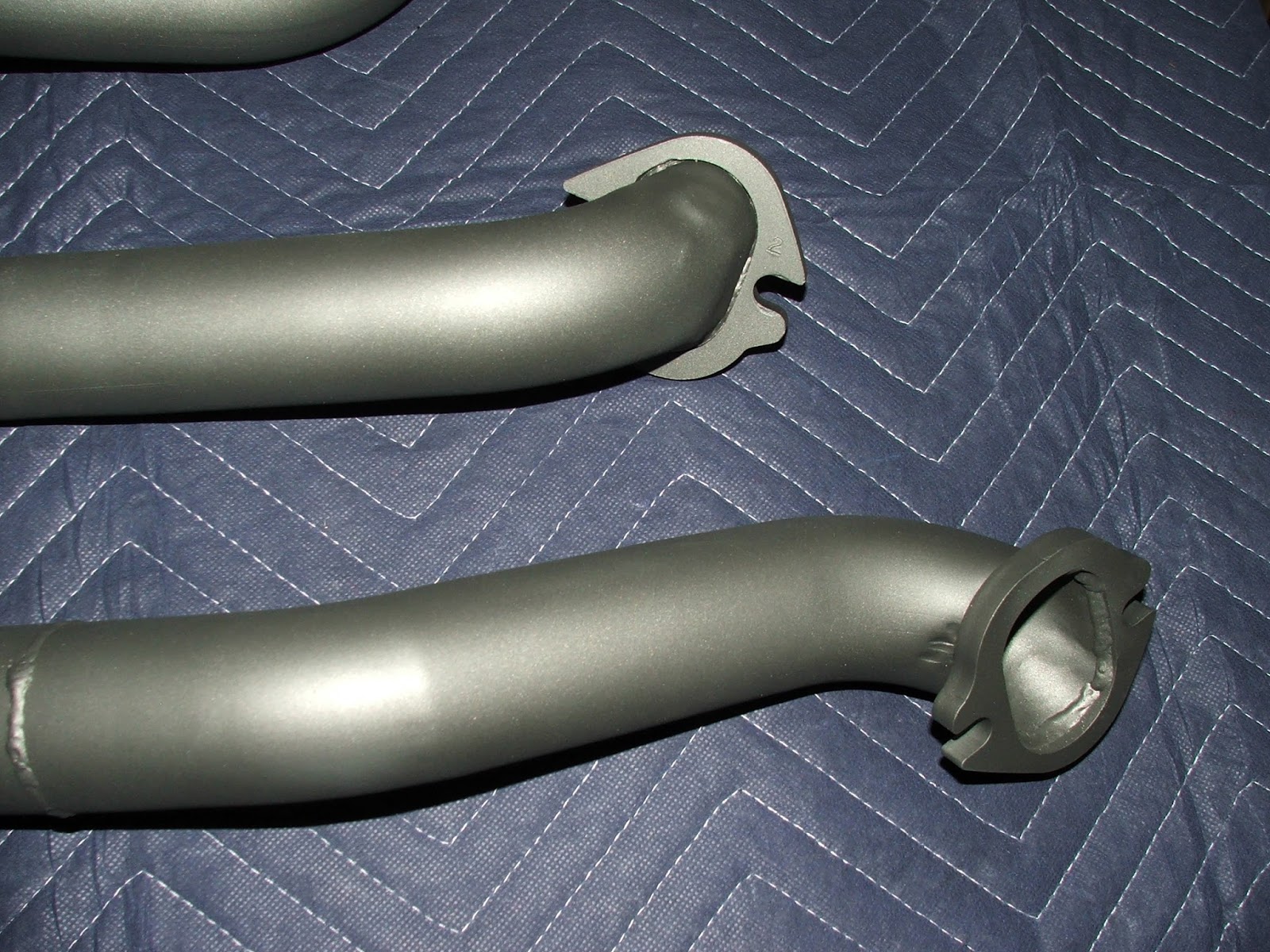

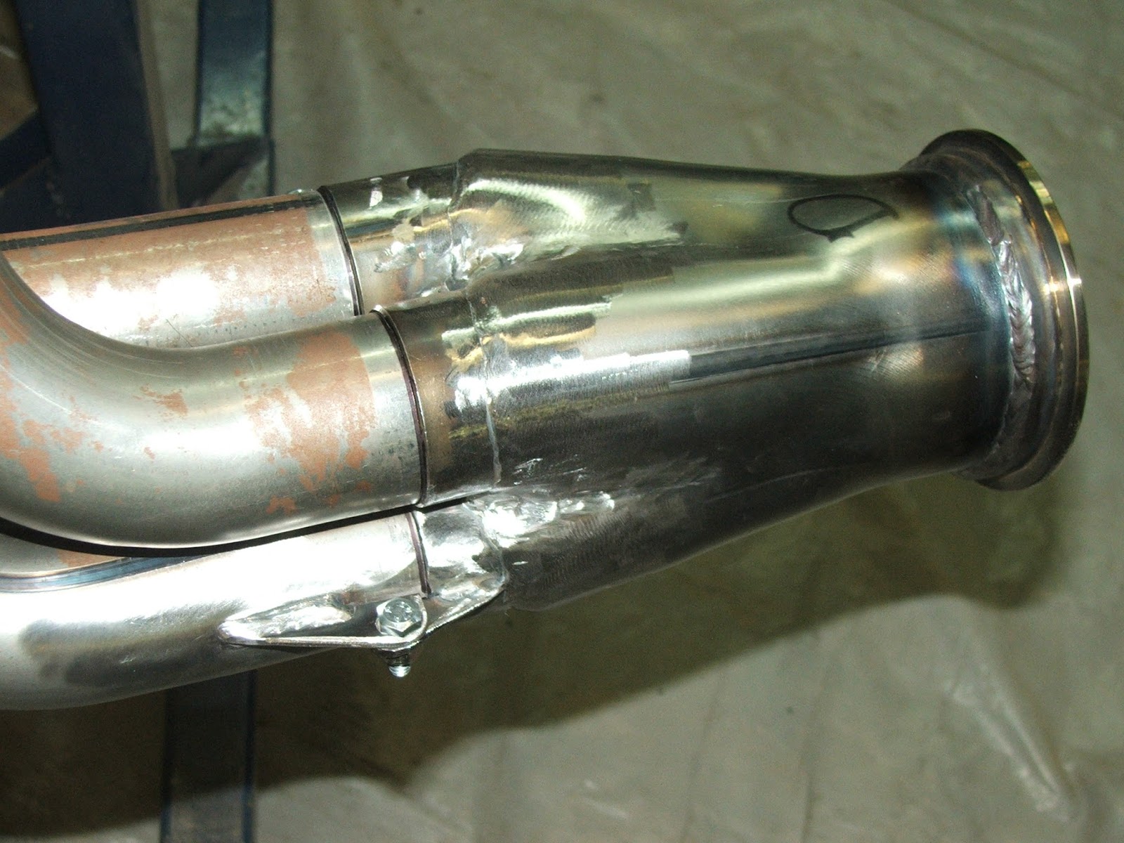

Here are a few pics with the V-band flanges welded to the collectors prior to going out for ceramic coating...........
Edited by TV 2M8O - 28-March-2016 at 6:49AM

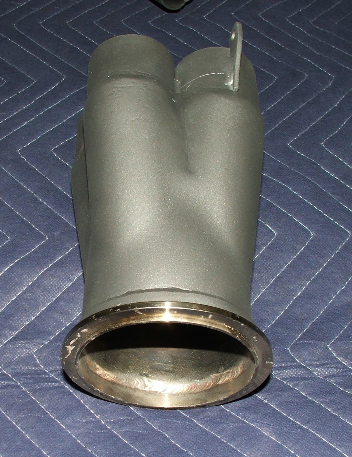

The first of May, I picked up my headers from Kustom Koatings LLC who applied a ceramic coating (titanium color) to them and they really look great!
Edited by TV 2M8O - 25-September-2016 at 7:33AM

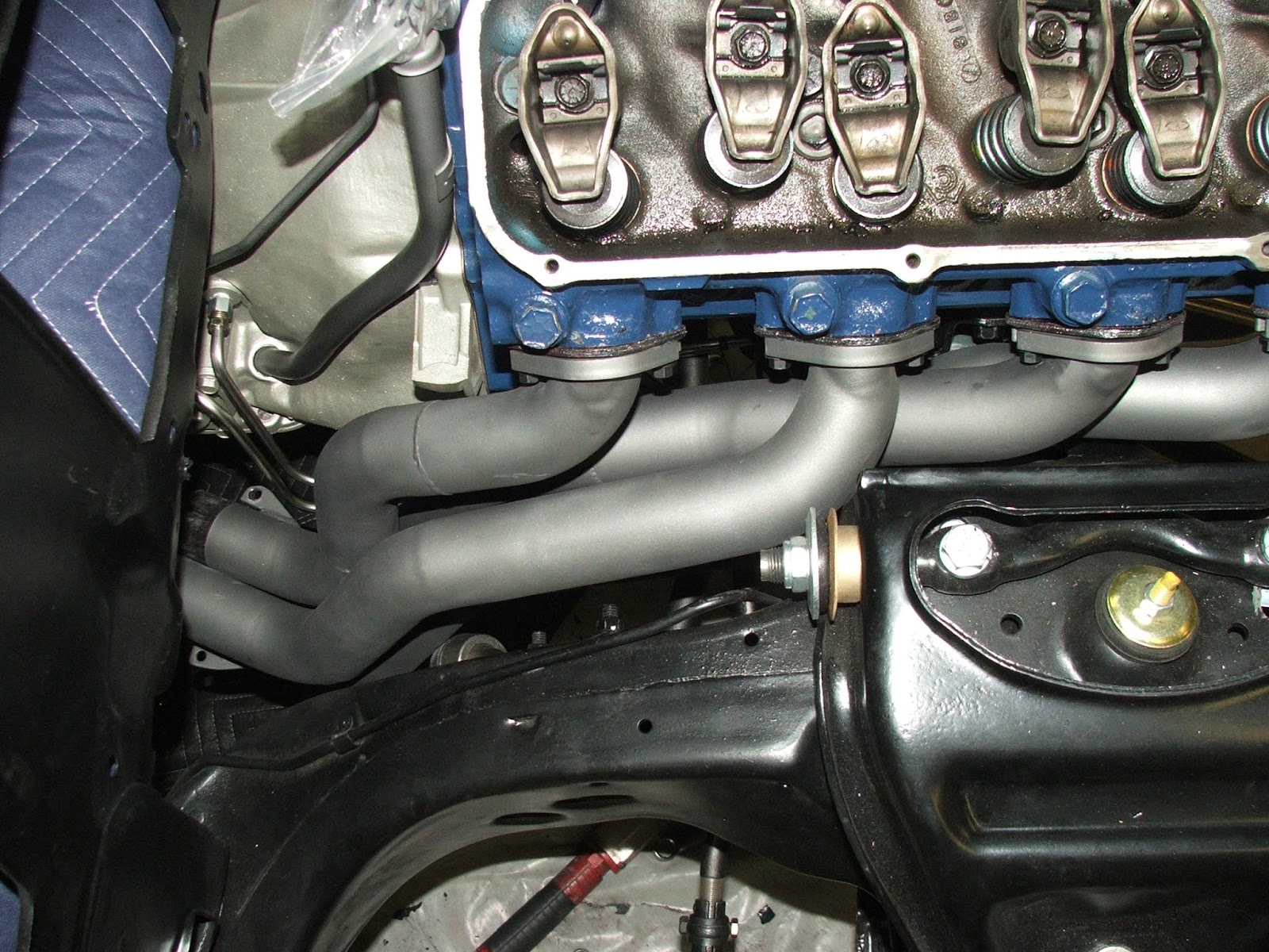

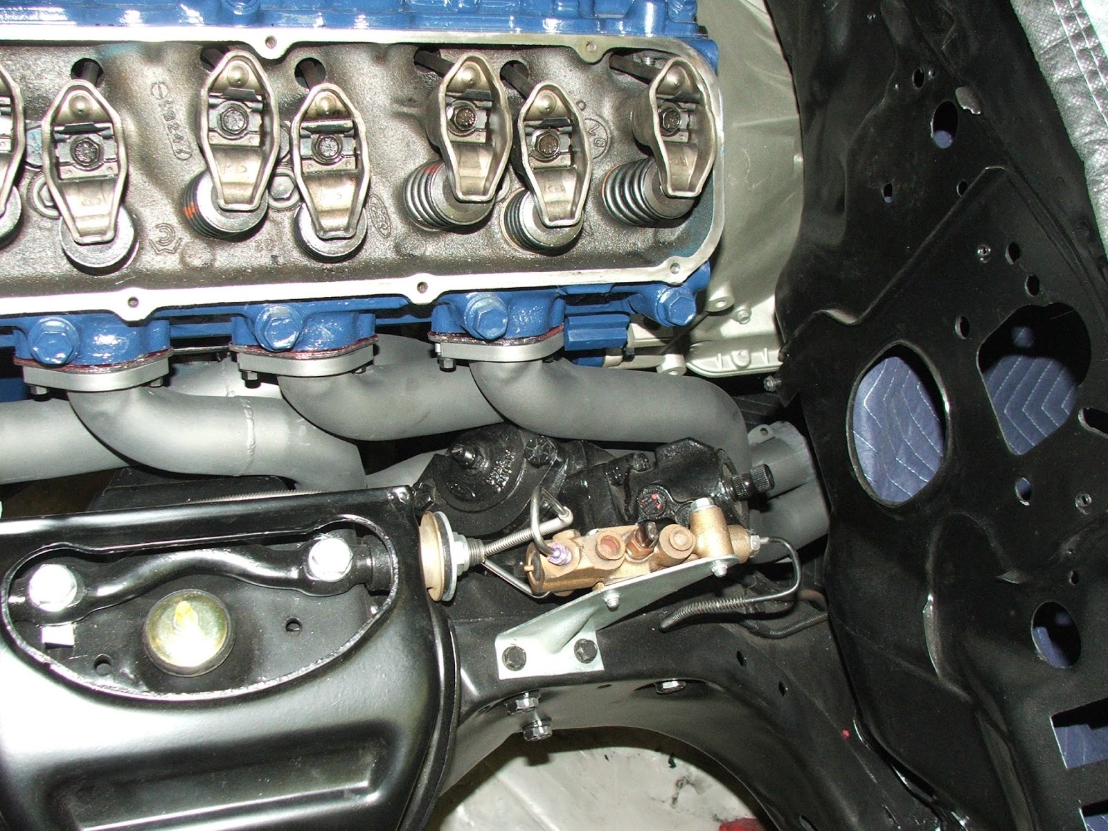

The first of August, I installed the engine mounts onto the block and then set about dry fitting the MT valve covers (still trying to figure out how to spread them to fit correctly), Holley carb and spacer, oil filter and the Crites headers prior to final install in the car.
Edited by TV 2M8O - 25-September-2016 at 7:37AM

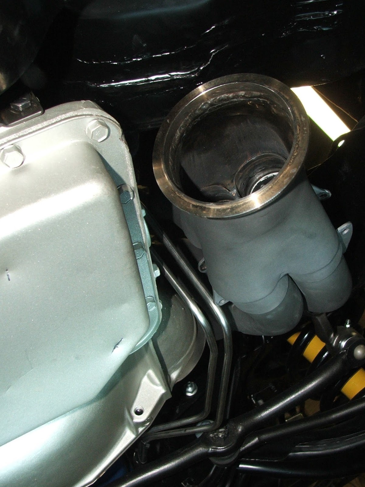

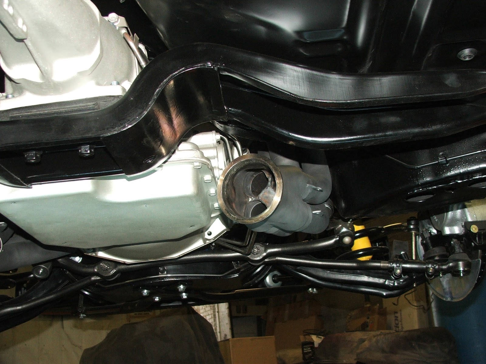

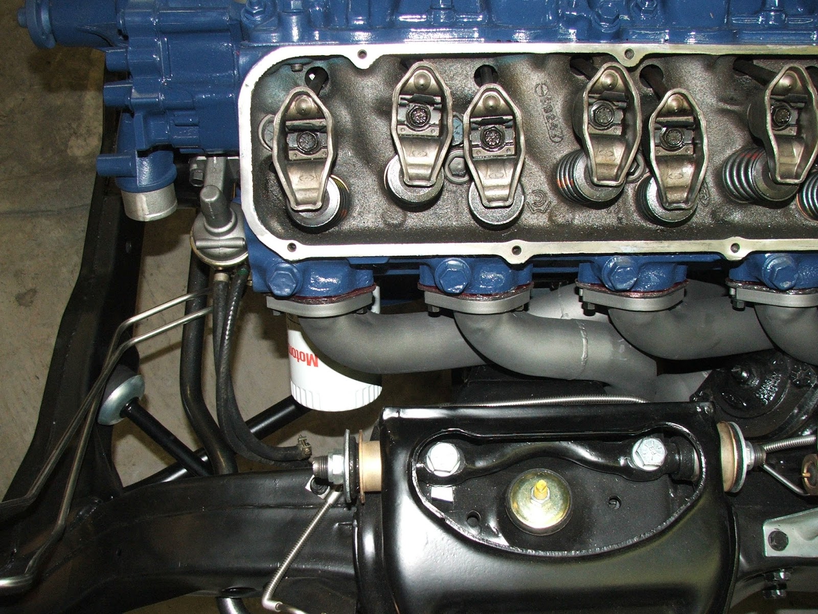

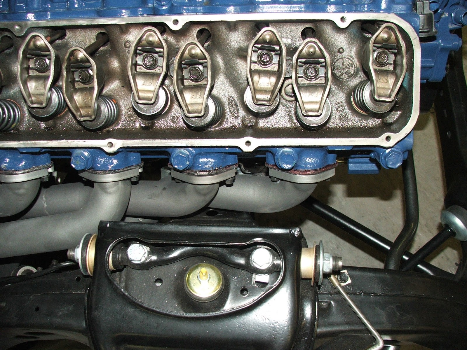

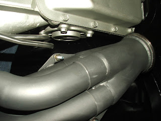

The beginning of September, we got the 460 and C6 in place! Was also able to get the headers reinstalled (and look how tightly they wrap around the steering box!!) but not yet torqued....
Edited by TV 2M8O - 25-September-2016 at 7:56AM
Points: 1692
Post Options Post Options   Thanks (0) Thanks(0)   Quote TV 2M8O Quote  Post ReplyReply Direct Link To This Post Posted: 25-September-2016 at 7:47AM

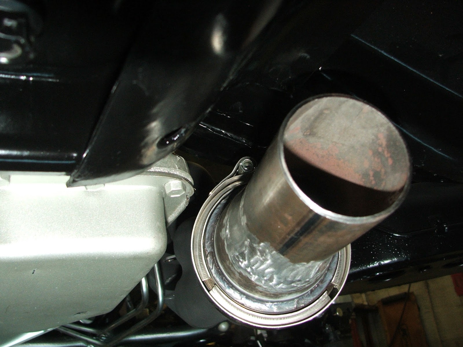

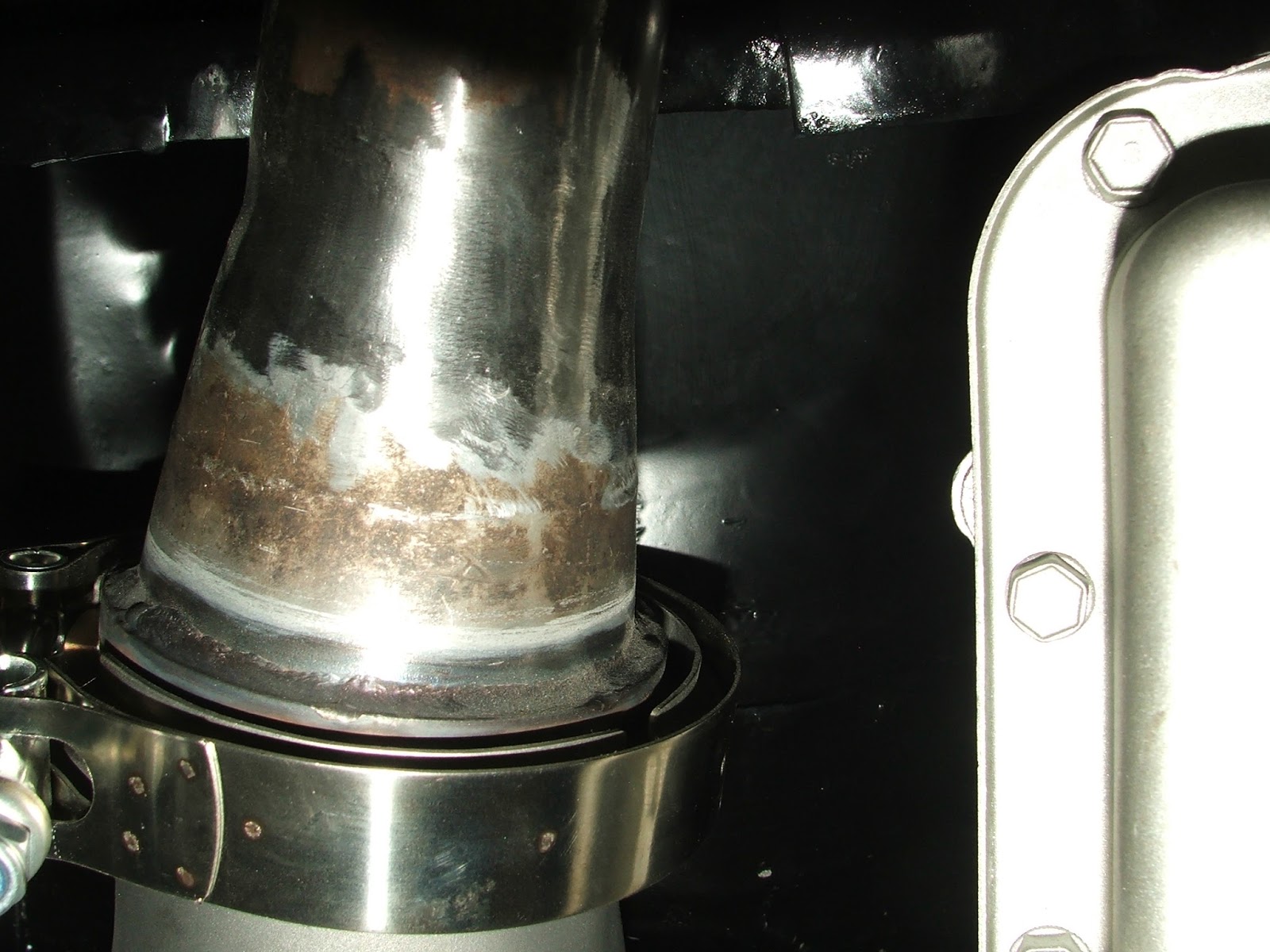

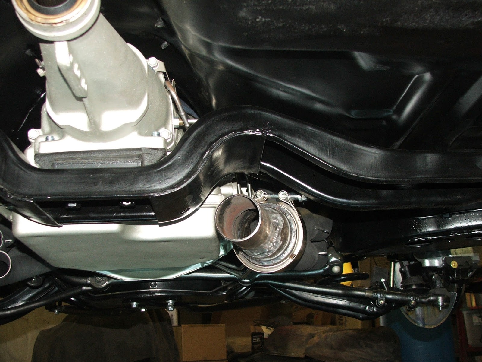

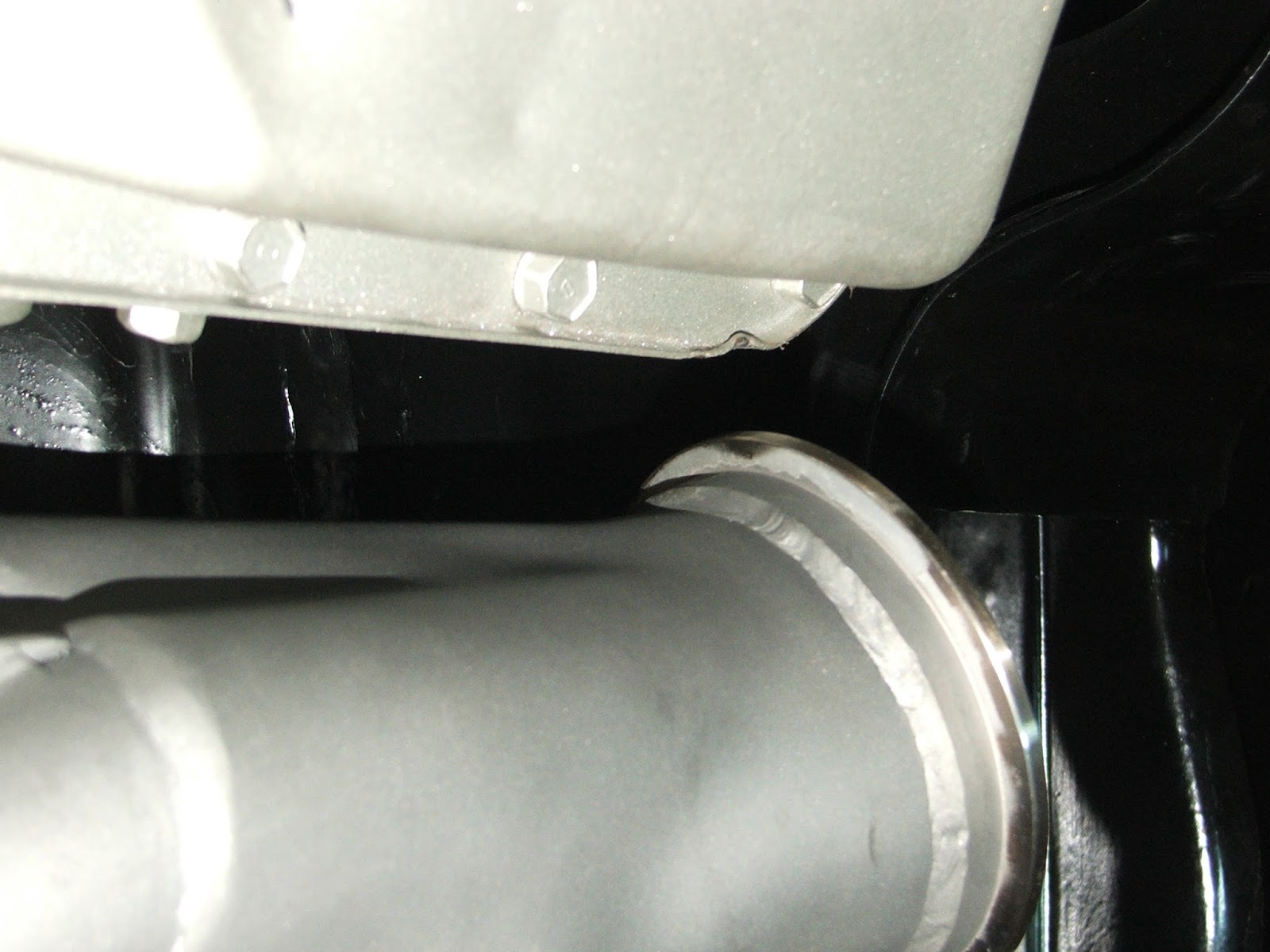

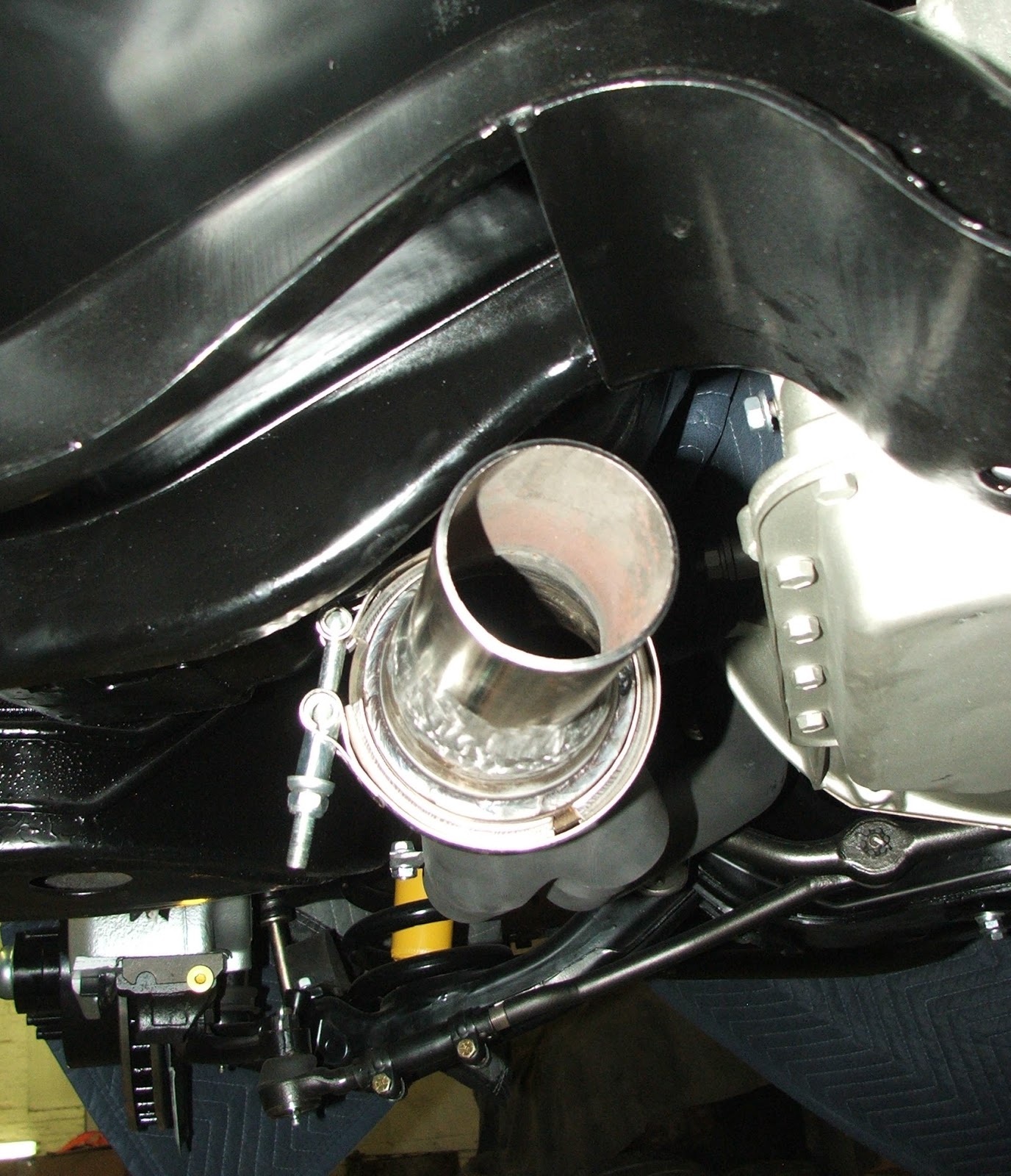

With everything now torqued, the driver side was perfect, but I discovered the passenger side collector was snug against the side of the transmission pan and no way to get the V-band and collector reducer installed. I contacted Crites about making me a collector that breaks 20 degrees at the primary to collector transition to get it off the pan and running back parallel to the driveshaft.
Edited by TV 2M8O - 25-September-2016 at 7:48AM
Points: 1692
Post Options Post Options   Thanks (0) Thanks(0)   Quote TV 2M8O Quote  Post ReplyReply Direct Link To This Post Posted: 25-September-2016 at 7:52AM

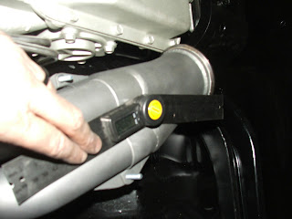

Something I thought of prior to talking with Kenny at Crites was the possibility of swapping the collectors side to side, so the following weekend I set about removing the driver side collector to see if it would work on the passenger side and vise-a-versa. Well the driver side collector fit onto the passenger side once rolled 180 degrees and got the collector off the transmission pan...
but the passenger side collector mounted on the driver side had the same problem as on the passenger side, the collector was right against the pan! I'll have Crites make me another driver side collector, rotate it 180 degrees and then install the tabs in the correct location to mount it on the passenger side and leave off the three hole collector flange. I'll also need to order a new V-band flange to weld to the collector once it arrives and then have it powder coated.
Edited by TV 2M8O - 25-September-2016 at 7:53AM
