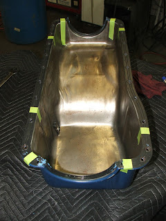

My suspicions were correct.... I must have dry fit the oil pan gasket and pan one weekend and then the following weekend buttoned everything up thinking I was done.... WRONG
Saturday I got the pan dropped, the gasket and corners cleaned and sprayed several times with brake clean to get rid of any oil residue so the RTV and gasket will adhere nicely to the block sealing the corners and then left everything opened up so the cleaner can evaporate away.
Next weekend I'll hit the corners with a good blob of Ultra Seal, reinstall the pan gasket, button up the oil pan and set the engine back down into the frame and reassemble everything removed to allow the engine to be raised.... then I'll be back on track to getting her ready to turn over to the body shop!
Edited by TV 2M8O - 03-July-2018 at 3:38PM
Points: 1880
Post Options Post Options   Thanks (0) Thanks(0)   Quote TV 2M8O Quote  Post ReplyReply Direct Link To This Post Posted: 07-July-2018 at 10:40AM
Well after wasting over an hour trying to position the oil pan gasket onto the engine from below, I finally realized it would be much simpler to remove the pan, stick the gasket onto the pan with a few smears of RTV, then RTV the corners on the engine and the pan and then position the pan onto the motor, so I pulled the front sway bar off and got the pan out and prepped for the install next weekend.
