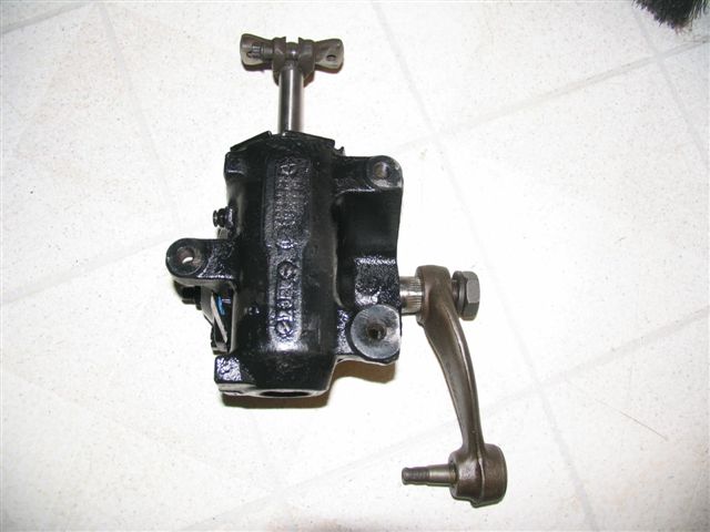

After reading the subsequent postings, I went through my folder to check and make sure I had my facts in order.
The invoice from Lee MFG caught me off a little bit bacause it is dated 11/14/2006, and it was for $470.00 not $400.00.
I attached a couple pictures of the invoice, and of the box below.
To answer the specific questions:
1) Yes, you can absolutely buy and put the quick ratio GM components in the Saginaw Ford housing and make a quick ratio box. I do not rember what the exact steering ratio is with these components installed though.  I would need to look that up again, but I am just about positive it is not 12.7:1.
2) No it is not a ford box. The invoice shows that it is a  "Saginaw/Ford Housing", and it has the "Saginaw script S in the box" logo between the lower mounting bosses.
3) My application is going to use a small circle track style pump, which means I can't get my hose at the parts store by any application for the parts counter guy, but if I were using the stock pump then yes, no problem there.
Lastly, I believe it was going to that ratio that changed the input shaft diameter to 3/4 36 spline, but I would need to check that again to be positive on that too.

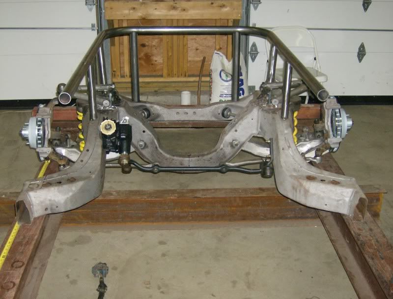

JimW View Drop Down
Joined: 09-December-2003
Points: 604
Post Options Post Options   Thanks (0) Thanks(0)   Quote JimW Quote  Post ReplyReply Direct Link To This Post Posted: 09-April-2010 at 5:09AM
What upper control arms are those?
Jim

Post Options Post Options   Thanks (0) Thanks(0)   Quote Eliteman76 Quote  Post ReplyReply Direct Link To This Post Posted: 09-April-2010 at 5:57AM
Nice front clip Mike...too bad my Nascar wheels wouldn't work for ya.

Post Options Post Options   Thanks (0) Thanks(0)   Quote Regul8r Quote  Post ReplyReply Direct Link To This Post Posted: 10-April-2010 at 5:09AM
I would like to see more of that front clip.
Looks like those UCA's are custom built?

mtburger View Drop Down
Joined: 24-November-2008
Location: Abington, MA
Points: 355
Post Options Post Options   Thanks (0) Thanks(0)   Quote mtburger Quote  Post ReplyReply Direct Link To This Post Posted: 10-April-2010 at 11:53AM
Yes, they are fabricated. the lowers have a bunch of work done to them also.
I will start another thread on my Montego GT instead of hijack this one.

Have you checked is this Borgeson steering gear. What they meaned when you look their sales catalog information?
They inform: Gear fit up to -71, but why they inform it will fit to Gran Torino?
GT's start -72... and maybe -72 gear is similar than -71 and older? I don't know, but somebody who know, could you please help us to know.
If this Borgeson gear bolt holes/dimensions/design fit straight to -72 GT this could be good possibility because gear is Saginaw and this gear you can get also in fast ratio.
