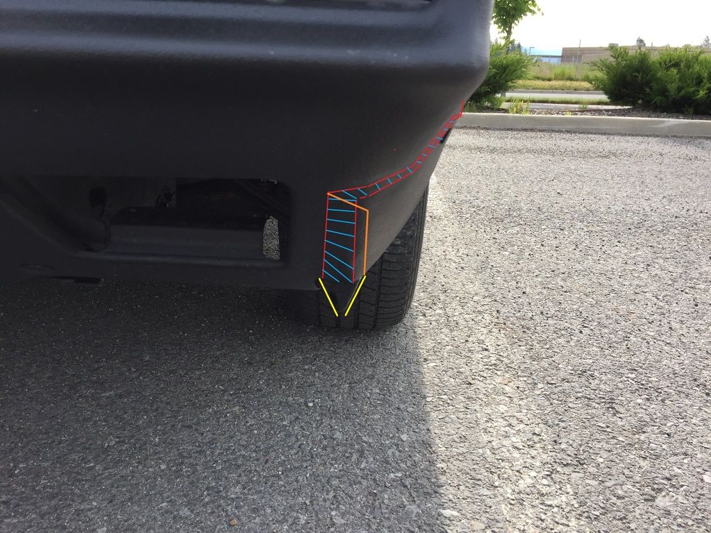

this is where i cut the bumper i made sure that i did not cut right on the corners  but right next to it to keep the body lines correct you have to use a dolly to mold the metal then fill in whats missing i suggest grabbing another bumper to cut metal off of  and make sure its the same thickness. i still want to make another cut and bend the bumper down to the bottom of the fender.

want to cut where the orange line is and bend and adapt it to meet the yellow lines
