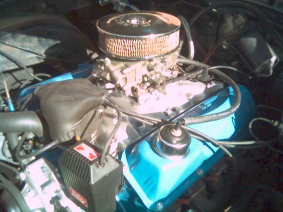

I've seen quite a few OMG installs, one the owner claimed was a Pertronix complete dizzy but I couldn't confirm. he may've been sold an ebay special & paid for a Pertronix? it would only ALMOST fit in one spot, then the intake & dizzy housing had to both be ground on for clearance to let it sit down into place... in this car, 36 Dodge with a 351C-2V / FMX / 9" from a 73 Mustang IIRC. note the Windosr T-stat housing, this guy's mechanic was a real Wizard
here it is

too bad, that's a sweet lookin' coupe
