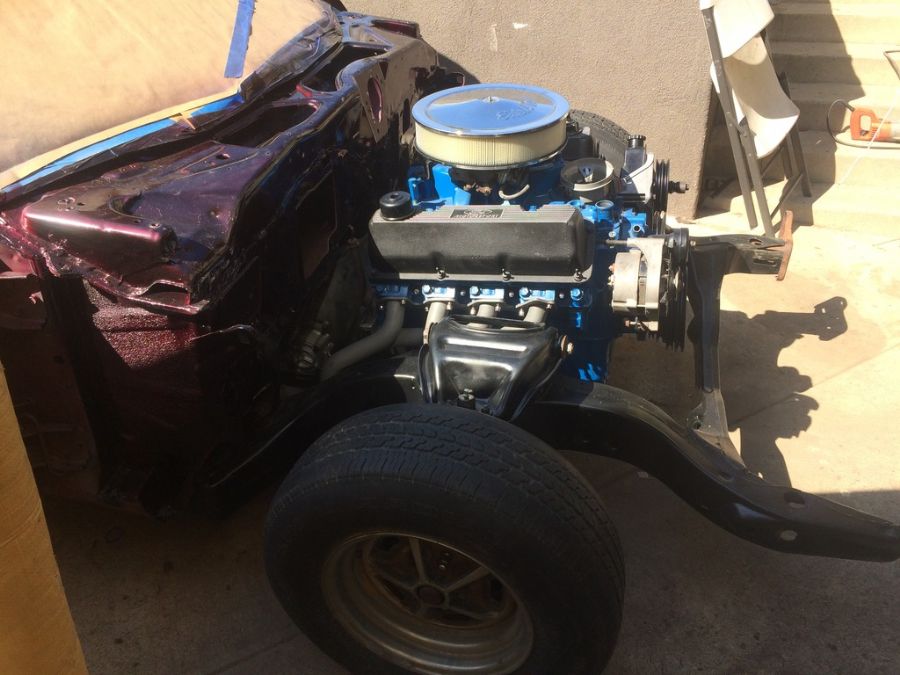

Post Options Post Options   Thanks (1) Thanks(1)   Quote The Torino Kid Quote  Post ReplyReply Direct Link To This Post Posted: 07-July-2018 at 4:59PM
Super Comps that came with the GTS.
1973 Gran Torino Sport CJ 351
'Q' code 63R body
The Torino Kid View Drop Down
Joined: 23-November-2003
Points: 187
Post Options Post Options   Thanks (1) Thanks(1)   Quote The Torino Kid Quote  Post ReplyReply Direct Link To This Post Posted: 07-July-2018 at 4:58PM
its a snug fit on the drivers side.
'Q' code 63R body
Points: 187
Post Options Post Options   Thanks (1) Thanks(1)   Quote The Torino Kid Quote  Post ReplyReply Direct Link To This Post Posted: 07-July-2018 at 4:57PM
Sorry about the delay....tbh I completely forgot. Embarrassed
'Q' code 63R body
Points: 2863
Post Options Post Options   Thanks (0) Thanks(0)   Quote 72FordGTS Quote  Post ReplyReply Direct Link To This Post Posted: 14-May-2018 at 2:31AM
Other than finding a vintage set of headers, I think you are limited to what I posted above.  Now that I have the front clip off my car, I 99% sure am going with the Super Comps for my 400.  I am probably going to break the bank and get the ceramic coated headers too, since I want them to last.
Here is a member who installed them on a Ford 400 and he claims they fit okay.  Some other searches show that they are tight fit but work okay too.
Here is the original thread (you need the photo bucket fix to see the pics):
Here's another thread talking about them:
