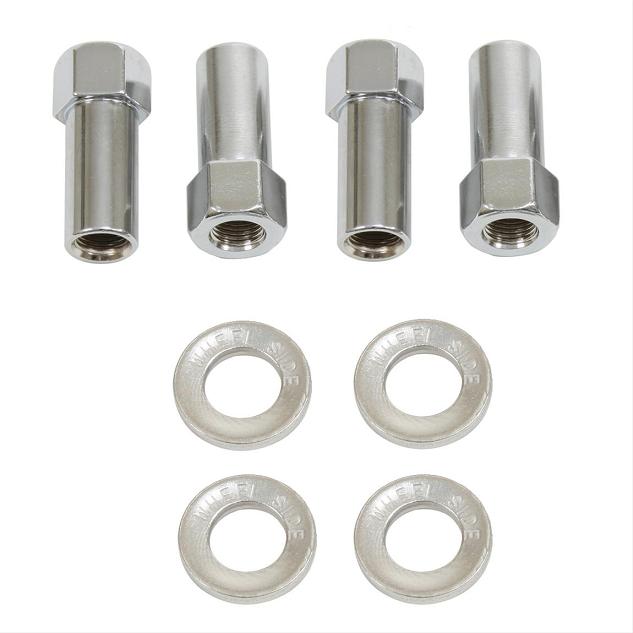

Some shank style lug nuts have washers with an offset hole in them, this is to center the wheel onto the lug nuts.
dave302 View Drop Down
Joined: 08-October-2009
Location: usa
Points: 3171
Post Options Post Options   Thanks (0) Thanks(0)   Quote dave302 Quote  Post ReplyReply Direct Link To This Post Posted: 06-September-2014 at 5:38PM
Some shank style lug nuts use washers with a centered hole in the middle. Like in the picture below. The washers are used to keep the wheel centered while you are tightening the lug nuts.

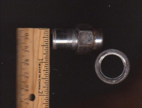

You will have to measure the width of the lug nut holes on your wheels, so you will know which lug nut size that you need.

You will also need to measure the depth of the lug nut holes on your wheels. So you can get the correct length shank lug nuts.
Also notice the shank inside depth of the lug nuts in the picture below, so these conditions don't occur:

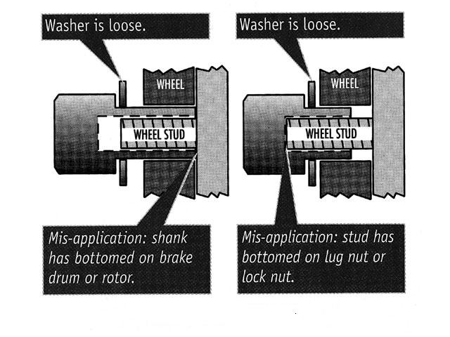

You should also measure how long your lugs are at the front brake rotors (or front brake drums), and you should probably measure how long the lugs are at the rear brake drums. It might be better to measure them with the wheels off of the car.
This will help you figure out what size shank lug nuts that you need to get. If you cannot find them, then you can post all of the measurements here. And i will try to find them.
It will probably be good if you also measure the size of the recesses/indentations in the wheel where the washers go into. This will help you choose the correct size of the outer diameter of the washers.
