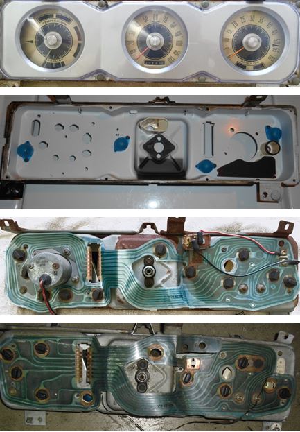

Post Options Post Options   Thanks (1) Thanks(1)   Quote schufitz Quote  Post ReplyReply Direct Link To This Post Posted: 01-November-2023 at 4:45AM
Your best bet to make the addition is to acquire a complete cluster from a tach optioned car. They show up on e-bay now and then and there's actually a '68 tach cluster listed now.  To add the tach, you need the cluster housing with a hole in it for the tach body to stick through as well as a different printed circuit board.  The oil & alt lights are moved to the bottom of tach vs. top & bottom on non-tach 3rd pod (repro circuits are available). You could probably modify existing cluster with large hole.  I was able to get a complete cluster when I added one to my '69 a few years back. You will also need the harness from the tach body to the coil (repro's are available) or you can have the tach re-wired to a 3-wire set up for more reliability (I did that). It also uses a different voltage regulator. It gets pricey once adding everything up, so best to find a complete tach cluster.

Excellent post Dave, well said and complete.
