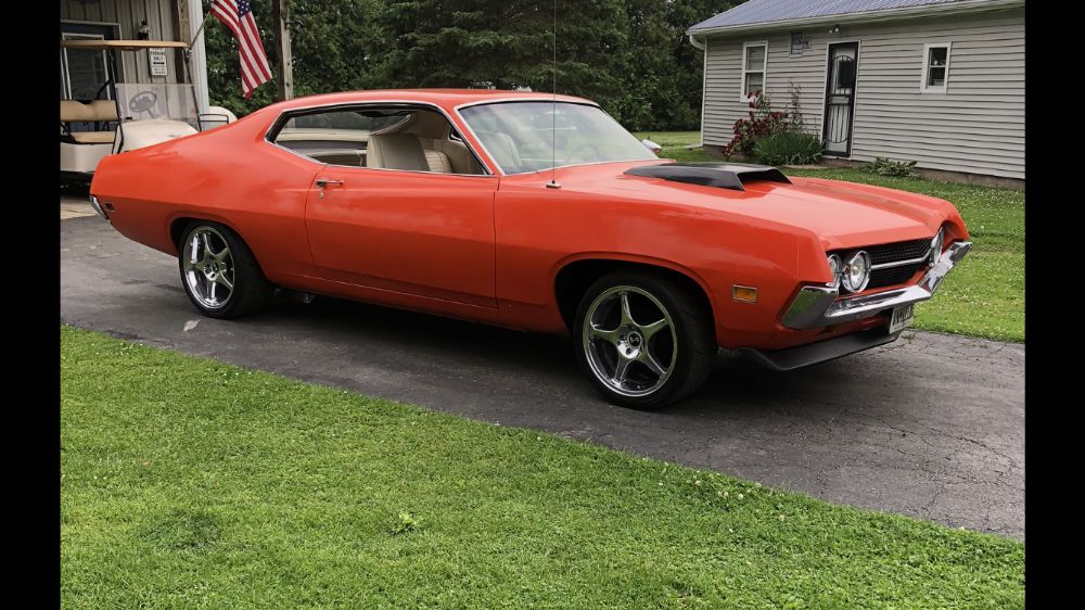

Post Options Post Options   Thanks (0) Thanks(0)   Quote 72FordGTS Quote  Post ReplyReply Direct Link To This Post Posted: 15-June-2025 at 2:04AM
Very nice!  Which wheels are you running, these or the slots in the other pic you posted?
What is under the hood? Any other details about the car?

Hello Vince
I just recently put these 18" "Mustang Terminator" style wheels on because I got a killer deal and I knew that you could fit a lot of rubber under these cars stock. I had to put 1" spacers on front and 3/4" on rear to fit right but im still letting it grow on me a bit. There is 11" of rubber each side touching pavement in the rear with room to spare so it looks pretty cool in that aspect. It has a pretty nasty cammed and compression version of its stock 302 block with a Toploader. I have a 408 close to being done but now I know with all the rubber touching pavement that the 8" (or toploader) is sure to go once thats in. I consider myself blessed to own my dream car (even without the Cobra Vin.) and would have loved to put a Cleveland in it one day but the 408W from one of my other projects will make a good fit. Thank You for noticing and asking about my ride sir! Yours is beautiful

Post Options Post Options   Thanks (0) Thanks(0)   Quote 72 RS 351 Quote  Post ReplyReply Direct Link To This Post Posted: 17-June-2025 at 10:23AM
Very nice Tom, a 408 will move it very well. What heads and intake does that 408 have, I hope they are big enough? I'd envision heads with 220cc ports or more, 300cfm if possible.
I'm not a manual guy so I would think of what trans to use for that. An automatic will be more driveable when the power and rpm gets wilder, I'd dream of a 4R70W, or a 6R80 if you really like lots of shifts.

Post Options Post Options   Thanks (0) Thanks(0)   Quote VNMIZED70 Quote  Post ReplyReply Direct Link To This Post Posted: 18-June-2025 at 6:12AM
Hi Vince,
The 408 has AFR 205's, and as of now I just have an old weiand stealth dual plane that I probably wont end up using. Funny story, I just put one of those cheapy ebay single plane jobbies on my 302 in the car now from having a stock cast 4bbl and it changed into beast mode. Ive got my heart set on a TKO trans someday when I get big.
