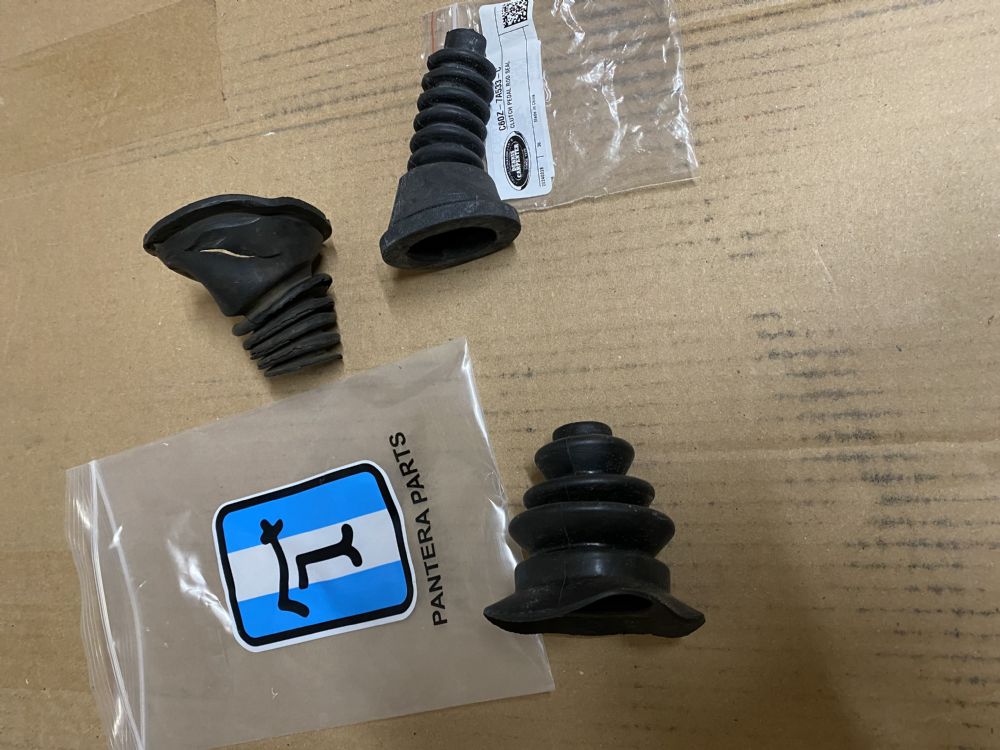

Post Options Post Options   Thanks (0) Thanks(0)   Quote SunsetSeizin73 Quote  Post ReplyReply Direct Link To This Post Posted: 07-June-2025 at 6:01PM
I think I found an option for this issue.
Working on my 73, factory 4 speed with a ton of holes in mine bc of a car audio spot in high school ran wires through it.
I’ve been lost on Pantera websites with the 351C relation and stumbled on the a firewall boot that’s the same 2.5 entry and similar length and shape as we need.  It doesn’t have the ridge that the original it’s going to work better than the original.
I’m not at the point of install, but looks like it’ll fit the bill
Pantera’s by Wilkinson has it available in their website
Part #: 06013A - Boot Shift Rod at Firewall
In photo is the original, Pantera part number and the available mustang part that is too small.
Thanks,
Matt
To the unplugged yet connected
1973 Gran Torino Sport
351 4V, Q code, 4spd, 3.50 open diff
