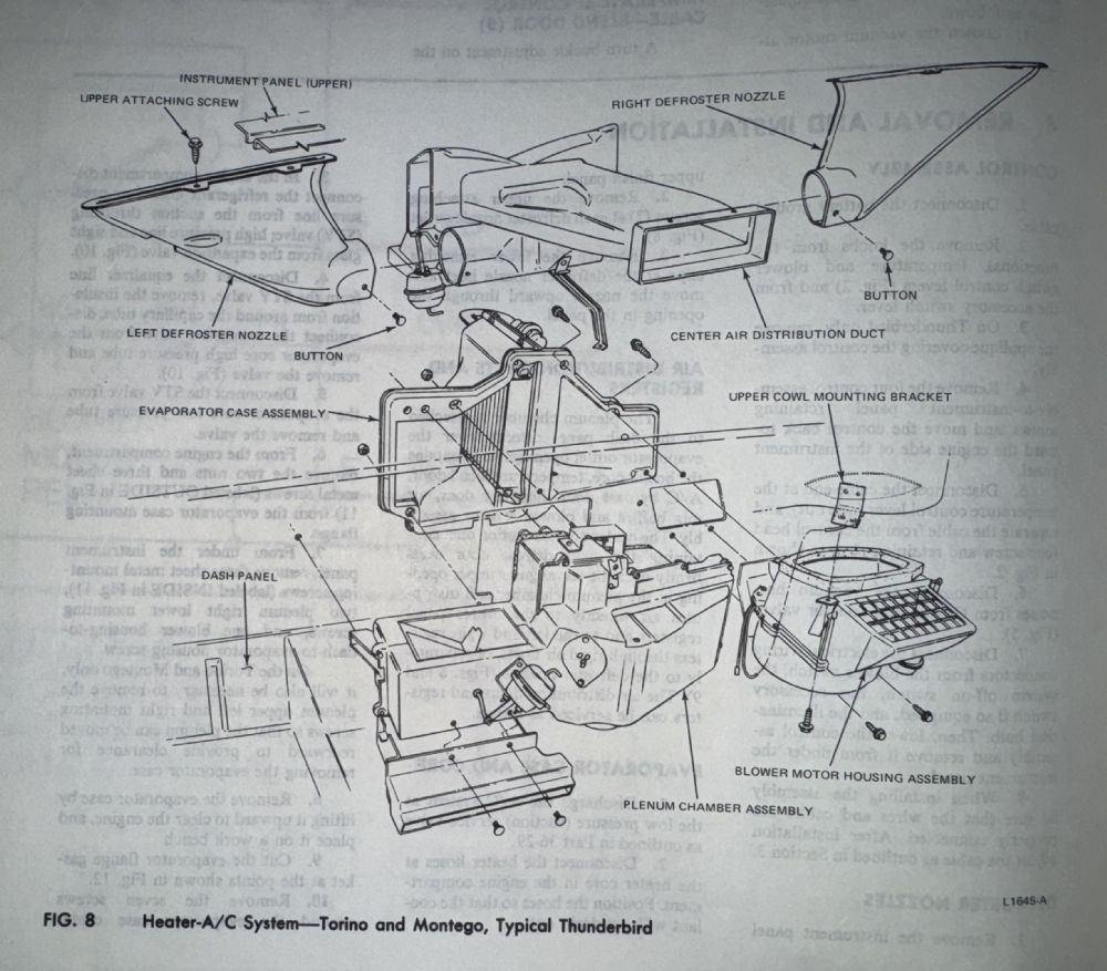

The upper defroster ductwork depends on the AC vs non-AC.
I'm fuzzy on heat-only cars, but it is a single piece that sits on top of the main box section.
Now, for AC cars, there are left (Driver) and right (Passenger) side ducts.
I had some issues when I was searching the manuals. Hope this helps.
On these, pretty much any of the 72-76 Torino, Montego, Ranchero, Elite & Mercury Cougar 74-76 will work.
77-79 Mercury Cougar, Ford Thunderbird, Ford LTD 2, and Ranchero I believe changed the HVAC system, but I can't confirm 100%.
Decided to look at my '77 service manual set and the heat only upper defrost looks different. On the AC dash, looks like they made the 77-79 AC cars also have a 1 piece upper design.
Sometimes you can use 77-79 dash /electrical but not in this case.

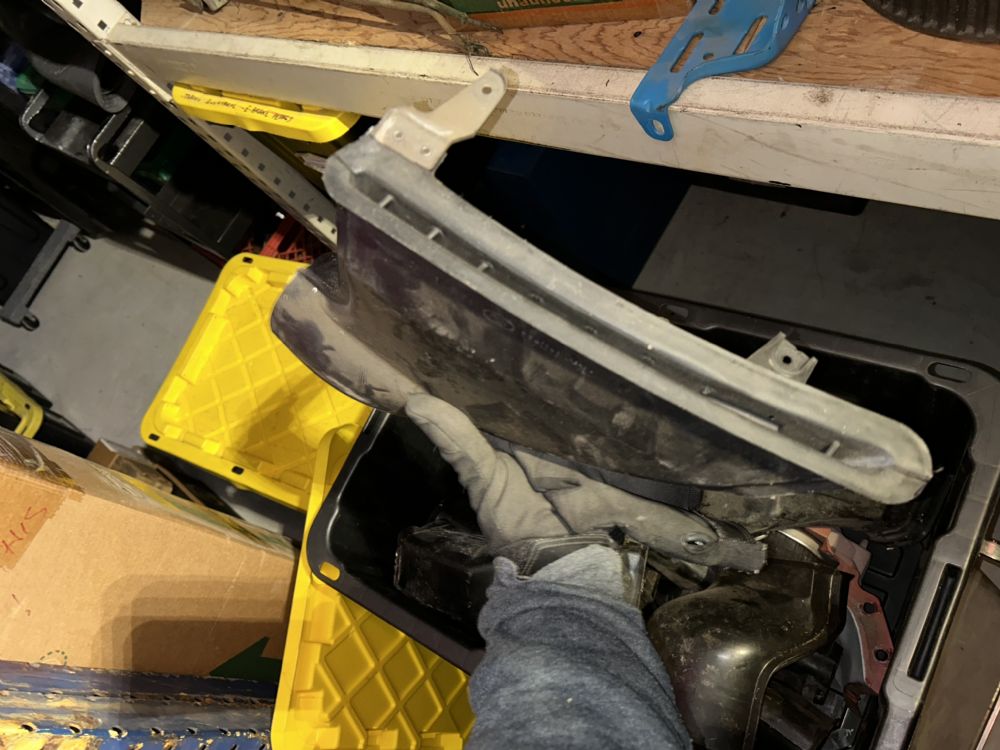

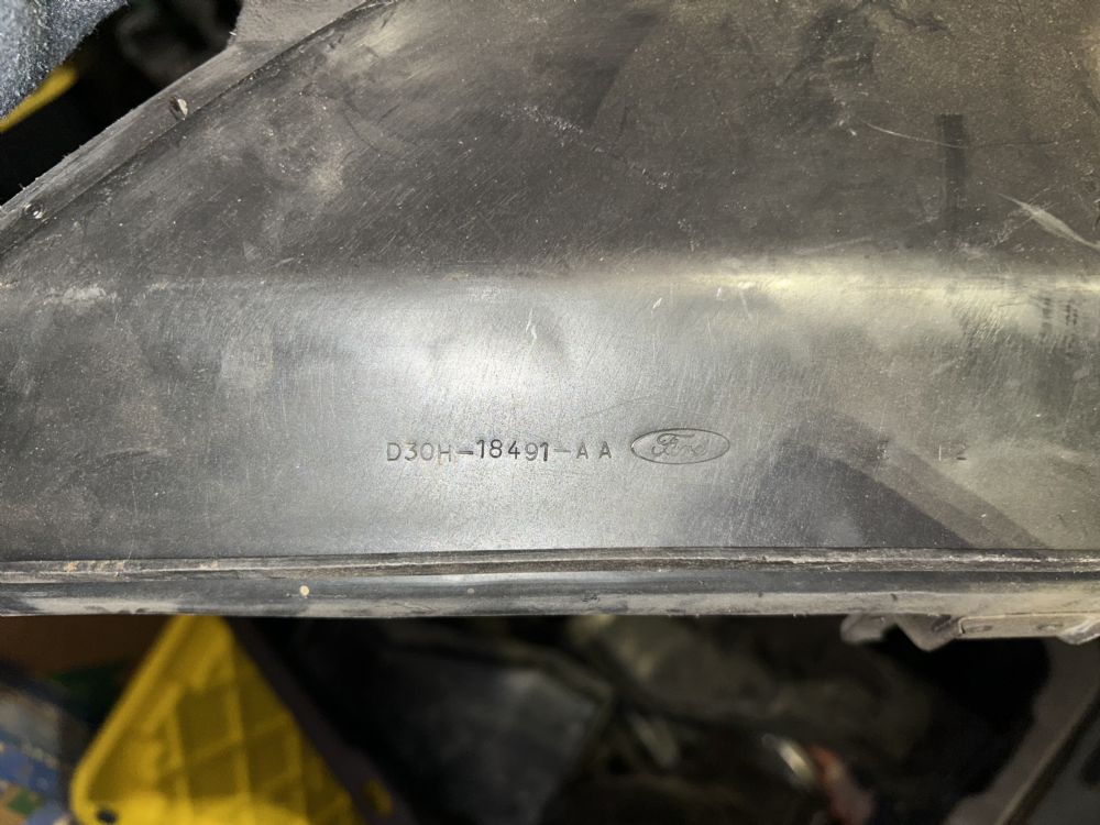

I picked up a parts group recently and found in the mix, EDIT - looks like Driver's side defroster ductwork for an AC car. it's a '73 part number, D3, but should work.
Let me know if interested.
$25 plus the shipping.
