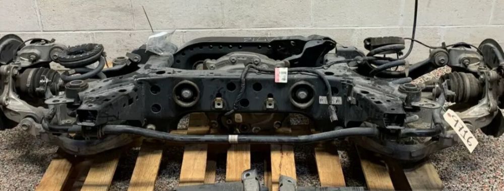

S550 IRS, i look at it as a bolt in capable fully contained diff upgrade with 34-spline super 8.8 and torsen limited slip.
handling upgrade with multilink suspension.
brake upgrade with modern disc brakes and built in e-brake.
thats all cheaper then doing up my 9” , not to even count the 4-link as well as the brake upgrade im getting too. which was gonna have me back half the chassis anyways.
1972 Ranchero
CTSV LSA with 6l90E 6-speed
2017 S550 3.73 Torsen IRS
Crown Vic IFS
Focal SQ 10 speaker system
