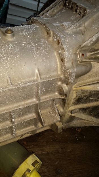

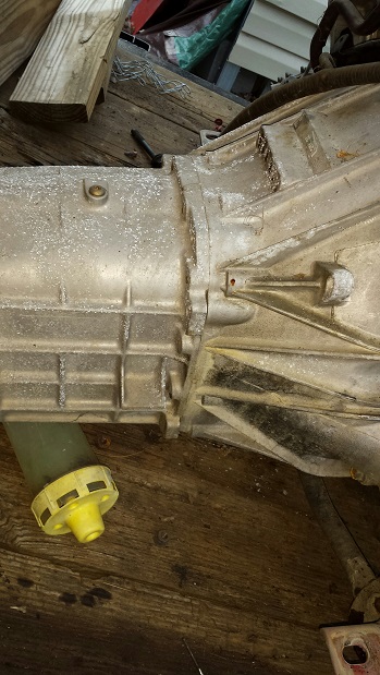

Well, I dropped the drivetrain out of the Mustang last night and found that the transmission does have a separate bellhousing. Surprise. I need to research bellhousings now for the additional T45 I have in the batch of extra parts.

If you take that bell housing off, the front gears will fall out. It is part of the trans. N
o one makes one for different engines.Edited by madmaxtorino - 14-March-2014 at 10:58AM |
