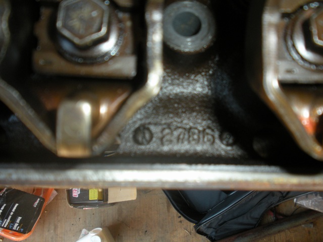

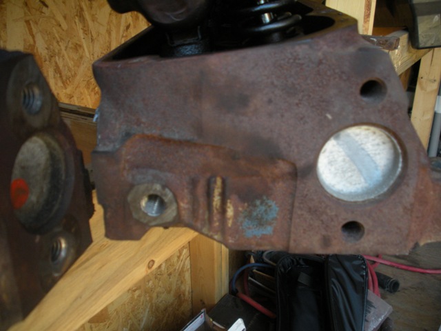

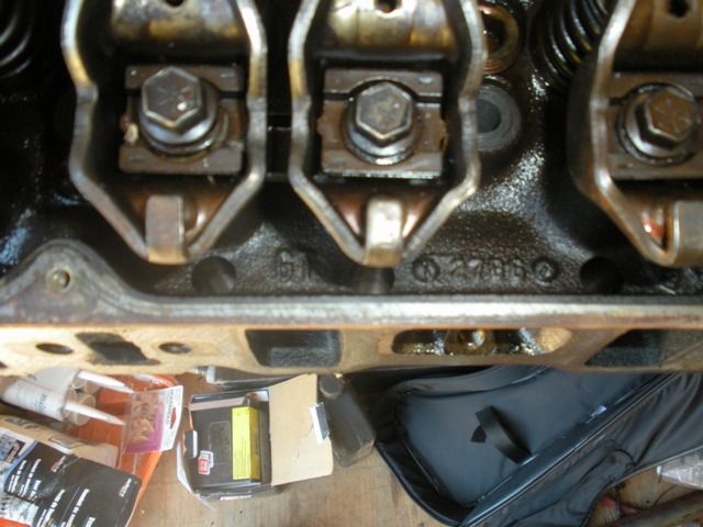

Checked the castings...
1993 Casting numbers, and GT castings on them.
Also has the number 70 Cast on them in numerous areas??
3 lines on front of heads
So that makes them GT40.
They were on a 5/96 Ford Explorer 2WD.
They look in good condition.
The headers are definately those dang funky looking GT40P Explorer pipes.
Some of the piping comes out and goes UP then back down with heat shielding on them.
Took pics, will post later.
Post Options Post Options   Thanks (0) Thanks(0)   Quote Regul8r Quote  Post ReplyReply Direct Link To This Post Posted: 24-August-2010 at 12:55PM
Pics of the heads...
Any solid info on these or is what was posted correct?
They will obviously flow better than the stock 351W stuff.
Just need to compare the CC to check final compression ratio.
ilyes View Drop Down
Joined: 09-January-2010
Location: Philadelphia PA
Points: 3782
Post Options Post Options   Thanks (0) Thanks(0)   Quote ilyes Quote  Post ReplyReply Direct Link To This Post Posted: 24-August-2010 at 1:20PM
gt40 heads for sure

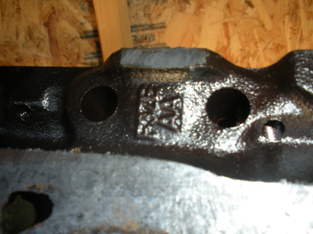

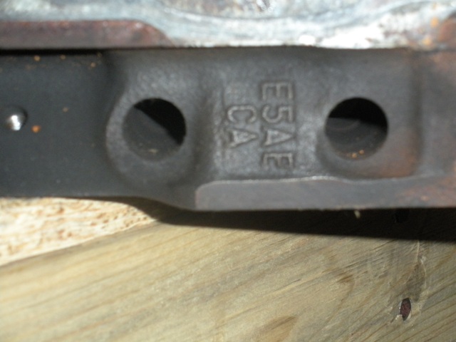

Post Options Post Options   Thanks (0) Thanks(0)   Quote Regul8r Quote  Post ReplyReply Direct Link To This Post Posted: 07-September-2010 at 3:51PM
Here is the number off the stock 351W heads.
Can someone PLEASE help me out with the CC of these and the motors compression ratio!?
And anything else you can help me with on these?
As you know I am looking to put the GT40 heads directly on this motor with stock bore/stroke/pistons.
The GT40 heads are a 64CC chamber from what I have found.

Post Options Post Options   Thanks (0) Thanks(0)   Quote Regul8r Quote  Post ReplyReply Direct Link To This Post Posted: 26-September-2010 at 4:59PM
Originally posted by cowboyupdjcarl cowboyupdjcarl wrote:
Originally posted by Blueoval76 Blueoval76 wrote:
Here is the info on heads......
 87-95 Stock E7TE Valve Size Intake - 1.78, Intake Ports Flow @ 124cc
87-95 Stock E7TE Valve Size Exhaust - 1.45
GT-40 Valve Size Intake - 1.84, Intake Ports Flow @ 155cc
GT-40 Valve Size Exhaust - 1.54
65cc Cumbstion Chambers
Thanks for that info.
As talked about... I did not get GT40P heads so the info above for the GT40 heads has helped alot.
I have been looking and researching and STILL cannot find the stock Compression Ratio for the 89 351W or the CC on the heads pictured that came off the 351W they are not E7T or E5T heads.
They are E5AE-CA heads. I have read MANY different sizes...
1. Some are 61-63 cc,some are 67-69 cc.
2. valves (1.782/1.46) and CC (69.0)
3. E5AE , valve sizes , 1.782in/1.46ex chamber cc, 67.5-70.5cc
Those are from 3 different websites!
There are cautions everywhere about putting the 351 heads on a 302 as they can lower the compression ratio. Same is true in the other direction with the wrong size CC Chambers.
Can someone PLEASE help me out with this??
1. Stock Compression Ratio 89 351W

Just got my "How to re-build the Small-Block Ford" book from E-bay.
got all the info for the heads!!!
351W heads E5AE-CA is 67-70cc, 1.78 int, 1.45 exh
The GT40 heads F3ZE-AA (from a 93 Cobra) 60-63cc, 1.84 int, 1.54 exh
So the GT40 heads will MOST DEFINATELY raise the Compression ratio on the stock 351W.
SO now I am researching what the STOCK compression ratio was on the 89 351W CV PI motor.
That will at least tell me a start point and then figure what the CR will be when I put the other heads on it.
Also looking at possibly putting the GT40 heads on the 302 after I put the 347 stroker kit in it.
The 72 heads...
MOST were 67-68 castings were 63CC the book does not show 72-78 casting CCs.
but I would assume they are more SMOGGED UP and higher CC and the 8.5:1 CR for the PUNY 141BHP. Assuming tha means the GT40 Heads would (alone) raise the CR on the 72 302.
It was the 97-2000 Explorer that had the GT40P F7ZE-AA heads that were 58-61CC.
Edited by cowboyupdjcarl - 02-October-2010 at 12:50PM
