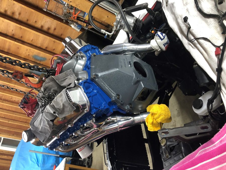

Hello Guys.
On the factory bellhousing question, I can tell you for a fact that the 351m 400 truck bellhousing will absolutely work in a car application.
There are a couple details to work through, but it is bolt in with the right parts and possibly having to trim the pilot bushing surface on the input shaft to length.
Still working on this project and just about buttoned up, but this is a 460, 400 truck bell, big in/out toploader in my 1969 Montego.
I have a 1970 429 SCJ bell and the truck bell, put them face down on a bench side by side and the height difference between them was (going from memory now) about or less than 3/16" with the truck bell being the shorter.
I did not measure the height of the truck bell against a small block bell, but the input shaft length is the same to the pilot area.
The difference in length between the big & small input shafts is on the pilot bushing surface only, the "Trick" in the old days for using a small input in a big block application was to trim the pilot bushing surface to the shorter length, if using a small input with the truck bell, you would still need to trim this to length too.
I mocked everything up out of the car, and even though I believe I could have bolted everything together and still had the clearance required, I put a small recess in the face of the pilot bushing to give a little extra depth for input shaft clearance to keep it from being pinned into the back of the crank.
Pictures Attached.
The last couple pictures show the relief I put into the pilot bushing to make sure it was not binding the input shaft on the back of the crank.
Post Options Post Options   Thanks (0) Thanks(0)   Quote handsofstone Quote  Post ReplyReply Direct Link To This Post Posted: 30-August-2021 at 11:55AM
     Is that a steel bell? Great info by the way. I found some pics earlier. The throwout bearing is the hydraulic setup.  Less issues wiith the exhaust.
