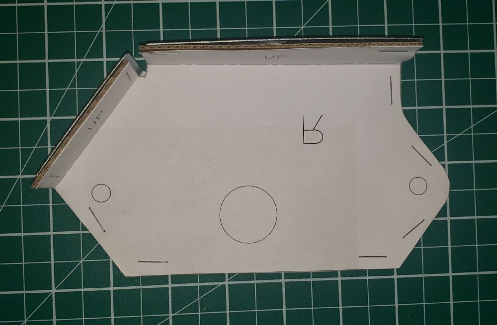

Someone was a looking for the 429/460 motor mount heat shields a while back. Since they are very simple pieces, I grabbed one out of my spare set and drew it up so anyone who needed/wanted a set could make their own factory style heat shields. (I've also posted this info under the HOW TO ARTICLES in case someone was on there looking for information to make their own)
Print the attached 460 Heat Shield.pdf out at 1:1 to use as your cutting/forming template. I have also put a scale illustration on the drawing to insure your print is full scale.
Good luck....
Post Options Post Options   Thanks (0) Thanks(0)   Quote TV 2M8O Quote  Post ReplyReply Direct Link To This Post Posted: 02-March-2025 at 5:00AM
Template trimmed and compared to OEM....
This should allow members who need an OEM style 385 series motor mount heat shield to replicate it for themselves. No idea how hard these are to source in the wild.
