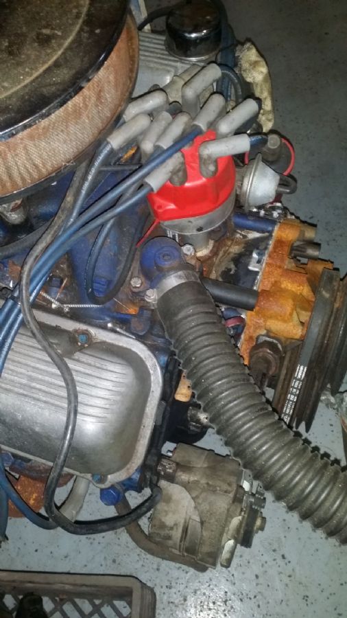

   I haven't looked in the cylinders yet but this engine would have to be disassembled for me to even think about a swap.
Post Options Post Options   Thanks (0) Thanks(0)   Quote 72 RS 351 Quote  Post ReplyReply Direct Link To This Post Posted: 23-April-2021 at 7:34AM

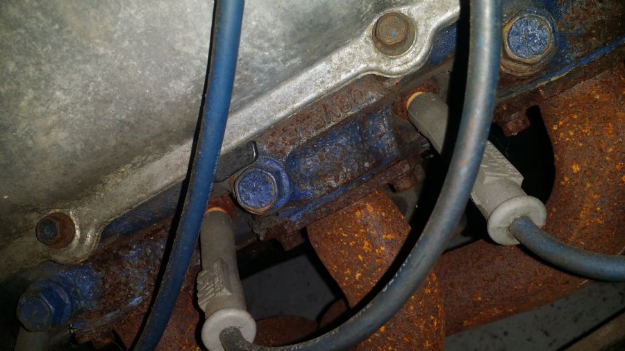

Headers, factory head bolts, painted ugly purple blue, it's been worked on. Does that say 1968 heads, C8VE? That could tell you something, but likely not enough to say it's worth $1000 versus $200.
dan0R30 View Drop Down
Joined: 30-June-2020
Points: 687
Post Options Post Options   Thanks (0) Thanks(0)   Quote dan0R30 Quote  Post ReplyReply Direct Link To This Post Posted: 23-April-2021 at 7:42AM
That motor has seen the elements for sure. Is that yours or looking to get? I'm sure its nothing a bore and stroker kit can't fix!

Post Options Post Options   Thanks (0) Thanks(0)   Quote handsofstone Quote  Post ReplyReply Direct Link To This Post Posted: 23-April-2021 at 9:06AM
The C8VE-E heads were used on either 429 or 460 according to various websites. Just the early version of the DOVE casting. If I am going to play around with another engine, the 351 I have would make more sense. I can pick up a cj top end for $50. Iron intake comes with the heads.
  The 460 would be nice but I don't see value in this one. I will run the bore scope into it next time I am at the garage through the carb and/or pull some spark plugs to have a look. It might be worth buying if it were a few hundred probably.  The valve covers don't appeal to me but ither folks look for them. He probably pulled this one in the 90s and it has been sitting in the old trailer at his last business or on the floor in this garage forever.
