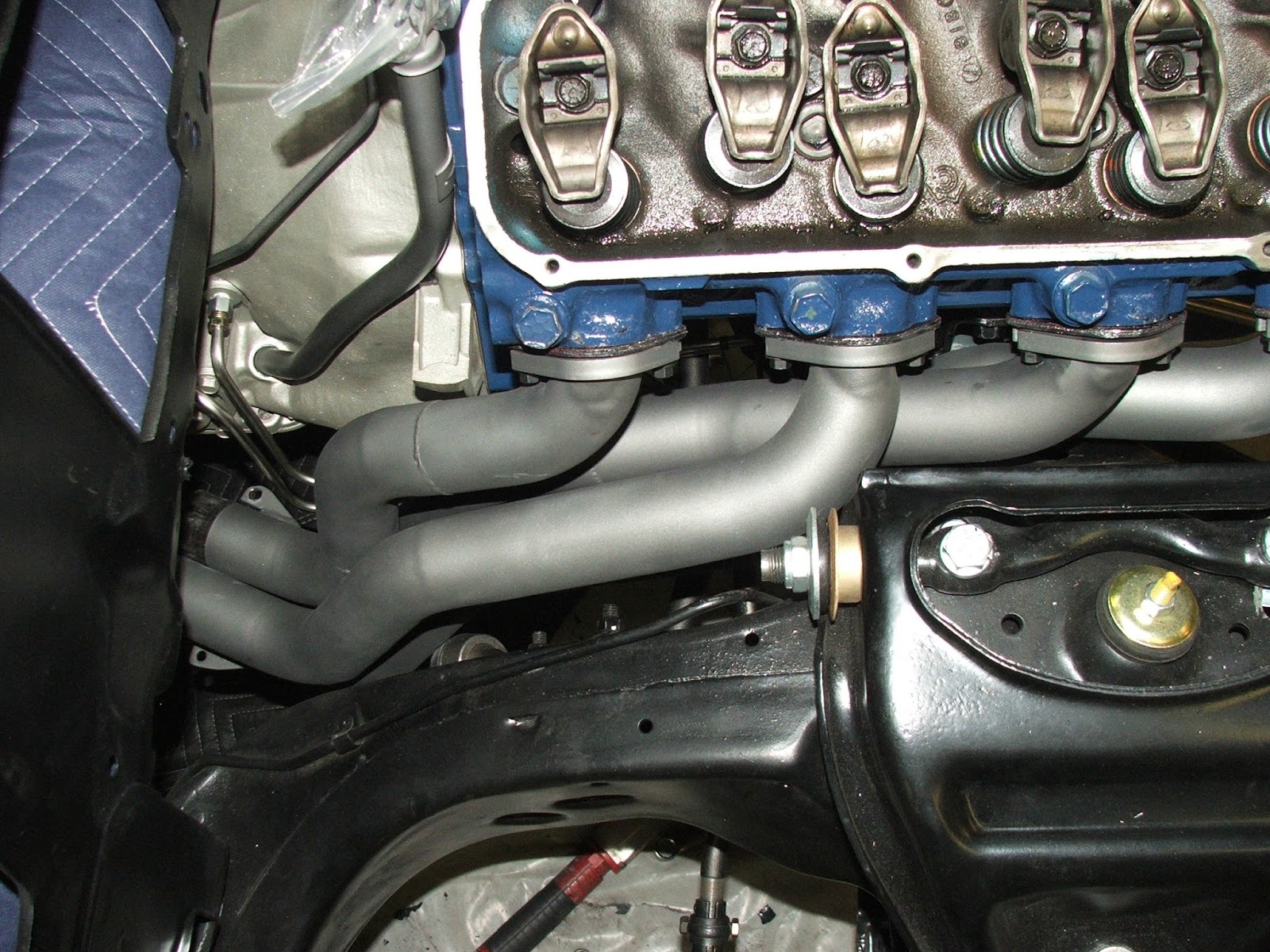

Well the longer header bolts arrived....

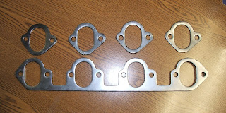

as well as the Remflex header gaskets....
Since the Crites 460 headers have individual header flanges, I trimmed the Remflex gaskets to the shape of the flanges....

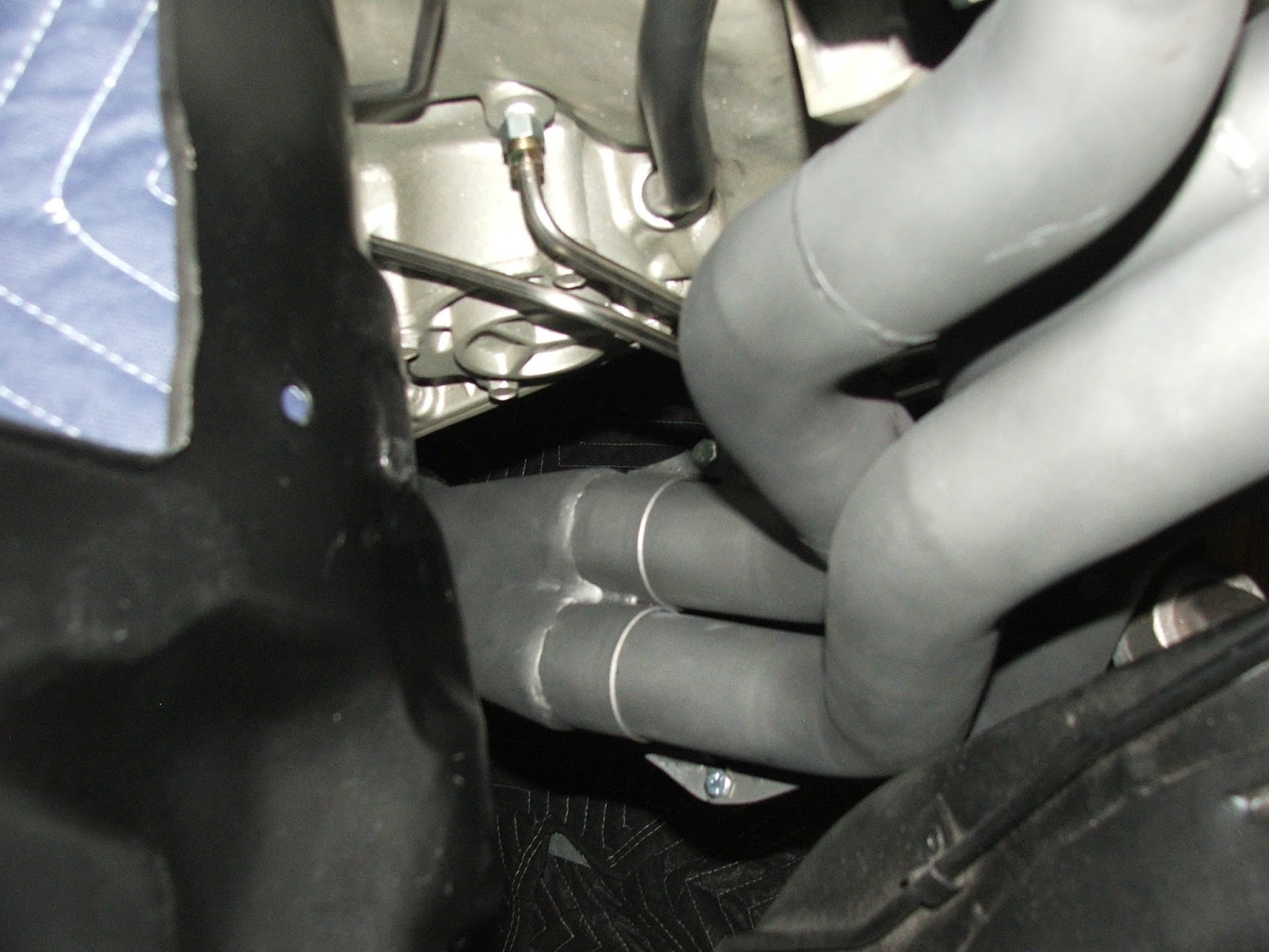

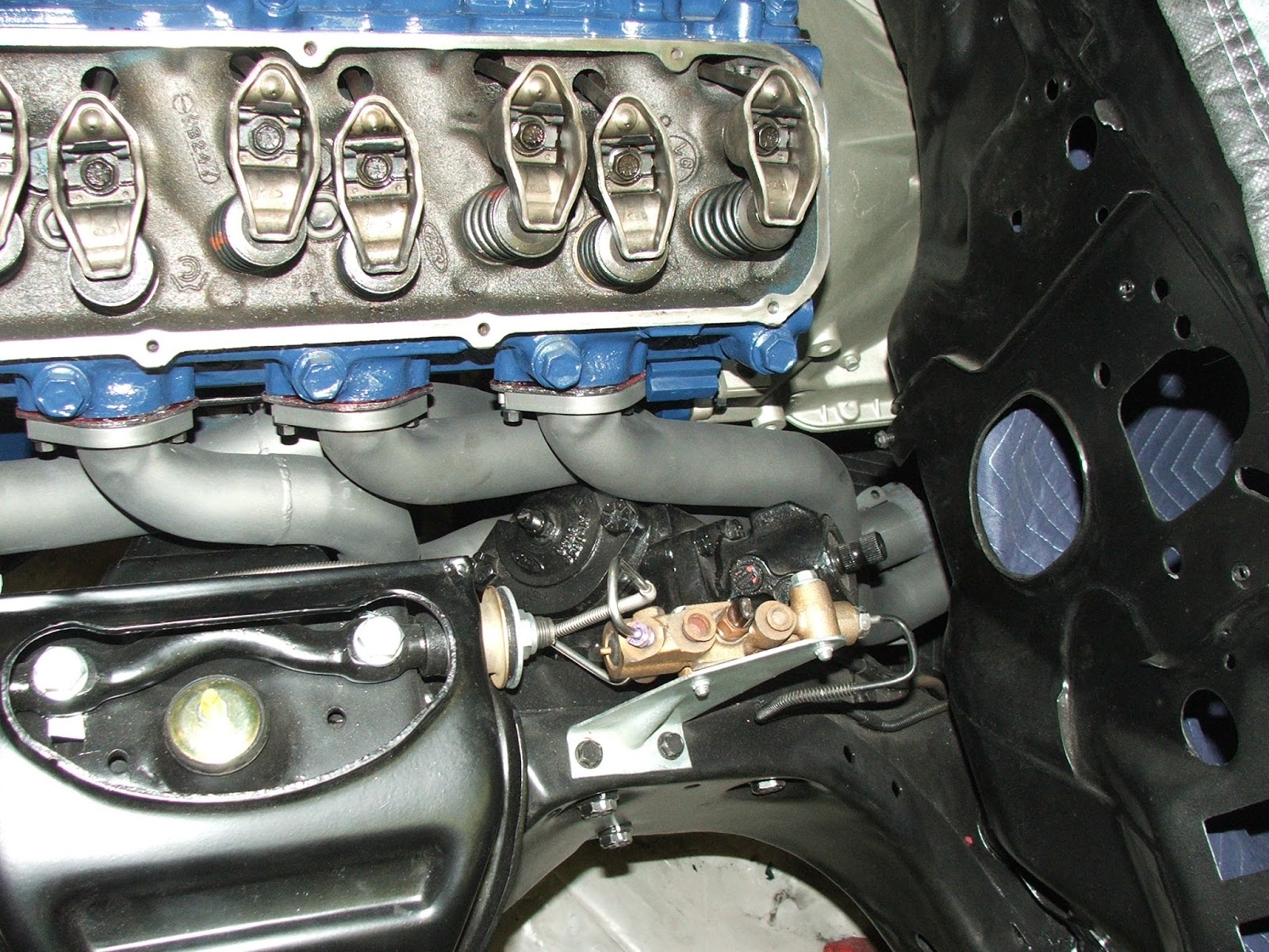

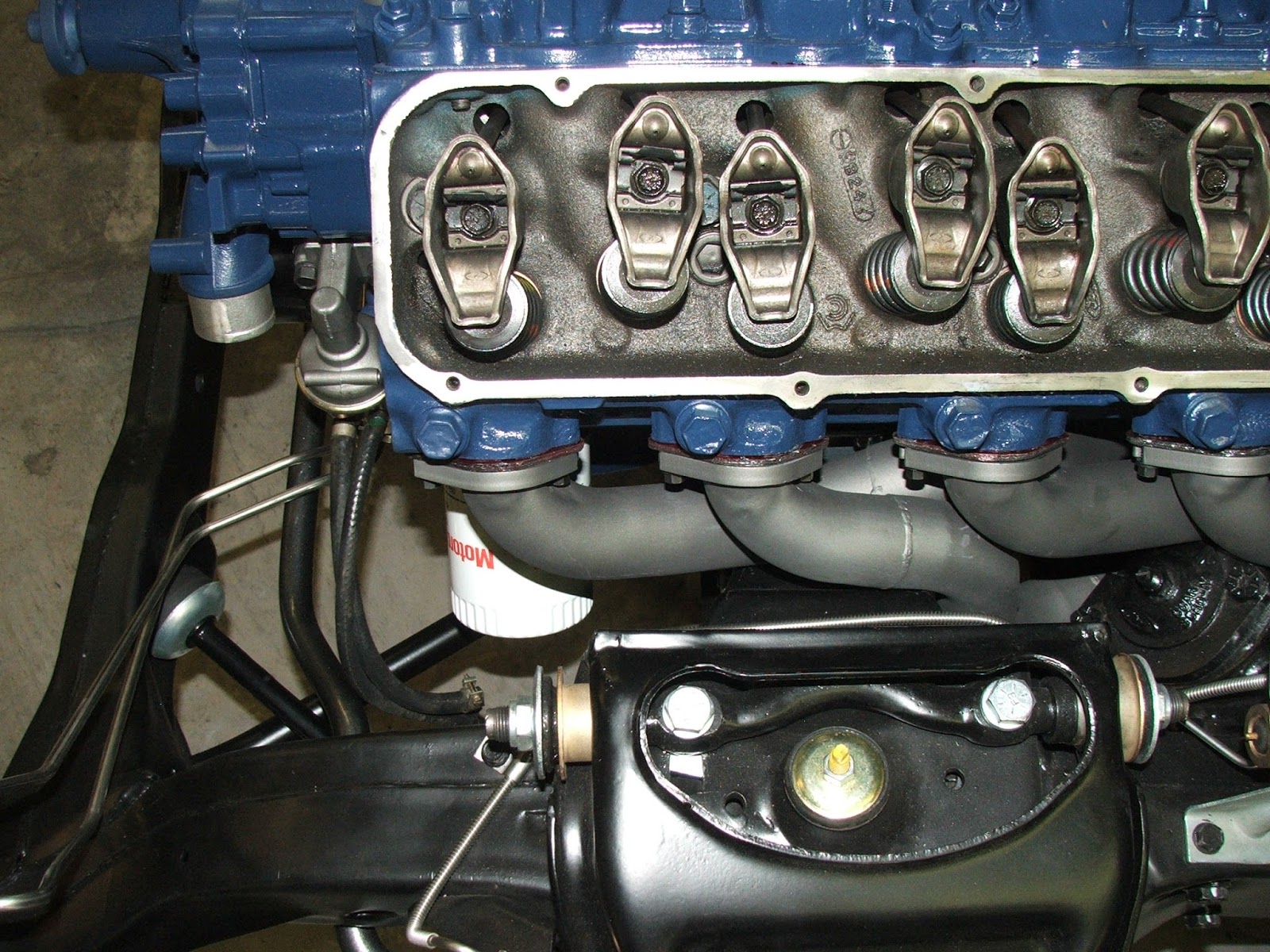

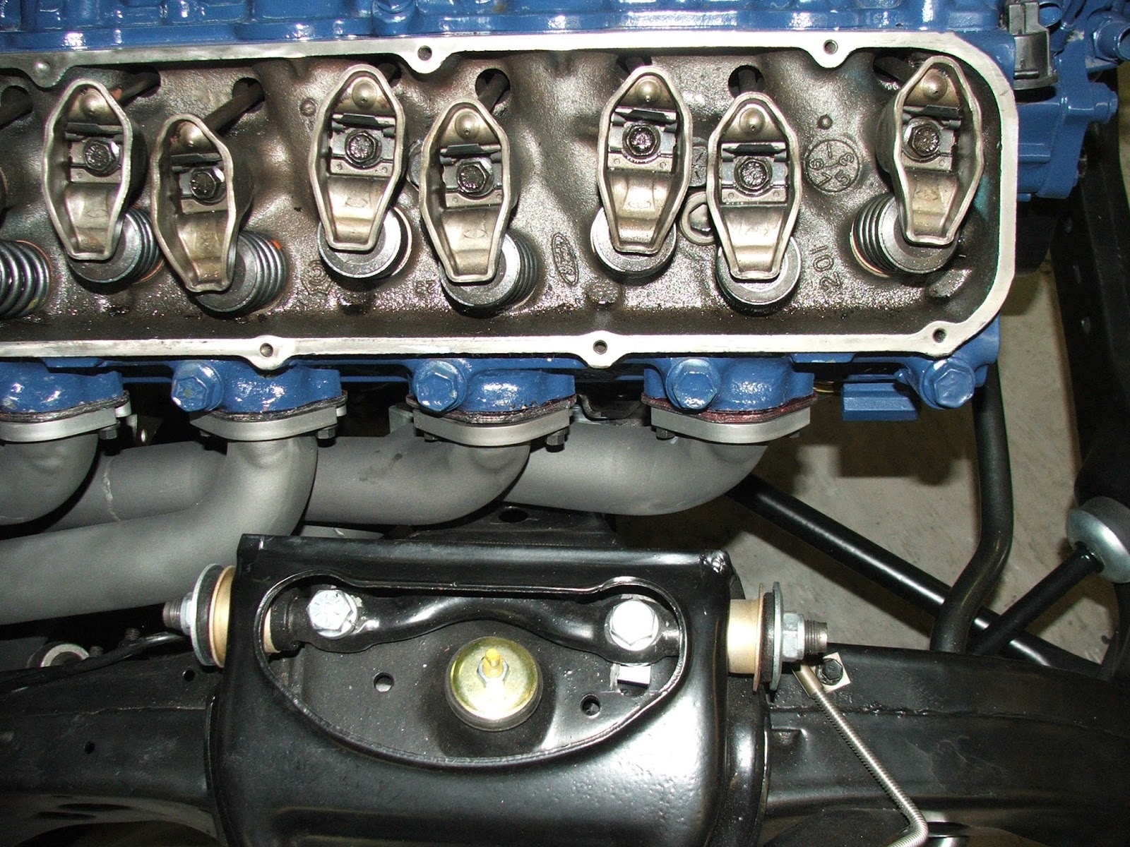

I shot the gaskets with a light coat of the adhesive on the block side just to hold them in place while the headers were installed one tube at a time (FYI, the contoured shape of the gasket goes down and the angle cut is the top). Once they were all hung...
and the collectors installed...
the header bolts were torqued to 20ft/lbs.
Will have to wait until I light this baby off before I'll know how well the gaskets perform!
