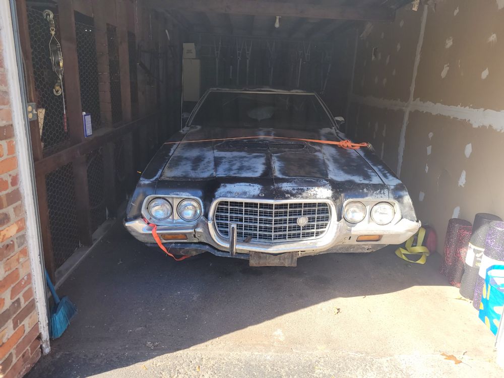

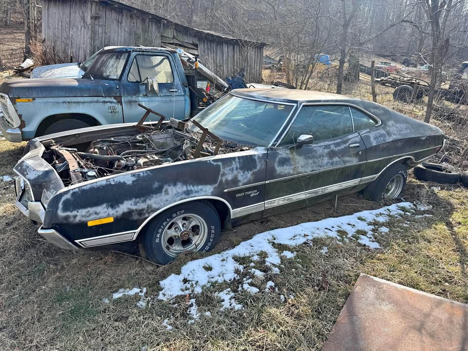

I’ve attached a pic of the old girl sitting in her new home in the garage, and one from where she was sitting when I bought her.
