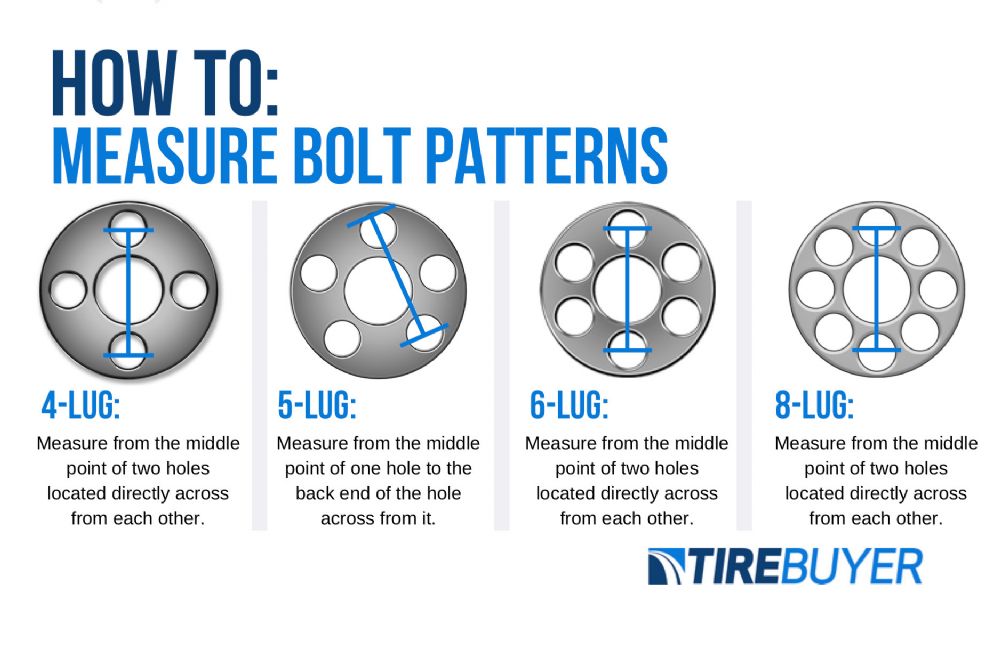

have you measured the studs on the wagon like the diagram i posted above shows?
