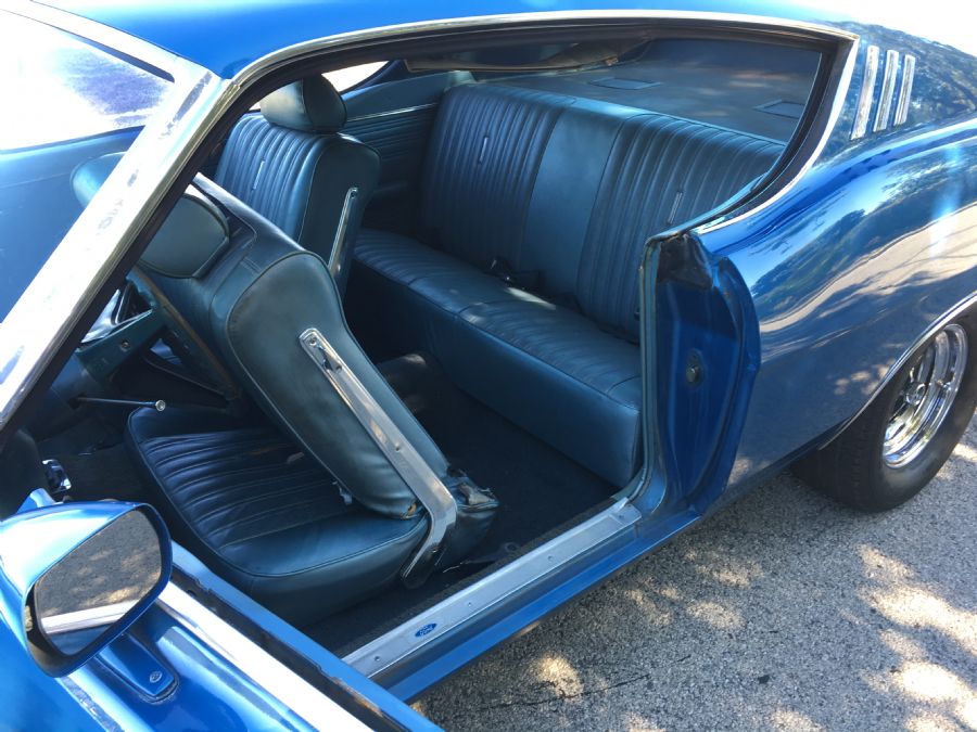

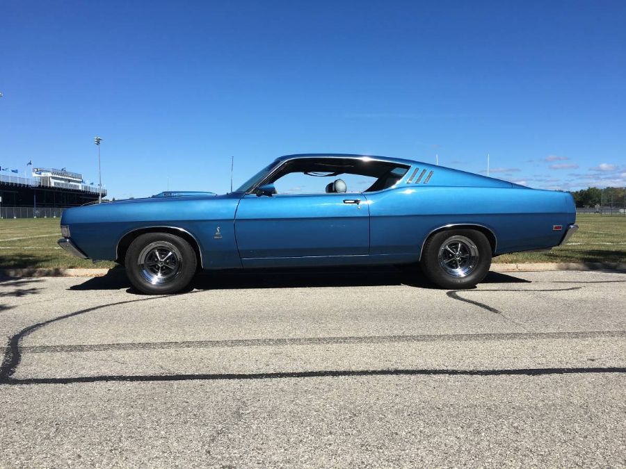

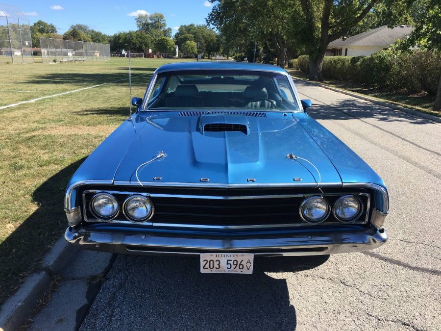

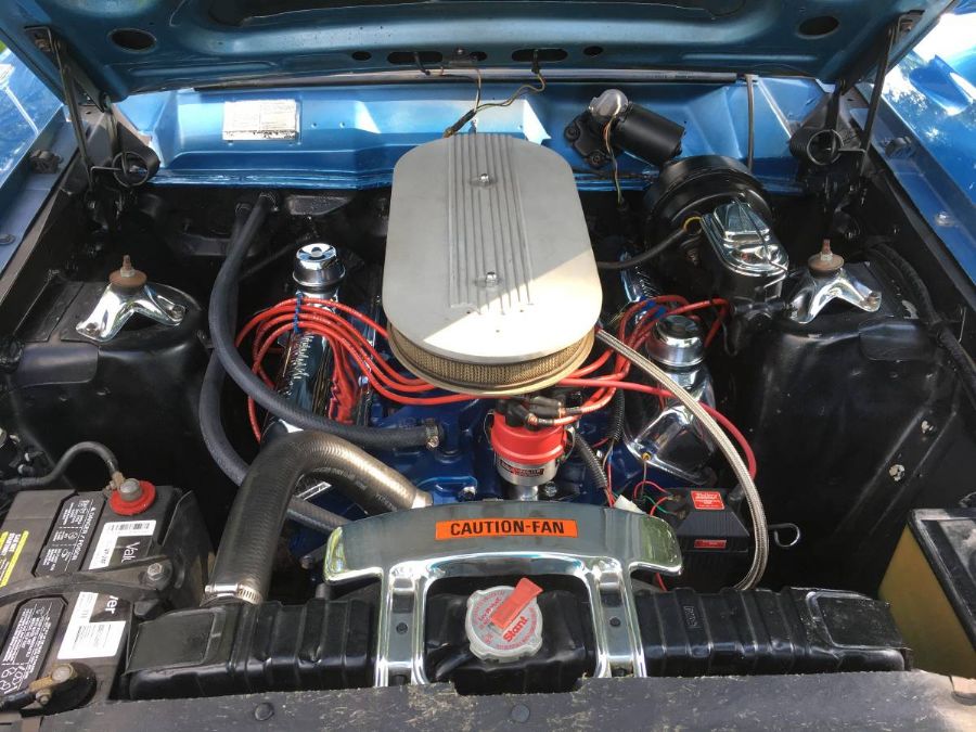

Hopefully this works...here are some pics of my 69 429 CJ. The original color was Brittany Blue and I will eventually bring that back. Drivetrain is original, but obviously not the correct air cleaner, carb, distributor etc. If anyone has any thoughts on some good parts guys, let me know as I'm in the market!! Thanks

Post Options Post Options   Thanks (0) Thanks(0)   Quote 72FordGTS Quote  Post ReplyReply Direct Link To This Post Posted: 21-November-2018 at 12:17AM
That is very nice!  I bet it moves out okay too. Is your plan to bring it back to 100% factory correct?

Post Options Post Options   Thanks (0) Thanks(0)   Quote farqs29 Quote  Post ReplyReply Direct Link To This Post Posted: 22-November-2018 at 5:36AM
Thanks. Yup that’s the plan over time... It drives now so just enjoying it while I start assembling some parts
