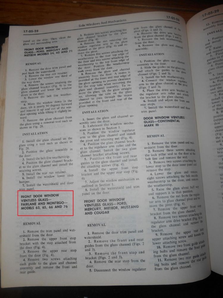

Hi Dax,
Welcome to the site.  See a couple of pics below from the '69 shop manual. The diagram doesn't seem to call out a specific name, just refers to it as 'Glass and Channel Assembly'. Also included the steps it calls out for removal & installation.  Good Luck with your project.
