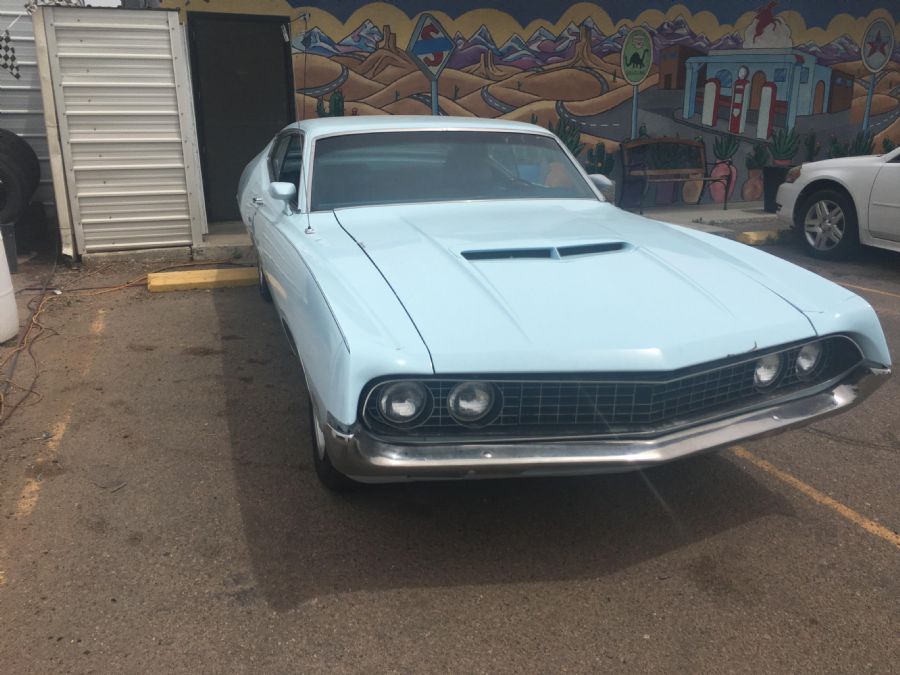

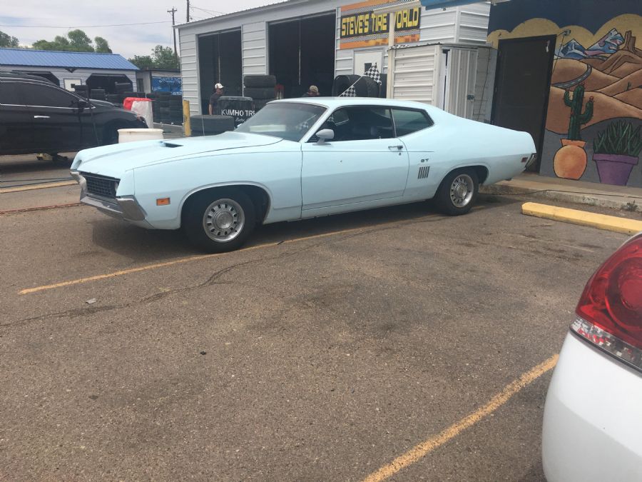

I'm trying to get some pictures up of my 70 Torino GT.
Edited by 72FordGTS - 25-May-2018 at 12:15PM
Post Options Post Options   Thanks (1) Thanks(1)   Quote 72FordGTS Quote  Post ReplyReply Direct Link To This Post Posted: 25-May-2018 at 12:16PM
I fixed your post for you Jim.  It might be easier to post one picture per post, then do a new post with another picture, especially if you are using a phone.
The car looks great!  Very nice Torino, and it looks to be in great shape.

This 70 Torino GT was sold to me as an 75000 mile actual miles car, but it came from a dealership so it is anybodies guess if it really is, but it is really clean and straight. Brings back alot of memories as I bought a brand new one in June 1970. I love reading posts about all the cars, keep up the good work. Thanks for allowing me on the site. JIM
