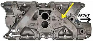

In order for the other members to figure out what year your engine is, you can look at the casting number on the intake manifold. And while it might be possible that ithe ntake manifold might have been changed on your engine at some time. This is a good way to find out a possible year for your engine.
There also might be a casting number for your engine block down near the starter motor or in the upper rear/back of the engine block near the cylinder head.
The casting number might say E7TE-8425-A or D1TE-8425-A or D3TE-8425-A or another number.

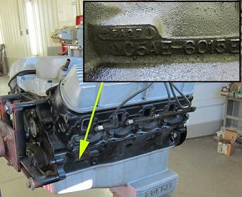

Post Options Post Options   Thanks (0) Thanks(0)   Quote dave302 Quote  Post ReplyReply Direct Link To This Post Posted: 17-July-2017 at 10:54AM
The yellow arrow in the picture below points to the casting number.

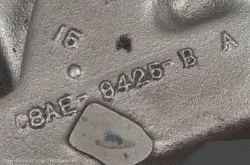

Post Options Post Options   Thanks (0) Thanks(0)   Quote dave302 Quote  Post ReplyReply Direct Link To This Post Posted: 17-July-2017 at 10:55AM
The casting number is in the picture below.

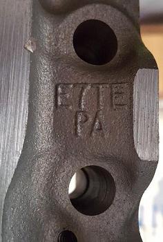

Post Options Post Options   Thanks (0) Thanks(0)   Quote dave302 Quote  Post ReplyReply Direct Link To This Post Posted: 17-July-2017 at 2:15PM
To find the casting numbers on the cylinder heads you might have to remove them. They are on the underside of the cylinder head, on the intake side in between the pushrod holes. The yellow arrows point to the casting numbers.
