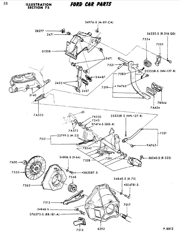

Post Options Post Options   Thanks (0) Thanks(0)   Quote Greengold72 Quote  Post ReplyReply Direct Link To This Post Posted: 02-January-2025 at 2:53PM
Rtgreen,
    I have a 72 sport Q 4speed car so am finally getting put back together and can’t remember spring setup on z-bar. My clutch goes to the floor and doesn’t retract. Any chance you have pictures of the spring set up? I would greatly appreciate any info you may have. Thanks Jeremy (218)251-5785
Post Options Post Options   Thanks (0) Thanks(0)   Quote 72FordGTS Quote  Post ReplyReply Direct Link To This Post Posted: 04-January-2025 at 10:45AM
Here is the parts diagram:
Post Options Post Options   Thanks (0) Thanks(0)   Quote Rockatansky Quote  Post ReplyReply Direct Link To This Post Posted: 04-January-2025 at 11:50AM
heck i'll save that, thanks Vince!
