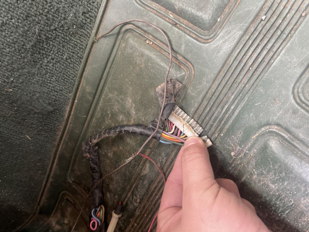

So this is what I have below my steering column. The red wire was run to an afterthought oil pressure gauge. The clip does to a bundle under the dash. And the brown exposed wire come from that harness

As far as the wiring goes, any other pictures of the dash?
I may have a couple dash harnesses I can sell, if your harness is chopped up bad.
Any other pictures of the damage?
The wiring connector that ties into the column is part of the switch assembly for turn signal
