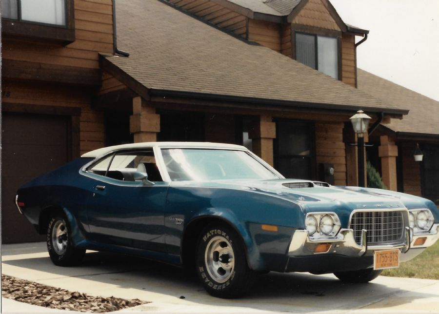

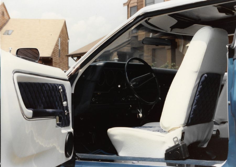

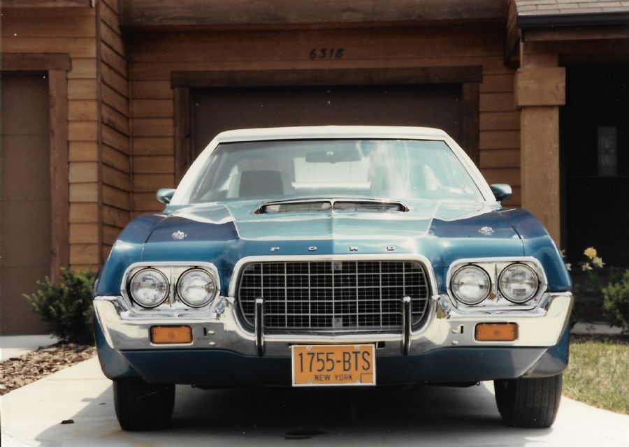

Here's some pics from the 80s that I scanned in. Will have more shortly.
Edited by apalya3 - 25-March-2019 at 10:51AM

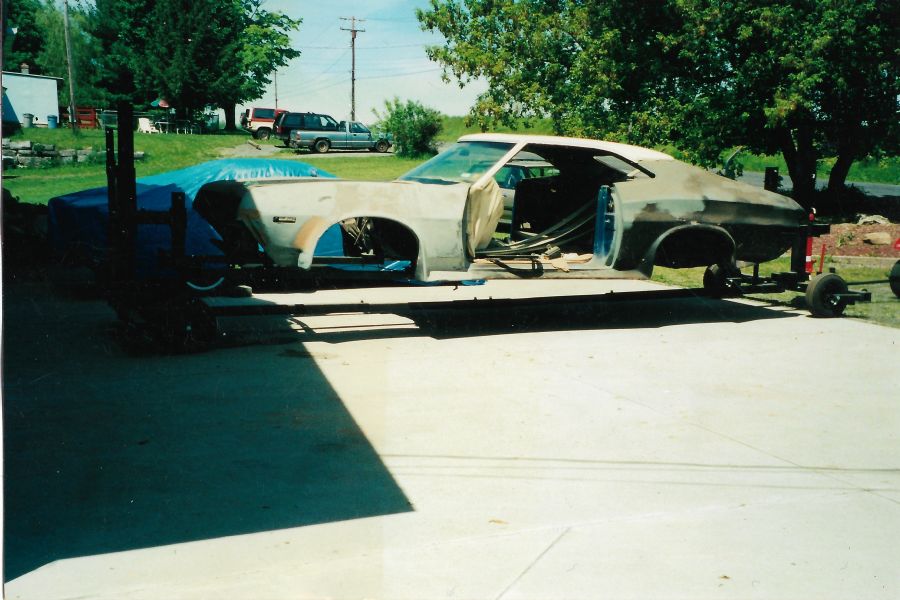

Here's some more recent pics. Body almost ready for paint
Edited by apalya3 - 25-March-2019 at 9:50AM

Post Options Post Options   Thanks (0) Thanks(0)   Quote californiajohnny Quote  Post ReplyReply Direct Link To This Post Posted: 25-March-2019 at 2:31PM
wow that's got an 80's vibe to it the flares and diamond tuck Wink that's an interesting vinyl top....
Post Options Post Options   Thanks (0) Thanks(0)   Quote handsofstone Quote  Post ReplyReply Direct Link To This Post Posted: 25-March-2019 at 2:58PM
Love it. Where are the Cragar ET's? Gone?

Post Options Post Options   Thanks (0) Thanks(0)   Quote apalya3 Quote  Post ReplyReply Direct Link To This Post Posted: 26-March-2019 at 1:04AM
He still has the original mags, as well as the space saver spare. With the flares, it really needs a set of 17s or 18s to fill out the wheel wells.  Once its back on the road I will do that and update the interior.

Post Options Post Options   Thanks (0) Thanks(0)   Quote 72FordGTS Quote  Post ReplyReply Direct Link To This Post Posted: 26-March-2019 at 6:37AM
Nice work on the frame, looks great.  I have never seen body flares like that, was that a custom kit?  What colour are you planning?

Post Options Post Options   Thanks (0) Thanks(0)   Quote apalya3 Quote  Post ReplyReply Direct Link To This Post Posted: 26-March-2019 at 9:43AM
  The frame was blasted and the welds were smoothed.  Then coated with POR-15.
From what I remember, my dad used copper tubing to form the flares and then brazed/tacked a wire frame to the tubing and the car.  Then laid fiberglass cloth over and blended.  i was about 8-10 years old when we did this so I will get clarification from him the next time I call him.
  I think we will go with a dark blue metallic.  If the top is still in good shape when we paint it, I will keep it white. If not, then I think black might look better.  I would like to bring the car out of the 80's with some fresh updates.

Post Options Post Options   Thanks (0) Thanks(0)   Quote handsofstone Quote  Post ReplyReply Direct Link To This Post Posted: 12-May-2019 at 9:58PM
 Was the vinyl done that way as a factory option?

Post Options Post Options   Thanks (0) Thanks(0)   Quote apalya3 Quote  Post ReplyReply Direct Link To This Post Posted: 30-May-2019 at 5:25AM
The top is custom.  He made new stainless trim pieces for the shorter top.
