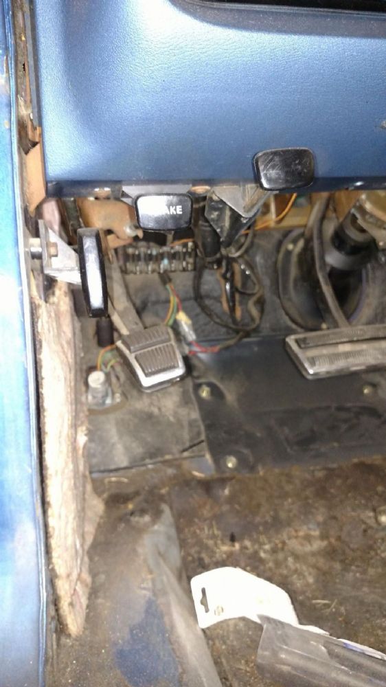

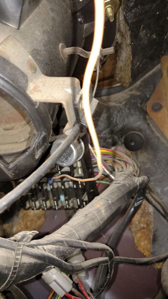

Does anyone have a picture or diagram of the driver side outside air duct.  The cable on mine is frozen and I would like to pull it down and get it working.  I would like to know where all of the mounting screws are so that I am spending minimum time under the dash.  Not easy being old!

I have a 73 but I believe it's the same as the 72.  I have two pics that will hopefully assist you.
The vent cable handle is mounted to the underside of the dash with I believe 2 screws.
Second photo shows the cable as it runs just to the side and above the fuse box where it attaches to a metal bracket with not sure if one or two bolts.  The cable end then attaches to the vent lever but I can't quite remember what secures it.  Hope this helps.

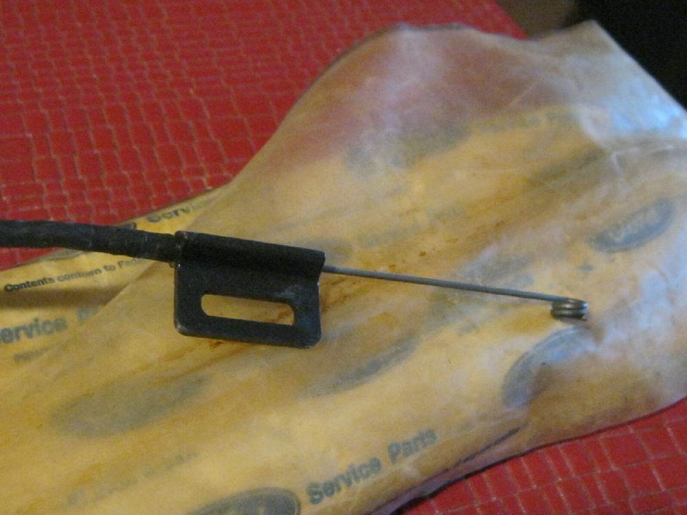

There is an NOS cable on Ebay with a pic that shows the end of the cable.
I believe the cable end just slides onto the vent lever and a cap slides onto the end of the vent lever.

This is exactly what I needed.  Thank you.

The square end that hold the handle was bent.  A little hammer work and some WD40 and it work fine.  Thank you again.
