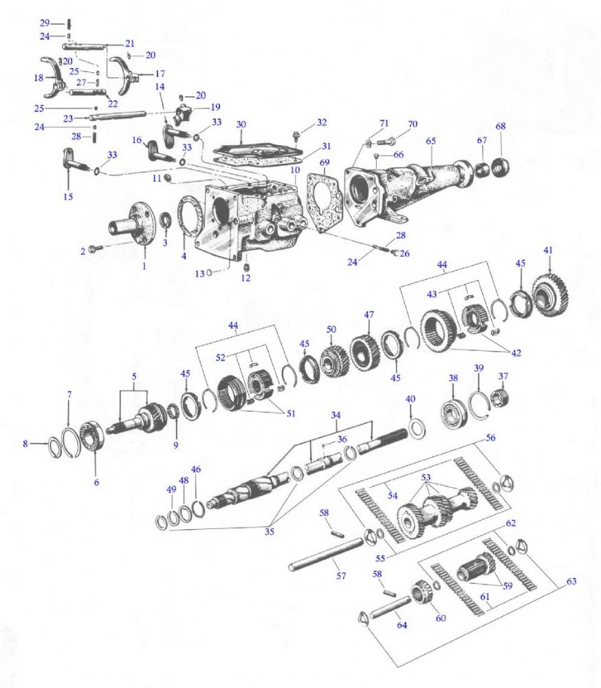

1972 Manual set
Chassis Volume 1
page 16-20-01 is for the Toploader four speed.
Page 16-20-04 has the exploded view of the detent rods. Peter, sent you messages on FB with the pictures from the manual.

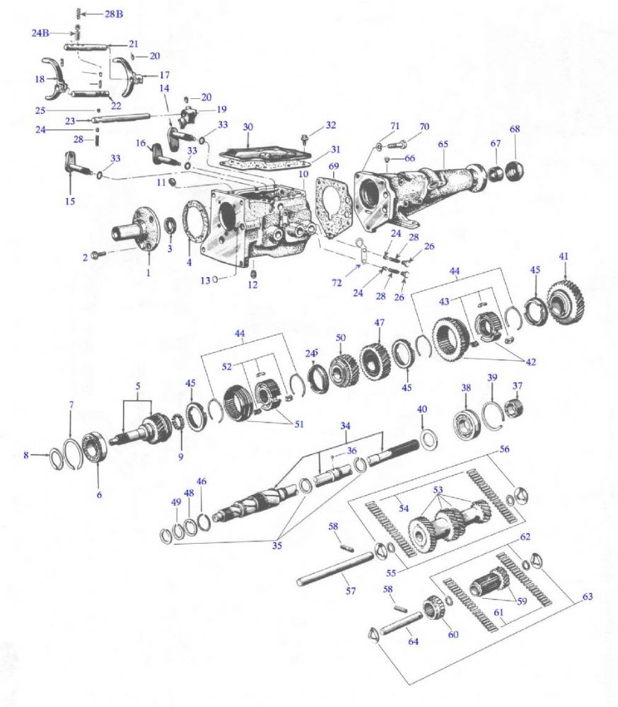

With this info, I was able to confirm i had put the unit together correctly. But, I also took the time to modify the early exploded view to show the 72-73 detent layout.
You will note, 28B, 24B, 72, and the number of detents going through the side of the case. This is updated just for the detent changes, other changes i did not make. (For instance this still shows the early shift rods).
I was missing the spring 24B, which he referred to as the "lighter spring", and he provided the size of this spring as being: "It is just a utility compression spring that is 1/4" diameter x 1" long x .020 wire diameter".
