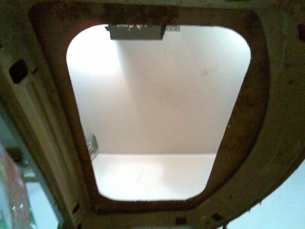

Also side note...
completely side note here...always remember chopping a roof can cause adverse issues.
Ask me how I know:

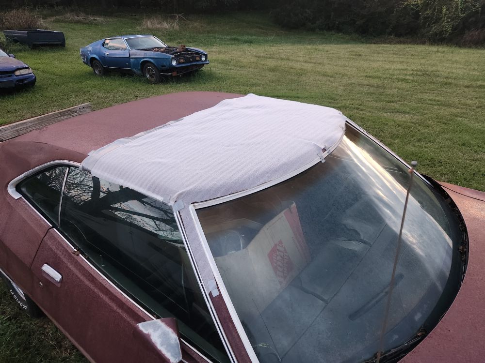

Post Options Post Options   Thanks (0) Thanks(0)   Quote MOTORCITYBADBOY Quote  Post ReplyReply Direct Link To This Post Posted: 25-September-2025 at 2:56PM
So I just picked up a 78 T-top Tbird parts car for $350. I made a template of the forward section of the roof with the t-tops, and cut it at the aft edge of the rear t-top molding. The front I cut at the top edge of the windshield trim, and extended it down the A-pillar a bit. From what I see, the forward part of the 72 Gran Torino Sports roof is exactly like the T-bird roof. This is not something I would tackle myself, but I think to have a 72 Gran Torino Sportsroof with T-tops, I'd be willing to pay a professional to install the structure for me...

Post Options Post Options   Thanks (0) Thanks(0)   Quote Eliteman76 Quote  Post ReplyReply Direct Link To This Post Posted: 25-September-2025 at 3:19PM
The issue is the GTS roof has an arch on the side glass.
Formal roof cars would be a better candidate but it can be made to work.

Post Options Post Options   Thanks (0) Thanks(0)   Quote MOTORCITYBADBOY Quote  Post ReplyReply Direct Link To This Post Posted: 26-September-2025 at 4:27AM
I think you're right. A solid roof Tbird, LTDII, or 77-79 Cougar would be a better choice for those T-tops.
