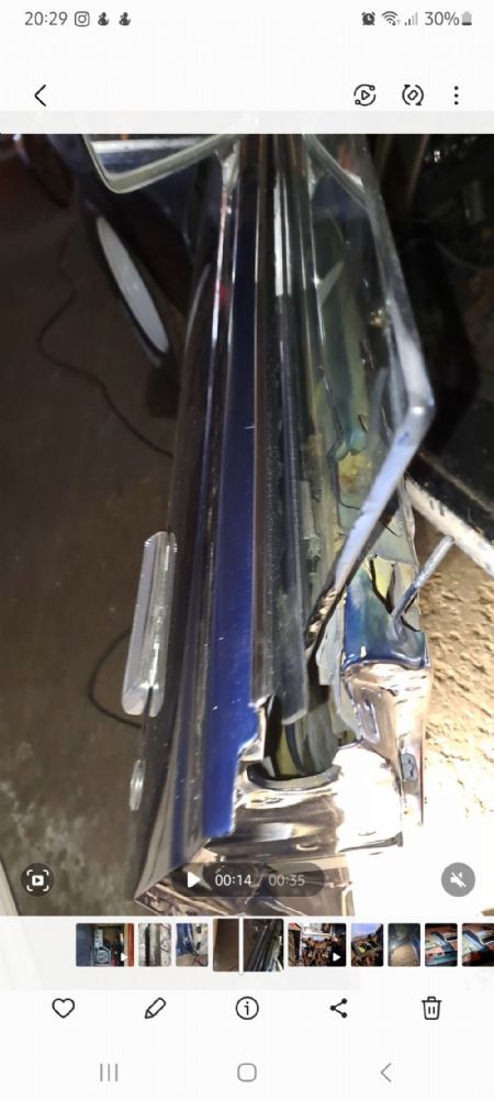

I bought a 73 Torino Base Model 4 door pillared hardtop in 2018. It was missing a lot of parts, among them door seals on 3 out of 4 doors. I figured that door seals for a 73 2 door would fit, they would just be too long... Man I was wrong 🤦‍♀️ I sure could use some advice/better links...
But! I got the weather strip kit last fall! I was trying it on today, and my rattly drivers side door with a glass that was held in place by an old bicycle hose... suddenly went both up and down like it should! 🤩👍 I didn't replace the ones that mounts to the door panel, as it looked ok. The outer ones were not on the car at all... I will mount the rest another day, just wanted to share the link and the good news 🤩👍

I found mine to fit - at least the outer part for my drivers side door. Maybe the ones I got in Sept 2024 was a brand new product? As I only have one door on my car that still has both inner and outer weatherstripping AND a complete door seal, I have no reference, but it fit 😁💪 My drivers side window have been completely loose, and I found an old bicycle hose and jammed it between the glass and the outer doorshell last year as it was rattling so bad I had to hold the glass while driving 🙈 I knew SOMETHING was missing, but did not realise that the chrome moulding that was still on one door only, actually was the rubber that was holding the glass in place until last fall... I haven't had license plates on it, as it's been a work in progress, but I got my plates in October 2024 👍 These days I'm trying to make it ready for the season, so wanted to mount the brand new weather stripping. And it was really a WOW-moment! I'm very happy with them, even if they were very expensive 🙈

I got my set from Ebay. The clips for the outer one (the one I needed) fit perfectly into the slots on the door 🤩 I am very happy with the fit. I have only mounted the one on the drivers side door, as the car is parked a little awkward for opening the doors enough, but that one fit perfectly. I really recommend this company and they also ship overseas to Norway, whitch has started to become a problem over the past 10 years...
