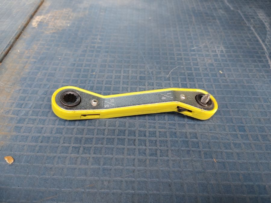

I ended up taking a philips head bit and grinding it down on the back side so it could fit in the space, and then used a ratcheting wrench to turn it, so I could get those screws out.

Once I used the tool I posted a picture of above to get the screws out and remove the inside panel, I removed the rod that goes between the inside handle and the outside handle. Once I did that, the outside handle worked again. I can only open the tailgate to the left instead of down, but it didn't open at all before that, so that's an improvement. Someday I'll figure out why the inside handle was preventing the outside handle from working, but first I need to get a new tailgate window mechanism. Mine has the power window, and I can hear the motor, but the window doesn't move, so the nylon gears are broken. That window has to be rolled down before you can fold down the tailgate.
