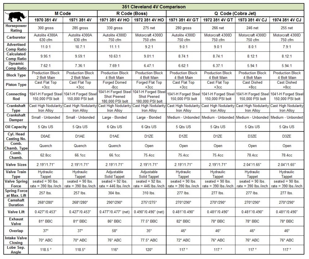

here's a similar run-down by Tom Custom
The Q code is the Cobra Jet and it is a Cleveland.
by Tom Custom
The Q code engine package was introduced in 1971 as a performance version of the 351C. Here are the different versions of the US 351C
1970:
H code 351C-2V, two barrel engine, 9:1 CR, open 2V style heads
M code: 351C-4V four barrel engine, 10.7:1 CR, closed 4V style heads
The M code used a small cam. It was powerful, but not a performance engine. That is, it didn't have any "race" parts. Both engine used positive lock rockers and flat top pistons.
1971:
M code: 351C-4V four barrel engine, 10.5:1 CR, closed 4V style heads
R code: (BOSS351) four barrel engine, 11.7:1 CR, closed 4V style heads with adjustable rockers, forged pistons, high strength rod bolts, crank selected for a minimum hardness, solid lifter cam, large balancer, four bolt mains, dual point ignition, special exhaust manifolds (not that you could tell by the outside), baffled oil pan, aluminum intake and big spread bore carb. This was a serious performance engine package.
1971.5:
Q code: Cobra Jet 4V 9:1 CR four barrel engine. Had special parts like high lift cam (same profile as 428CJ), dual point ignition with 4 speed, larger harmonic balancer, baffled oil pan, four bolt mains, big spread bore carb. This engine used open 4V style heads with positive lock rockers. Lower cost, easy maintenance, regular gas performance engine.
1972:
H code 351C-2V, two barrel engine, 8.5:1 CR (or so), open 2V style heads
Q code: Cobra Jet 4V 8.5:1 CR (or so) four barrel engine. Same as 1971.5
R code: HO four barrel engine, 9.5:1 CR, open 4V style heads with adjustable rockers, forged pistons, high strength rod bolts, crank selected for a minimum hardness, solid lifter cam (slightly different than the Boss), large balancer, four bolt mains, dual point ignition, special exhaust manifolds (not that you could tell by the outside), baffled oil pan, aluminum intake and big spread bore carb. This was a serious performance engine package, and a low compression version of the Boss.
1973:
H code 351C-2V, two barrel engine, 8:1 CR (or so), open 2V style heads
Q code: Cobra Jet 4V 8:1 CR (or so) four barrel engine. Dished pistons, 2V sized valves in the 4V heads. Cam is identical to 1971 except ground 4 degrees retarded. It gets an EGR system. Only 4V Cleveland engine option in 1973/74.
The 1973 Q code used a special air cleaner housing with the usual snorkel on the right side, a second air inlet controlled by a vacuum servo on the left (US driver's) side, and a chrome lid. Transmissions with the CJ were either the Toploader (only close ratio available in 1973) or the C6 with a special smaller diameter, high stall torque converter. Dual points only with 4 speed. All CJ years cam with a cast iron spread bore intake manifold
1974:
Same as 1973. No 4 speed option so no dual points for Q code. Last year for the 351C. In 1975, the taller deck 400 would used with a destroked crank and different pistons to make the 351M. The 400 continued with the 351M until 1980?

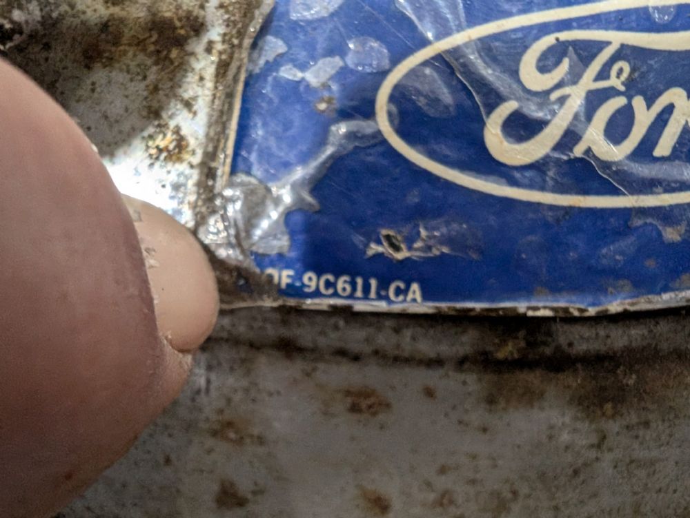

i thought about this today, is there a part number on the decal?
this ebay ad shows a number but i can't quite make it out

Looks like D3OF-9C611-CA which would be 1973, which makes it interesting because the ebay listing says 1972. I imagine that decal is something someone remade on a computer.
I've got a 351CJ lid in the parts stash that I believe to be OE, D2OF-9C611-CA.

I have no answer as to cj vs 4v. One thought would be the aforementioned R-code 351 would have used the 4v decal in 1972, but those used their own 351 HO decal. Possibly the M-codes in 1970/71, but they wouldn't have had a D2OF in their decal, or ford botched their parts numbering system.
If I were to guess, it was the 71 built 1972 models that used the CJ, and once supply was exhausted they switched to the 4V labeled cleaner in late 71 or 72.
Post Options Post Options   Thanks (1) Thanks(1)   Quote peter.jenerette Quote  Post ReplyReply Direct Link To This Post Posted: 16-October-2024 at 6:18AM
On the part number thing. My 98% original 72, built in April, has many of the trim and decorative parts numbered with D3Ox-xxxxx-xx part numbers. I even have trim and interior parts that are clearly stamped with a "rejected" inspection stamping, but were still installed.
On the CJ vs. HO, McFord might know something, I'll reach out to him. I know he was at one time compiling information to try and determine which 72's had black firewalls vs. body color.
