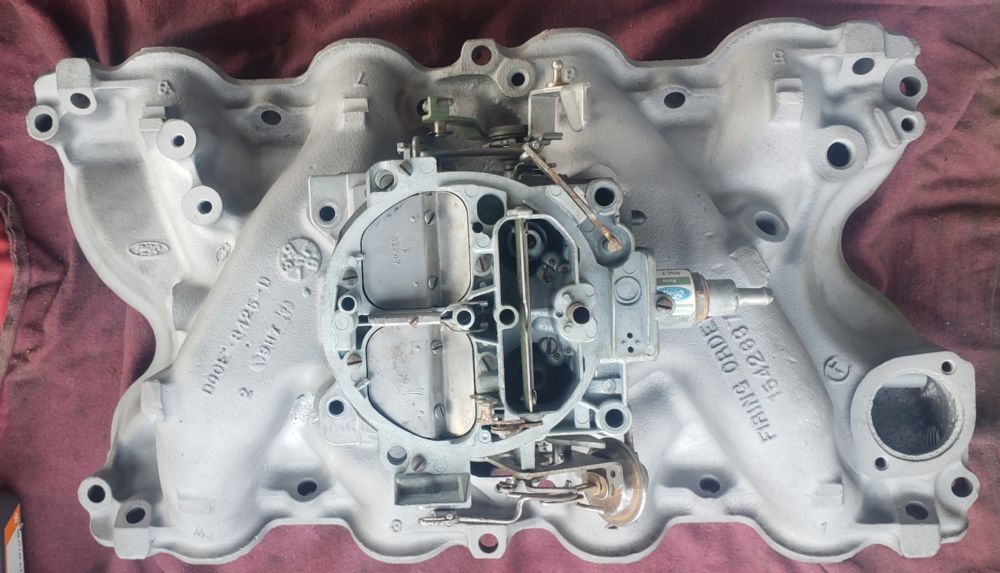

Post Options Post Options   Thanks (0) Thanks(0)   Quote Rockatansky Quote  Post ReplyReply Direct Link To This Post Posted: 14-January-2026 at 12:17PM
are you sure the manifold accepts a Quadrajet or is it the Ford 4300-D spreadbore? i'm not sure if the secondaries are the same size / location but the primaries are different in both size and location. Rochester made 573 billion GM Quadrajets and maybe like 14 for Ford? was the Ford Quadrajet only a 1 year run? the linkage flange is different and i'd imagine all of the internal metering as well as spec'd by Ford
but yeah the Ford 'bog is a rare bird
Post Options Post Options   Thanks (0) Thanks(0)   Quote TV 2M8O Quote  Post ReplyReply Direct Link To This Post Posted: 15-January-2026 at 6:48AM

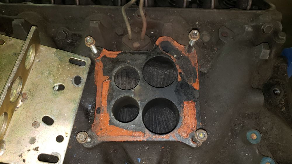

Max, here's my '71 429 CJ intake....
as you can see it's definitely the Quadrajet mounting. Guess I'll pick up the Rochester QJ to Holley spread bore adapter. Kinda liked the idea of cruising on the smaller bores then really dumping the fuel into the engine when I needed her to gitty up and go!! Oh well.....
I see the 429/460PI intakes have the funky Holley style spread bore carb mounting so I'd hate to think how hard that carb might be to find!

Post Options Post Options   Thanks (0) Thanks(0)   Quote 72FordGTS Quote  Post ReplyReply Direct Link To This Post Posted: 16-January-2026 at 2:58AM
What about using a Holley Q-Jet replacement carb?
I don't know much about these, but Rock might know more?
They are discontinued, but maybe you will have more luck finding one compared to a Ford Q-Jet. And I am sure they would be cheaper.

Post Options Post Options   Thanks (0) Thanks(0)   Quote Rockatansky Quote  Post ReplyReply Direct Link To This Post Posted: 16-January-2026 at 6:05PM
not a lot. not surprised they're discontinued as Holley is for the most part out of the carburetor business. i've been thinking about Q-Jets lately, i've never known them to be anything but a darn dependable good running street performance tool. and the sound they make when you flip the lid! this page i use https://www.mortec.com/carbs.htm for basic Holley reference shows 3 model 4165's, List #'s 6262, 6710 and 9023 if i didn't miss any. not a complete list
List .. cfm ...... jets ...... pv's
6262 800 (F)62,(R)85 8.5,6.5
6710 800 (F)63,(R)86 6.5,3.5
9023 800 (F)61,(R)86 8.5,6.5 (marine)
i also just ran across a Model 4175, List 80555C 650 cfm.
not sure if there are more 4175's or what the difference is?
OK yeah there are, more than a couple. 9923, 8679, R9895, R8546 on ebay
so anyway that's where i was going with all this, you never know what'll pop up NIB on ebay from time to time

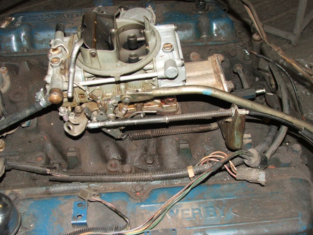

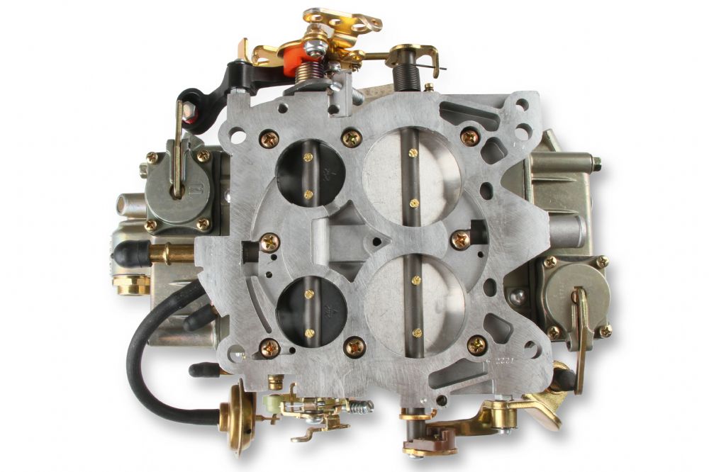

Post Options Post Options   Thanks (0) Thanks(0)   Quote 72FordGTS Quote  Post ReplyReply Direct Link To This Post Posted: 17-January-2026 at 1:32AM
I agree with Rock, Q-Jets are great running carbs.  I worked at a GM shop when I was young and also have owned numerous cars with Q-Jets.  So I know them well and have rebuilt many. They were IMO one of the best all around daily driver carbs.
Also, Joe, Maybe the Holley spreadbore isn't an option for you because it didn't come from the factory on a Ford, but it does have the small primaries and large secondaries like a Q-Jet.  FWIW, my dad's old '79 F-150 had a factory Holley (not sure which model, but I am pretty sure it was not a spreadbore) on it's 460.
Here is a pic of the Holley:

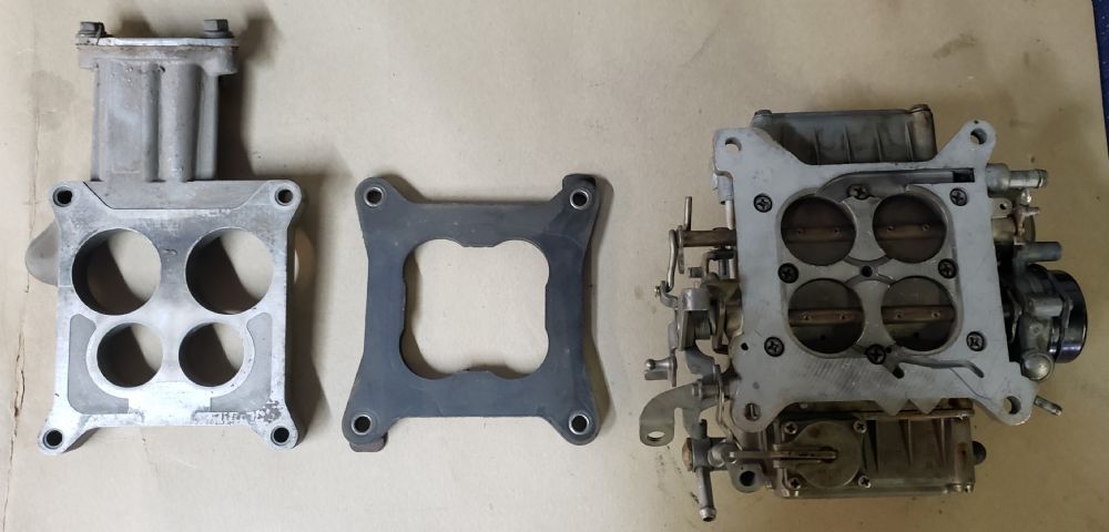

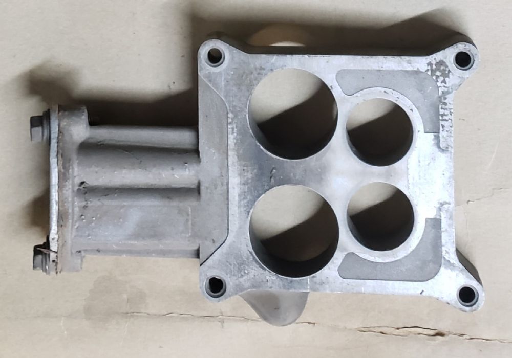

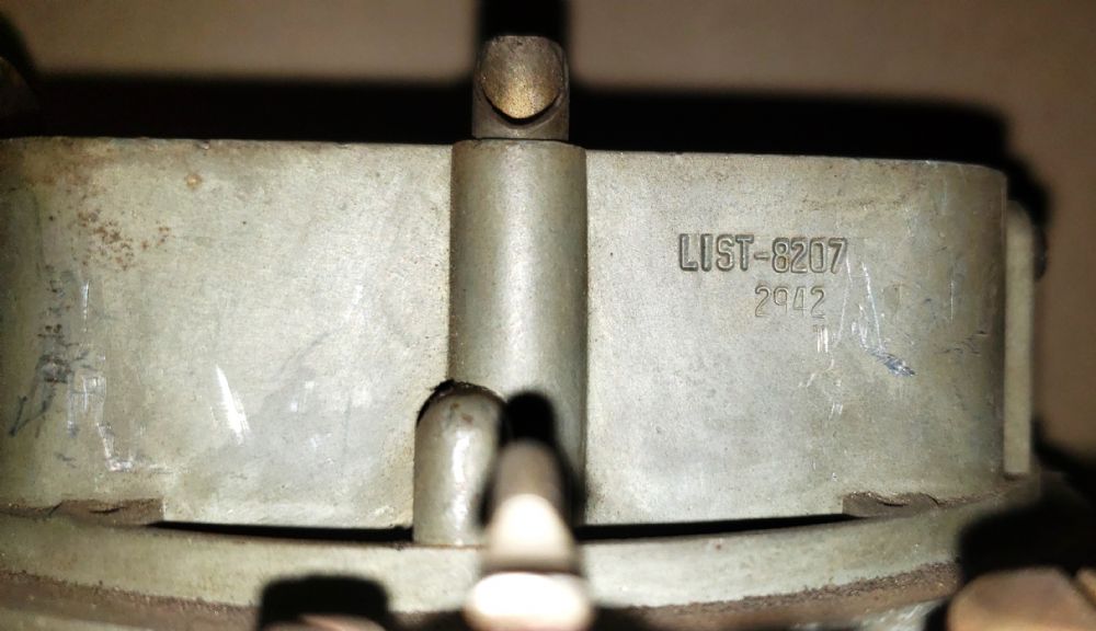

Morning guys. Yesterday I rolled my original 460 out of the corner and pulled it's old carb and spacer out of the stash to see what was on the engine when I got it. Research showed that from the factory, the Torino 460 came equipped with a Motorcraft 4350 spread bore style carburetor. Lookin at the intake manifold on my original engine shows it is indeed set up as a spread bore (FOMOCO pattern?)....
Here are the components on my Torino when she arrived....
The original EGR spacer also has the spread bore venturi arrangement.....

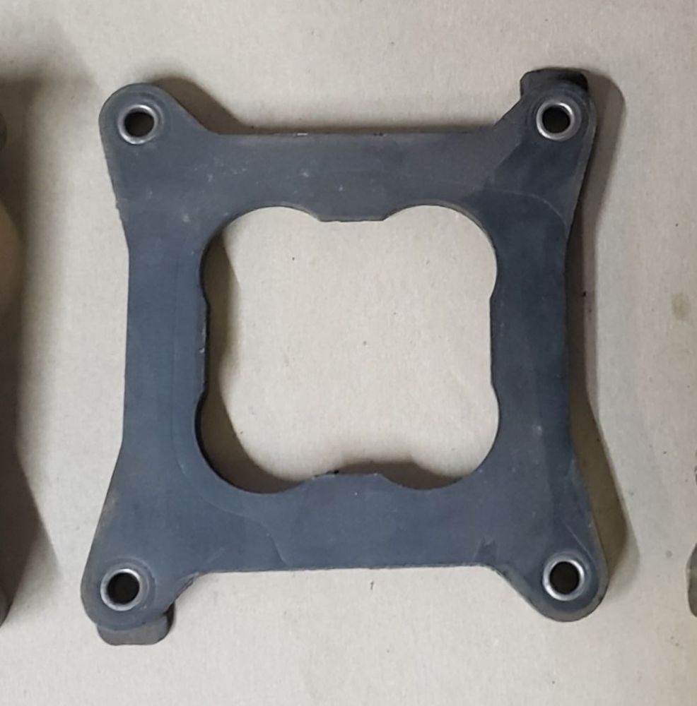

But then an open throat spacer/adapter was installed....

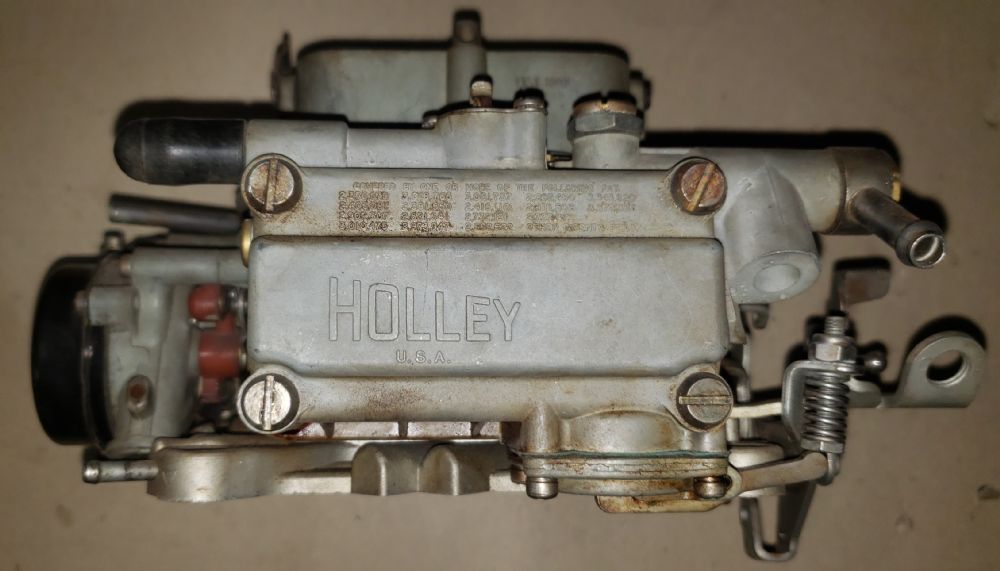

followed by a Holley List-8207, 4160 series, 600 cfm carb.
Well I also discovered the Motorcraft 4350 was a 550-600 cfm carb while the earlier Motorcraft 4300 was a 715 cfm carb. So now I'll dig into the Motorcraft versus Rochester carbs and try to narrow down my search.
Again, my thanks for your input!

Post Options Post Options   Thanks (0) Thanks(0)   Quote Rockatansky Quote  Post ReplyReply Direct Link To This Post Posted: 18-January-2026 at 8:02AM
Morning guys. Yesterday I rolled my original 460 out of the corner and pulled it's old carb and spacer out of the stash to see what was on the engine when I got it ...
yes the Rochester / Carter spreadbore pattern is different from the Ford pattern, which i believe (haven't checked yet) is a hybrid of the Holley 4150/4160 primaries and the 4500 Dominator secondaries. the Rochester / Carter primaries are located more outboard than the Ford pattern. just to be clear there is a Ford 4300 carb which is a squarebore flange, the 4300-D and 4350 that i forgot about are speadbore.
the open gasket on top was necessary to allow the squarebore secondaries to open ;)

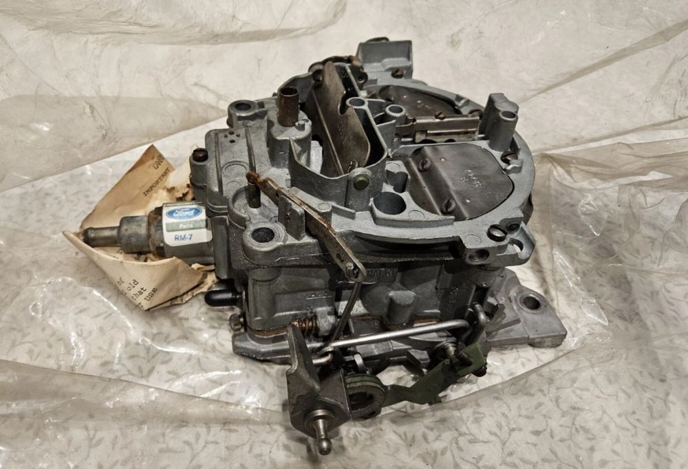

Post Options Post Options   Thanks (0) Thanks(0)   Quote TV 2M8O Quote  Post ReplyReply Direct Link To This Post Posted: 09-February-2026 at 3:40AM

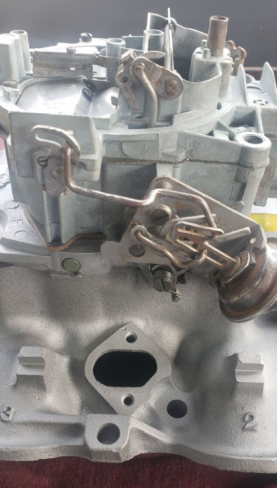

Well, here is a pic of the Quadrajet I scored on Marketplace....
As you can see by the decal on the fuel filter it is a Ford Reman unit that has been in storage for decades!! This carb is set up for a non-AC, Automatic CobraJet so I will need to source the necessary parts to be able to use it for an AT/AC car.
Speaking of decades in storage and sourcing parts, I opened up the bits that were included with my C8VE heads hoping to find the fulcrums, rockers, studs and hardware for the OEM valvetrain only to find just the screw in studs. Confused I was hoping to do a "day 1" head swap by using the early style C8VE components atop the rebuilt 460 short block, so if anyone has a complete set of ball fulcrums, rockers and lock nuts they could part with PLEASE let me know! Thumbs Up
Thanks guys Beer
Post Options Post Options   Thanks (0) Thanks(0)   Quote 72FordGTS Quote  Post ReplyReply Direct Link To This Post Posted: 10-February-2026 at 11:59AM
The carb looks great!  For the AT, really the only difference would be a provision for the kick down rod.  Try to find a pic on an AT carb to see the differences in the linkage.  It might be worthwhile to pull the off the carb to check what primary rods and jets you have, and to double check the float level.  The secondary rods can be removed without taking the top off.  Or you can just take a chance and try to run it as is and tune from there.
Another note, you will need different sized hold down bolts front and rear.  You can buy aftermarket Q-Jet bolts that are similar to factory.

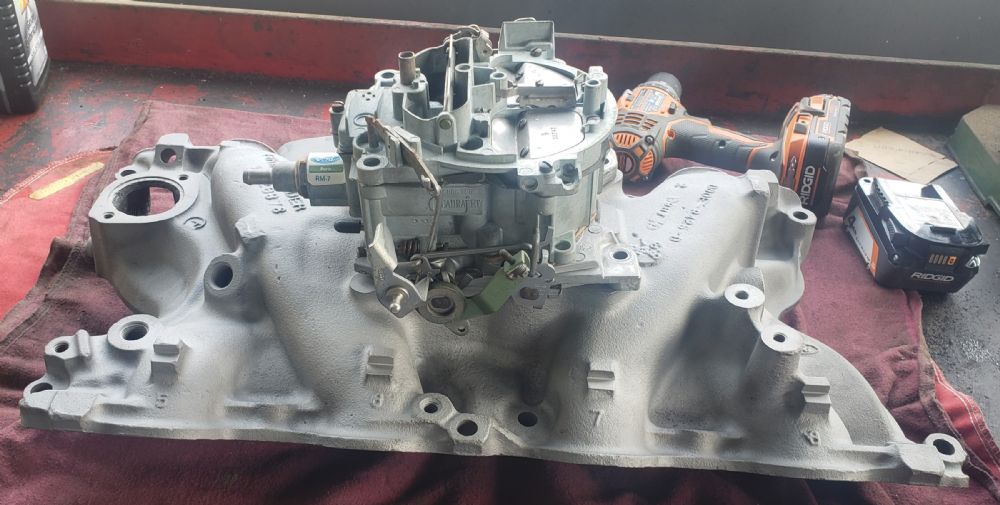

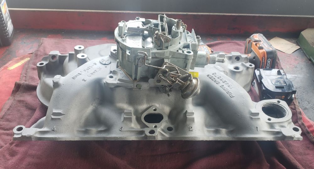

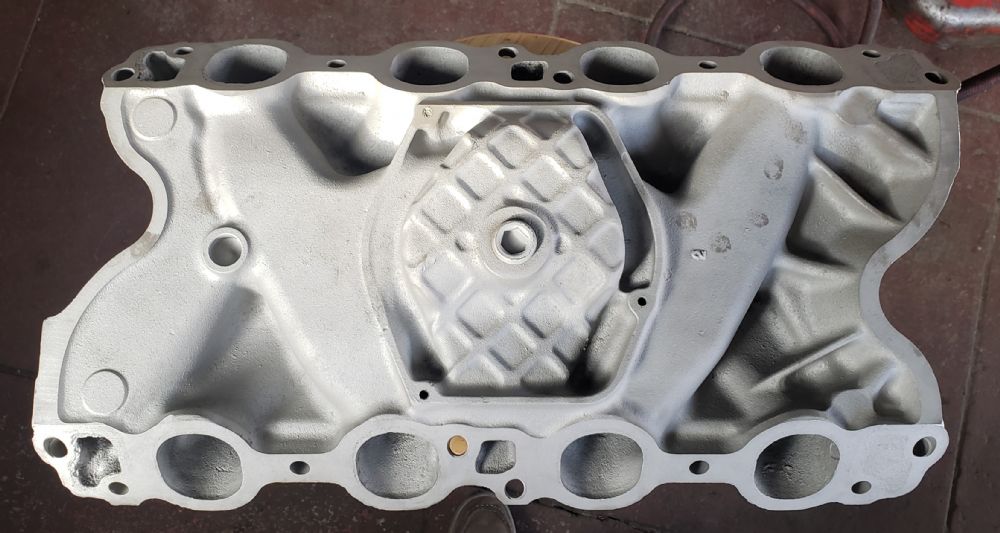

Post Options Post Options   Thanks (0) Thanks(0)   Quote TV 2M8O Quote  Post ReplyReply Direct Link To This Post Posted: 15-February-2026 at 9:31PM

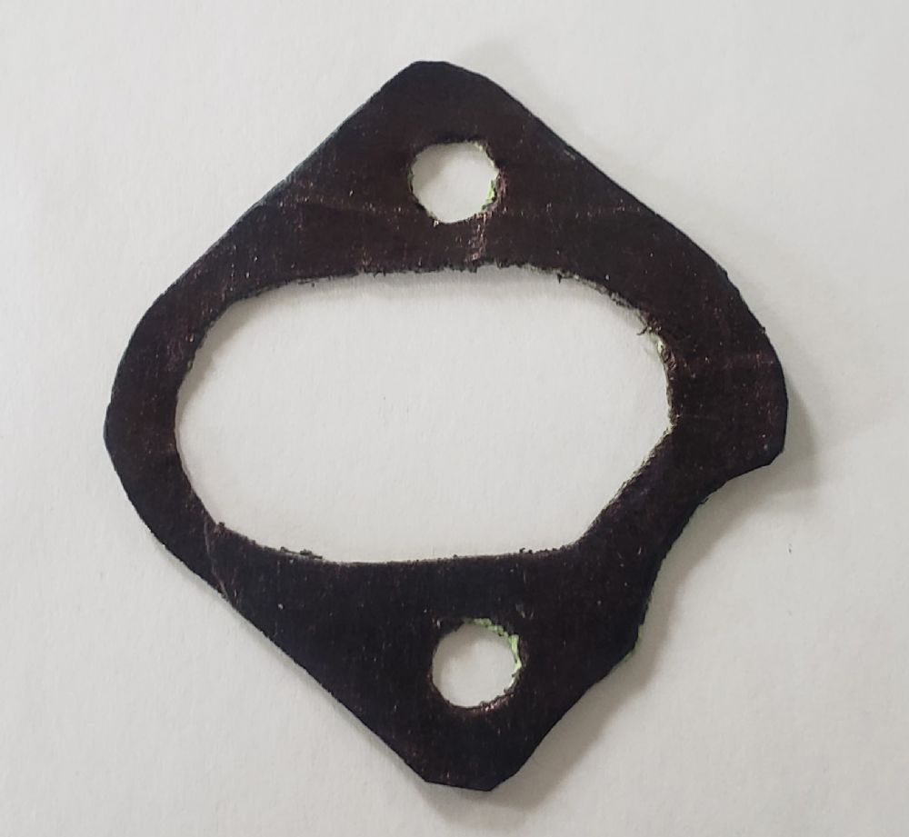

Finished removing a snapped off drive screw that secures the baffle to the underside of the Cobra Jet intake manifold (oops, didn't take an after pic!) ....
With the drive screw drilled out, I flipped the manifold over and set the QuadraJet into place to see how things lined up and what bits and pieces I still need to source to mate the carb to my engine. The QJ I scored was for an automatic, non-ac car but mine will have air so I need to find the correct bracket and throttle position solenoid to install on the carb.
The QJ also uses a divorced choke assembly on the 429CJ's....
so I'll also need to find the choke stove tube assembly, the pull down divorced choke assembly and the stove cover gasket. I looked on line prior to going over to play and found no one offers the correct profile gasket at a reasonable price ($18-$32 for this little piece Confused)....
so I just made a template and will make my own. Wink
My google search also turned up NO NOS choke tube nor divorced choke assemblies so I guess I'll also be making/adapting something to fill these voids. I'll be posting a second thread under PARTS WANTED with a couple sketches the parts in question.
Appreciate any and all leads to the needed ball fulcrum rocket arm parts as well as the Ford Rochester QuadraJet bits!! Also a recommendation and an informative QuadraJet manual??Ermm
