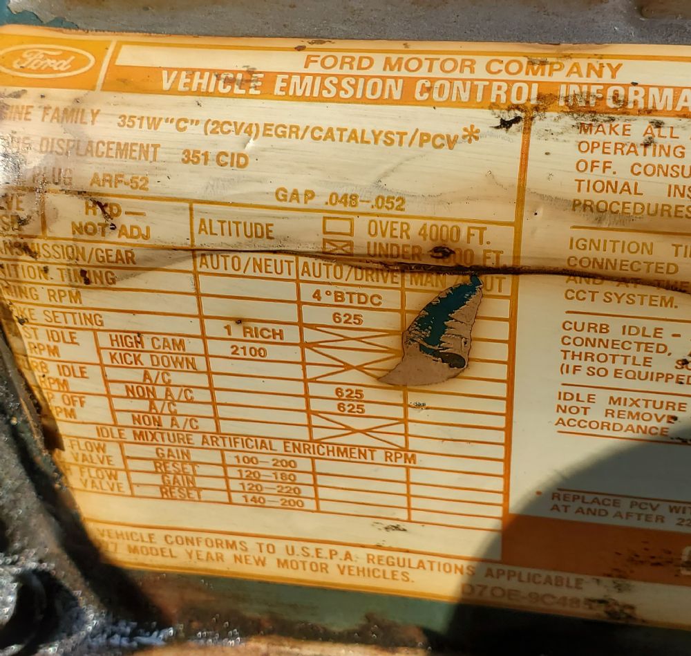

Long story short, I'm trying to set up my fast idle. I think this is a replacement carb, guessing a refurb, and it was never really set up beyond just getting the car in motion.
The car starts great - one pump of the pedal for setting the choke and a squirt, and it fires right off. Then I always had to feather the gas to keep it alive. Found that the fast idle screw had been left backed all the way out. Attempted to set it according to the sticker on the valve cover:
So, 2100 RPM on high cam at operating temp in gear neutral. There seems to be some debate online about whether the high cam is really the highest step or the middle step with the V. If I treat the highest step as "High Cam" it won't warm itself up, but if I treat the V step as "High Cam" it seems like the rpms are crazy for a cold motor.

2100 rpm seems like a lot to me, and are you sure it's supposed to in Drive?
i would think Park / Neutral

That is correct. 2100 RPM on fast idle step in neutral. Not in gear.
Warm engine, choke off, set while in gear.

Sorry, I brainfarted. It's 2100rpm in neutral - that's what it says on the sticker, and that's what I've been doing all winter. Why in the world I typed in gear, bleh.
It does seem high, but that's what the sticker says that seems to be what the car needs. I'd be curious as to what other people's stickers say vs what year their car is.

I believe the high cam is the highest position for the choke. The kick down setting is the middle position...or "V" as you describe.
From my own notes that I have scribbled down, my setting for my 351M is 1350 on the kick down and 600 fully warmed up in gear.
Those settings are what the factory calls for on a stock 2 barrel carb. During warm up, it will idle about 2000 rpm when cold and then after a few minutes, I kick it down where it idles at 1500.
I did kick the warm idle up to about 650 in gear where it seems happiest after the choke fully opens. At 600 rpm, mine tends to stall and run rough. That little tweak on the idle smooths it right out.
That 2100 rpm may seem a little high but in the cold weather, the engine needs the rpm to warm up faste and keep from stalling. If it's a fair weather car, try a lower adjustment...say 1800 on the high cam. You might get away with setting the choke there.

High step is the high cam setting IMO. What do you mean it won't warm up there? Do you have the distributor vac advance hooked up and is it ported or manifold?
I've only had one stock cam'd engine with a 2v carb. Startup I'd do like you, with one pump and crank, then another pump to get it onto the v-step and then drive away. I think the vee step was like 1200 or so, but I can't remember if that was in park or drive.
IIRC that engine liked closer to 700(in gear) base idle, and then 2000(in park) or so on high idle. The "v" rpm I don't remember 100%. It took a little tweaking every day to get it where I wanted it. The only real modification I did to that engine was to switch the vacuum advance from ported to manifold and bypass the high temp vacuum switch. I also kept that all connected(with air filter on) when setting base(hot) idle, but the decal stated to disconnect and plug the vacuum hoses when doing so. I'm not sure how you have your timing set up, so that might change how you set yours.
IMO those decal instructions only apply if it's a 100% bone stock unit. If any changes have been done at all, throw those instructions out. I feel that if you're feathering it to keep it running while cold and on the v step, it needs more rpm. If it's slamming into gear when cold, then you need less. The RPM numbers really don't matter, so long as it runs without feathering when cold, and doesn't slam into gear and power through the brakes either.
