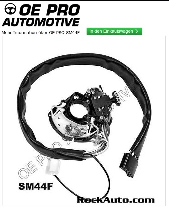

I'm just changing my turn signal switch. How do I get this steering column shroud of? It looks like this:
...and consists of 2 parts, but without screws.
That means they have to be clipped somehow.
I'm also looking for the right turn signal switch for my 72 gran torino.

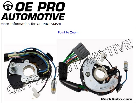

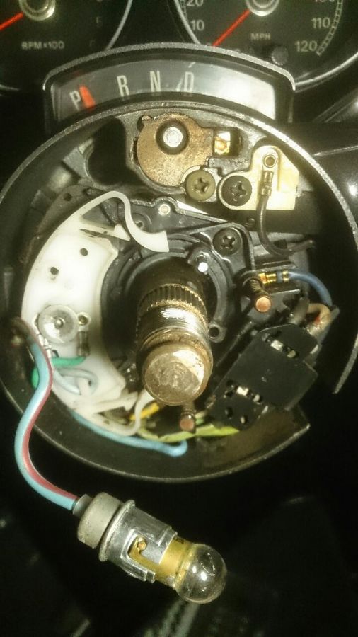

Mounted in my car behind a standard 2 spoke steering wheel is this one:
This would, however, according to my research of a 71er be.
I have only ever found the one for the 72 model with this layout here:
Which is the right one now? Confused

the plastic collar has 2 screws and it clips together but there are 2 plastic pegs on the end that slide off...one section slides off of the other. go easy and slow the pegs get messed up easy
the switch in the rock auto pic looks correct

There are no screws. I have already tried to slide off. Then I'll take a closer look at it again. Wacko
Although I'm still unsure, since this one of the 71er looks more like mine......
....but I will order the turn signal switch from the '72 and hope that it will work. Wink
