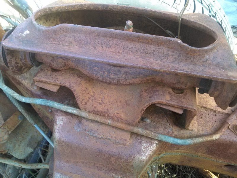

ok, so... here are the Upper Control Arms (UCAs). The 2 large bolt heads you see go down through the UCA Shafts through a slotted hole into a welded bracket/mount on the frame.
Carl N Dee Corey CAMBER (visible wheel tilt, in or out). IN is NEGATIVE that means the wheel lays down INTO the wheel well and looks like the rear wheels on an old Volkswagen bug or the passenger side tire of a NASCAR on a short track. OUT is POSITIVE that is the wheel tilted OUT and looks like the DRIVER side tire on a NASCAR on a short track.
Carl N Dee Corey You adjust CAMBER on our cars by loosening those bolts and pulling or pushing them EVENLY in or out. That moves them from negative to positive.
Carl N Dee Corey CASTER is the angle of the Upper Ball Joint(UBJ) in relation to the Lower Ball Joint(LBJ). NEGATIVE Caster means the UBJ is FORWARD of the LBJ as measured with a level stright up and down (PLUMB). NEGATIVE is like a shopping cart and all the OLD cars before they had PS, to help them turn easily, BAD HANDLING!!!

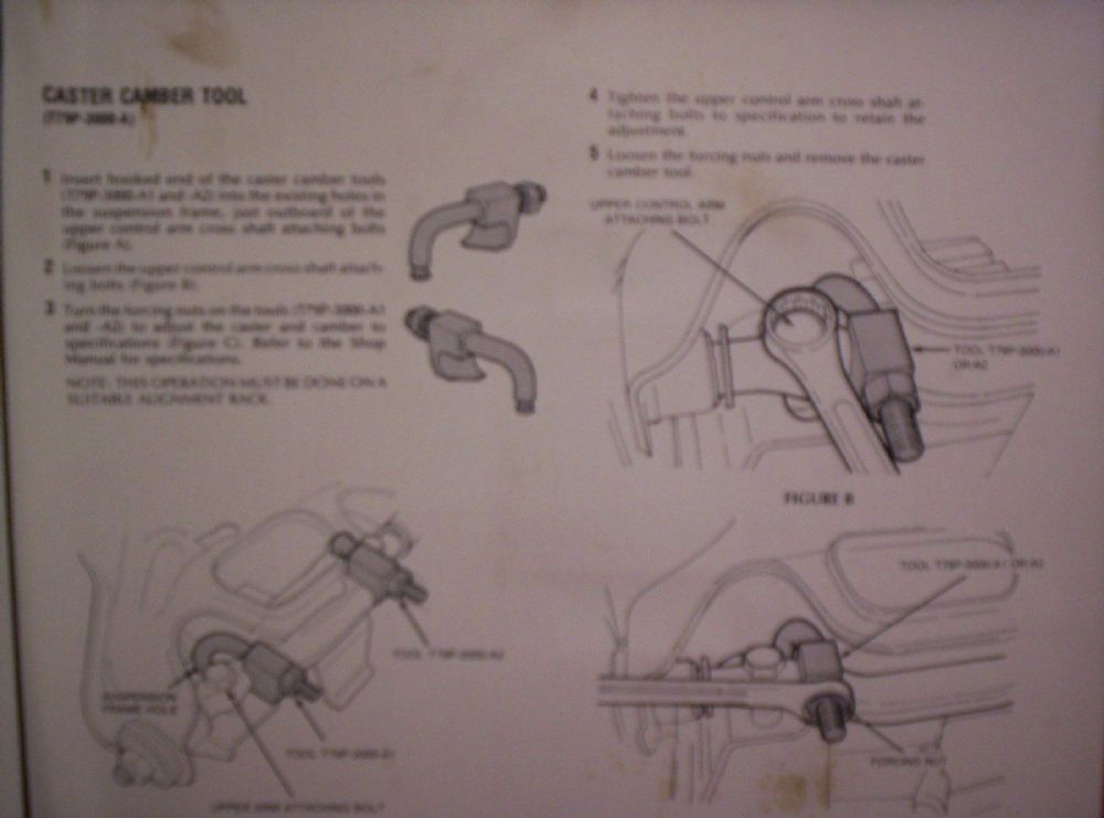

    Is there a tool to help with moving the UCA in the slots?
    There are a couple of links to tools but they are now 404

    I have found reference in a shop manual to adjustment tool T69P-3000-A, so now plenty of Google hits on how to do it.
