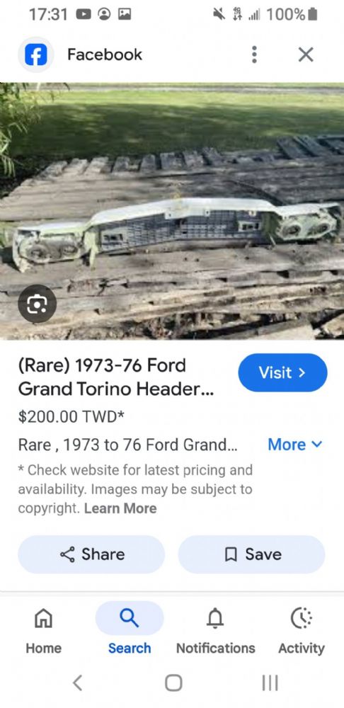

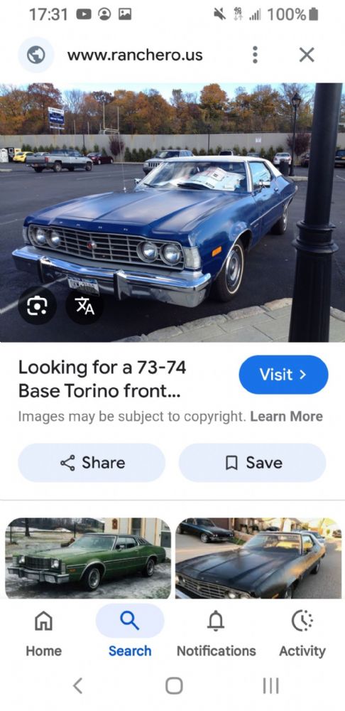

...header panel for 73 Torino/Ranchero? - The Ford Torino Page Forum https://share.google/RL1r3eFP0HAFccMtb
Sak7788 View Drop Down
Joined: 08-August-2025
Location: GA
Points: 45
Post Options Post Options   Thanks (0) Thanks(0)   Quote Sak7788 Quote  Post ReplyReply Direct Link To This Post Posted: 05-October-2025 at 10:42AM

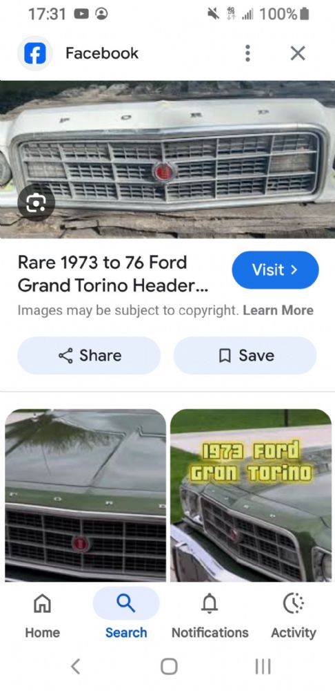

   That would be the "Header Panel"
 Pretty much best to find it with the Base model grill as a whole completele matching assembly since they are different.

Post Options Post Options   Thanks (1) Thanks(1)   Quote hogfiddles Quote  Post ReplyReply Direct Link To This Post Posted: 06-October-2025 at 5:21AM
Well there’s three … four, if you count the deflector……
the header panel - goes across the top
Headlight housings or buckets - one on each side
Stone deflector - which goes across the bottom

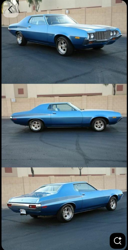

  The 72 base Torino is similar but also different from the 73 and up that I posted above. The 72 front is a one year only design due to the government mandated 5mph front impact bumper. It can be made to work if you have a donor and modify the front of the frame to weld on older style frame ends.
   72 only base model Torino just barely still showes the "fish mouth" of the more common Gran Torino 72. Also notice the non 5mph bumper on the front. 73 is a split year 5mph front but not rear bumper,  74 and up all had the government mandated 5mph impact absorber bumpers front and rear.
