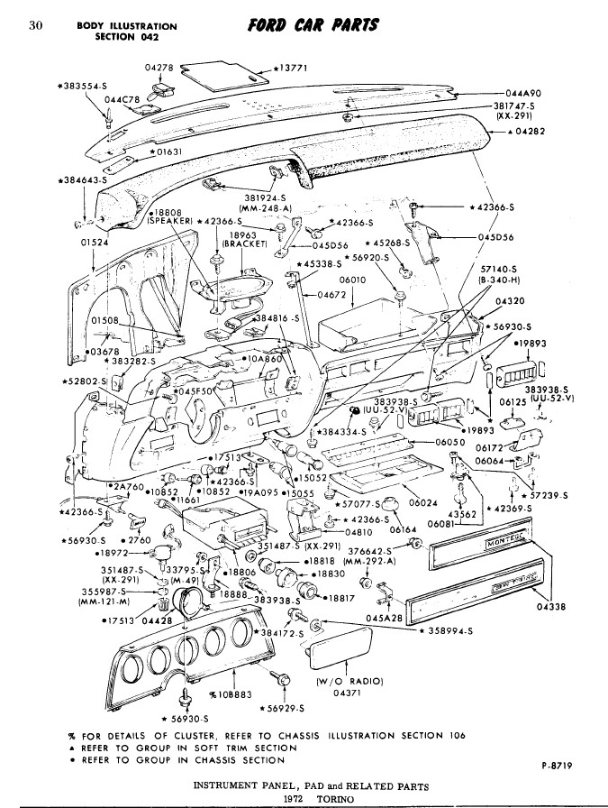

Post Options Post Options   Thanks (0) Thanks(0)   Quote schufitz Quote  Post ReplyReply Direct Link To This Post Posted: 10-March-2024 at 4:20AM
Here is an exploded view diagram from 65-72 MPC.  it's quite 'busy', but hopefully some help.

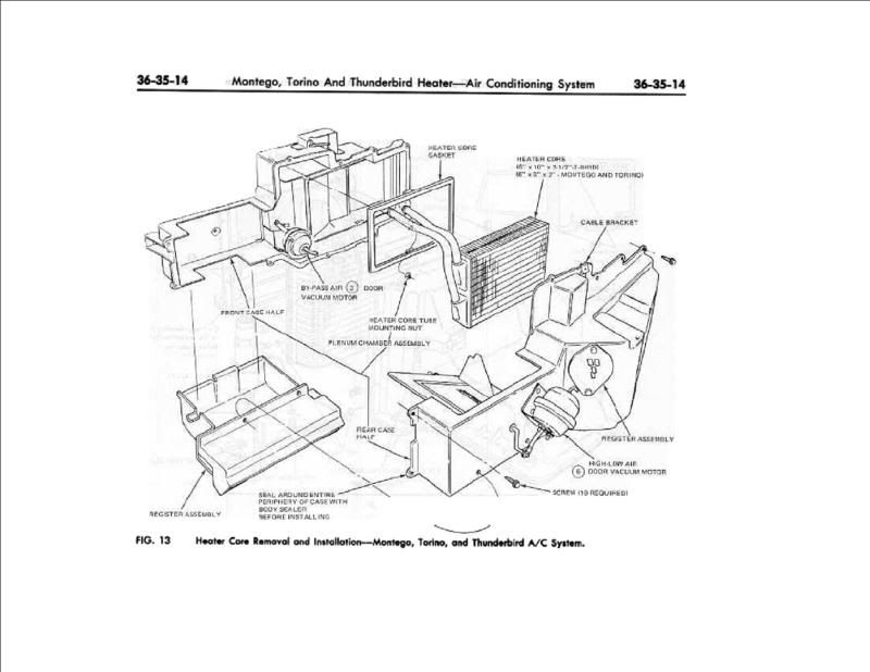

Heatercore replacement, you will need to go in the engine bay. Disconnect the heater core hoses.
There are a couple 3/8" bolt/screws that screw into the heater core box to the firewall from the engine bay side of the firewall. Down low bottom of the box.
Inside the dash, there are a couple more 3/8" bolts.
There will also be some vacuum lines that need disconnecting.
You can remove the housing. Be aware the thing will dump antifreeze if tilted tube downward.
(The tubes that go through the firewall).
The housing for the heater core has a bunch of 1/4" hex head screws. Best to use a hex driver, avoid prying this housing apart or it can break.
There will be a couple Dampener doors connected to vacuum motors. Not hard to take apart, just keep in mind during disassembly.
I'll see what I can find on the pages and post the actual instructions though here in a bit.
