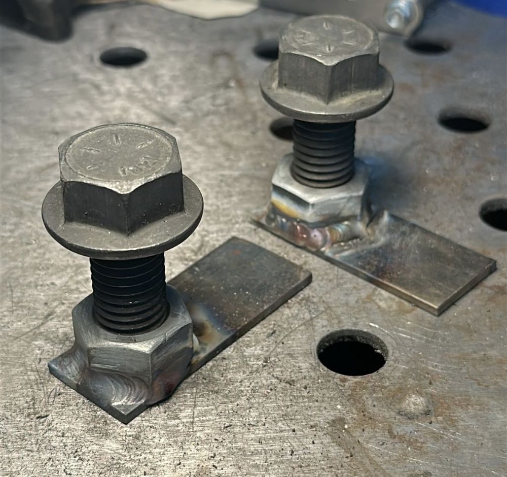

Just following up on this post. I mounted my AOD over the weekend. No modifications to the crossmember required. I used a stock AOD transmission mount and bolted it right in. Fits like it came from the factory! I believe a C4 driveshaft will work, I just need to confirm slip yoke diameter.
Only thing I had to fabricate were new captive nuts for the crossmember bolts, but that was easily done using some 5/8 nuts and 1" flat stock.
