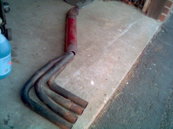

How do you get a zoomie that's not really a zoomie? You buy a header from a company that puts the word zoomie on some header lines and buyers can say they have zoomies.
Rock, the dragster you posted is an example of zoomies. One tuned straight pipe per cylinder pointing down and then up. They weren't about looks or sound. They were\are functional. They create a lot of down force that helps counteract both torque twist and front end lift. Top fuelers today have so much power zoomies are factored in to suspension and chassis design. This is information that can be found on the internet and not from anyone referring to jacket water.Confused
Are pipes that don't turn up zoomies? According to the old timers no but they became popular when zoomies made it to the street where the upturn wasn't appreciated by the cars to your right and left. FWIW and again from the old timers, the term zoomie was slang in the nuke industry for the unseen energy emitted from radioactive materials. Hot rodders co-opted the term.
zoomies:
Put a collector on the end of straight pipes and you've got a header which is not a zoomie.
I'm not interested with arguing this with anyone but when I refer to a zoomie I'm talking about a single, stand alone straight pipe per cylinder.

street zoomies ... the print says zoomie, remote mount w/extension Hahaha

Rock, I'm not sure what you're getting at with, "The print says. . .," but your link is defines what I grew up understanding what zoomies are. If your local cruise night is the Holly Reunion fwiw I'm impressed. Pretty short cruise though isn't it?

advance auto $70 ea & 20% off, actually not too bad. I've spent more on mufflers Embarrassed
the discount for the 'farm use' iron pipe mishap doesn't look bad either
No doubt but that same discount import company probably has $25 mufflers to go with their $70 dollar CAT. Nothing wrong with either.
