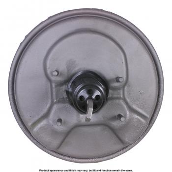

If the photos online for that part number are accurate, then no. You'd need the bolt pattern to look like this:

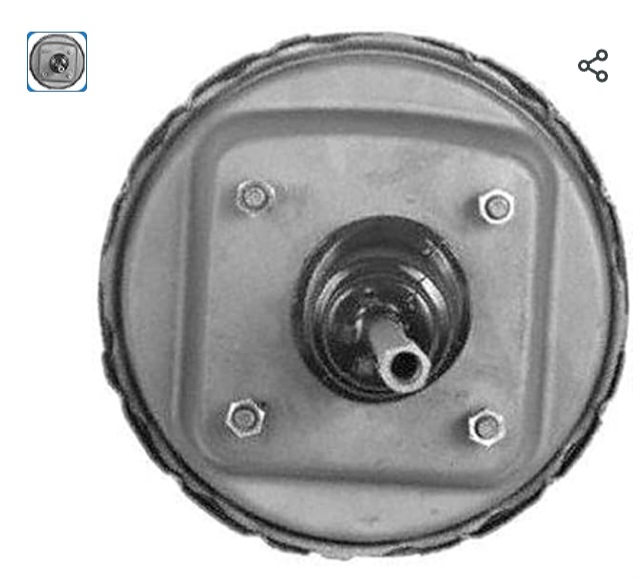

Post Options Post Options   Thanks (0) Thanks(0)   Quote svENzoN Quote  Post ReplyReply Direct Link To This Post Posted: 24-June-2025 at 9:36PM
Really?
I found that...square pattern which should fit...
...every source says that it is a square pattern with 3 3/8" and that's also what it looks like when I look inside behind the brake pedal?

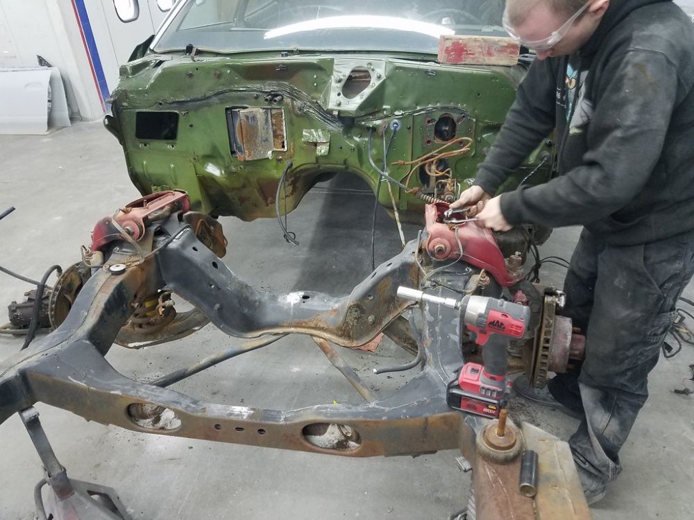

Post Options Post Options   Thanks (1) Thanks(1)   Quote Inkara1 Quote  Post ReplyReply Direct Link To This Post Posted: 25-June-2025 at 12:11AM
In this photo from a project on a 1973 car, the bolt holes for the booster can be seen next to the man working on the car. The holes aren't in a square pattern in this photo.

Post Options Post Options   Thanks (0) Thanks(0)   Quote svENzoN Quote  Post ReplyReply Direct Link To This Post Posted: 25-June-2025 at 12:40AM
Ur right. Thank you.
Hmmm...somewhere must be a mistake here...???
