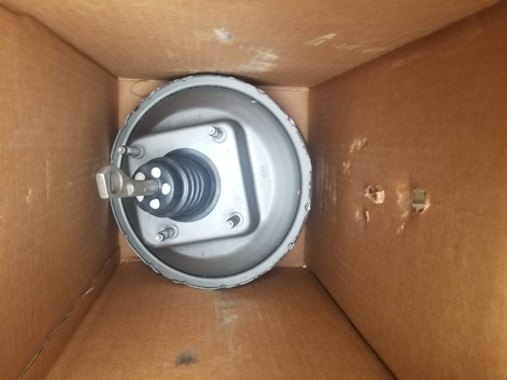

It arrived, but looks a bit different. The front half of the booster is all uniform in appearance, whereas the original has the flat areas. Will measure it and have a proper comparison when I get home later.

The part is quite wrong.......
Only 9 inch diameter, and the studs are in completely the wrong place too, far too close together.
Have emailed them for a replacement, as I'm not sure if it is just a misboxed part.

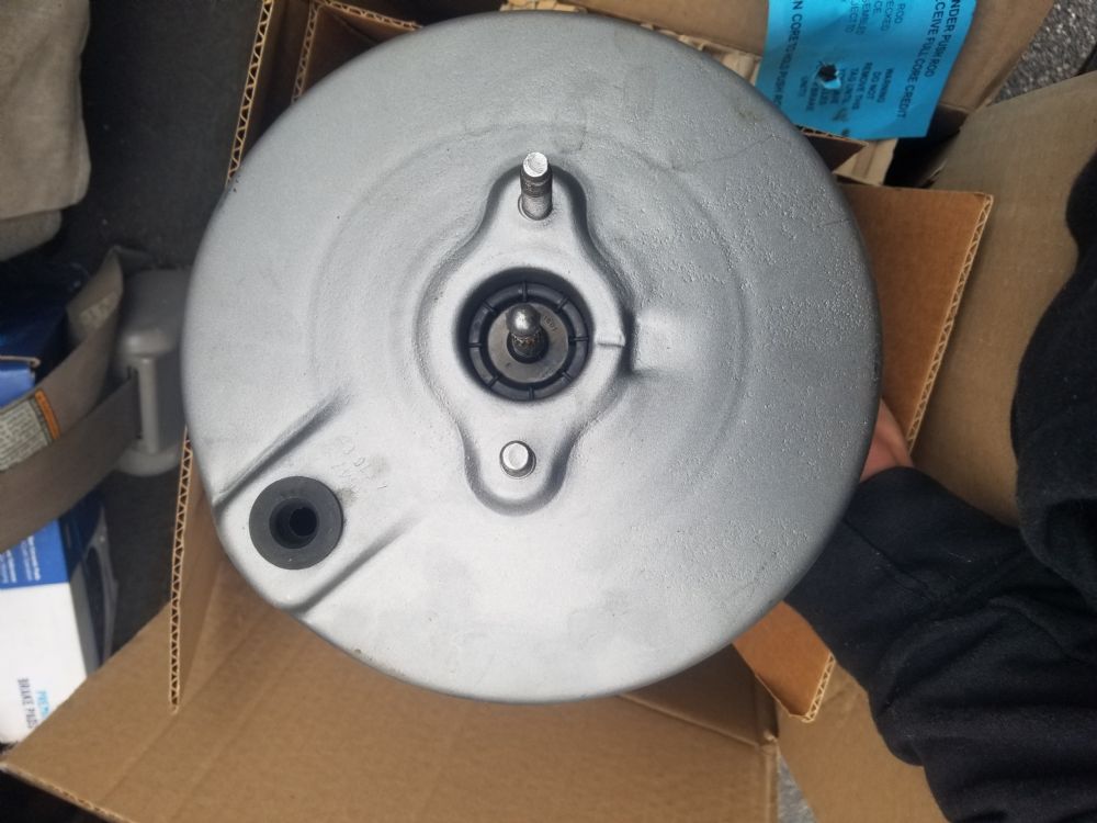

   I don't hate it. Well, upon initial inspection the firewall side dosen't look bad, hopefully I can get a chance to swap it out this weekend.

Looks like the same one I was sent. Firewall studs are too close together widthwise, and passenger side are too high up. Can't even swap the insides over as it's only 9 inch diameter.

  Yeah, that's a huge difference, not even remotely close seeing them side by side...    what is that even supposed to fit?    Sooo close, yet sooo wrong, all at the same time... 🤔🤯😐

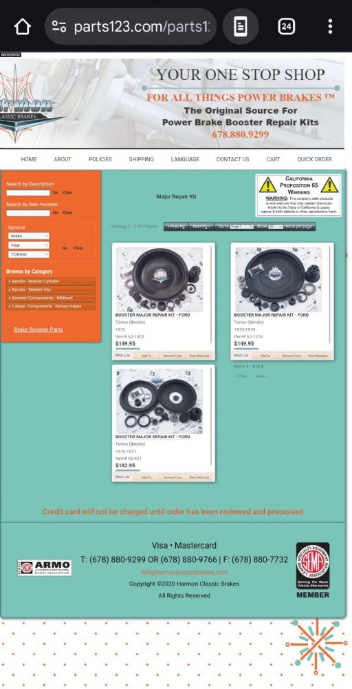

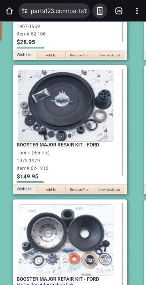

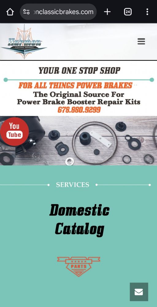

 https://www.parts123.com/parts123/yb.dll?parta~dyndetail~Z5Z5Z50001029z~Z5Z5Z5AAFQI~P149.95~~~~S7BB0LGCZT17256642980a~Z5Z5Z5~Z5Z5Z50001029z
So I went down the rabbit hole last night... Plenty of how to vids for diy-ing it on YouTube. Here's the kit you would need to do it yourself.

That's the best one I found previously. Works out at around $350 delivered to me here in England.
May be my only option, and it'll have to wait a little while!
