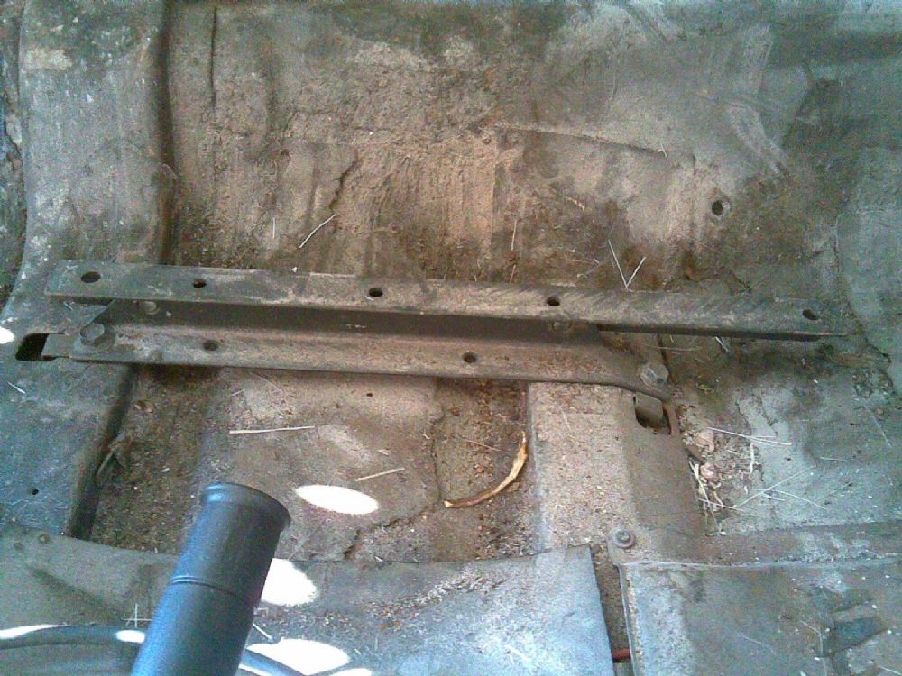

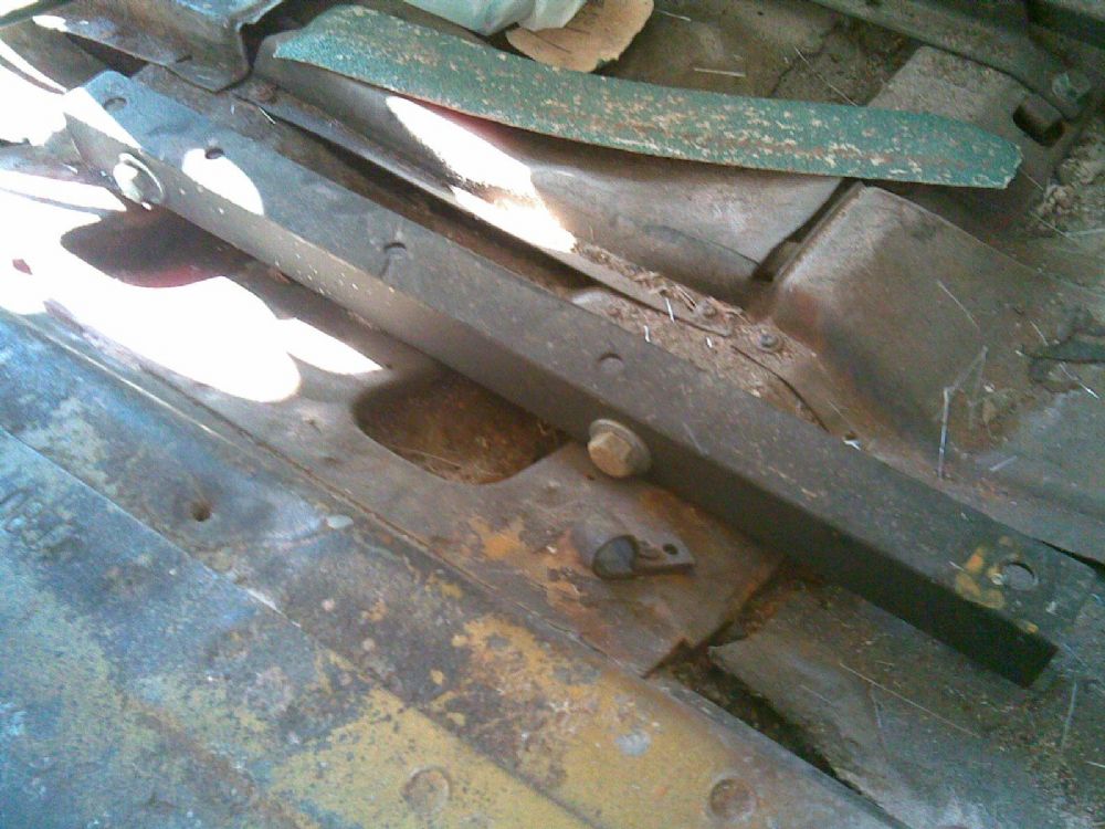

wasn't really that hard ![]() i'm not sure exactly what the floorboard geography of the 69 is but The Man In Black said anything will fit with an adapter kit. i came up with a pair of seats from a Plymouth Laser and angle stock donated from a highway horse. one angle fab'd to fit the floor and another inverted to mount the seat to. nuts welded to on side and bolts through the other make it incredibly adjustable. the low profile of the Laser seats and the riser provided by the mount makes the seat sit about perfect, and they're solid AF ![]() ![]() ![]() -
