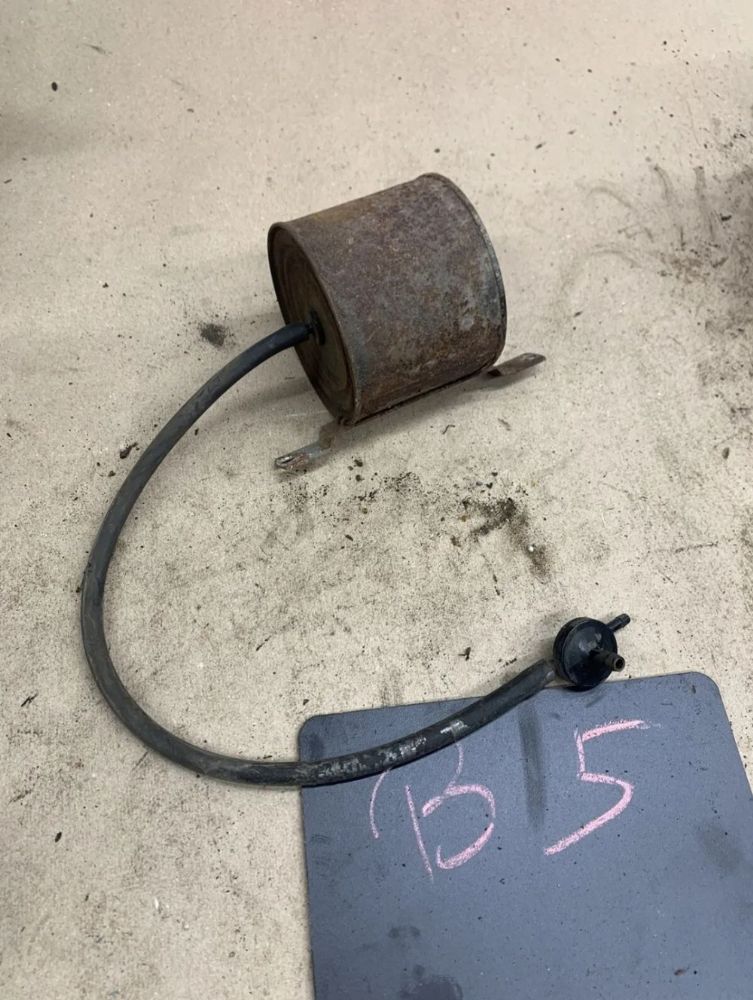

Post Options Post Options   Thanks (0) Thanks(0)   Quote Dino Quote  Post ReplyReply Direct Link To This Post Posted: 27-September-2023 at 1:08PM
Is this the stock kind for a 76? It goes on the driver side inner fender?
Or this one?
Post Options Post Options   Thanks (0) Thanks(0)   Quote Eliteman76 Quote  Post ReplyReply Direct Link To This Post Posted: 27-September-2023 at 2:20PM
Depends. Sometimes you has cruise control tied into the vacuum for the vehicle as well.
You can use either can, I would just source fresh hose from a parts store though. I discovered on my '72 last year when swapping carbs all my vacuum hoses were dry rotted, which was one of my issues on my engine idle quality. Also affects brake pedal feel.
With the AC setup,  you need to run the coffee can to help keep the vacuum to the blend doors otherwise instead of dash vents, I think it defaults to the defrost vents.
