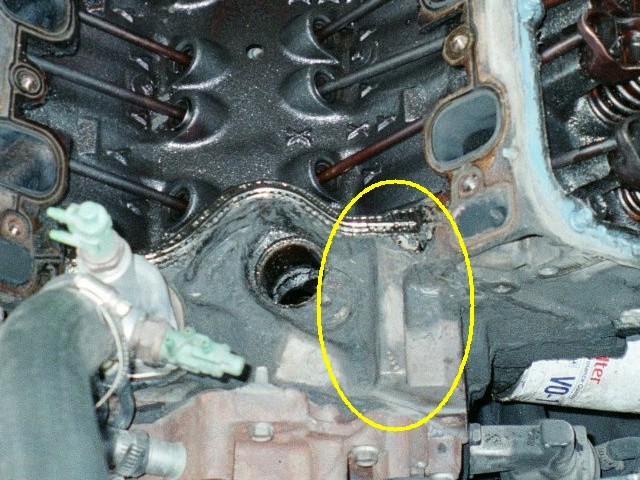

The Cleveland heads all have eight bolts on them. The 351M and 400 have Cleveland heads(2V), but the blocks are huge compared to a small block 351C.
Look at the block next to the thermostat housing to the right, the shape around the block and head. The 351M and 400 both use the same block, the heads are raised higher by an inch above the thermostat area, more than the 351C. That area has a metal wall coming up and out from that area on the right side. I've never tried to describe it, I've just looked for it countless times in person and in pictures.
Here's a picture I just found which shows it, and it's circled, the picture says it's from this forum too.

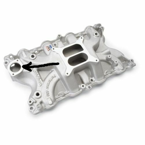

To determine which engine is in the car you will have to look where the upper radiator hose is connected to the intake manifold. If it is a 302, 351w, 390 or 428 engine, the radiator hose will connect to the intake manifold at the front of the manifold facing the radiator. The arrow in the picture below points to it.
The 4 engines above have similar looking intake manifolds but the 302 and 351 engines each use a different intake manifold. The 390 and 428 intakes are also different from the 302 and 351w manifolds, but they might be interchangeable on the 390 and 428 engines.

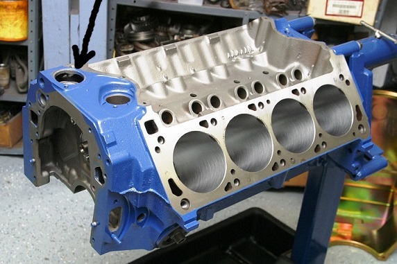

The black arrow in the picture below points to where the upper radiator hose is connected to the engine block on a 351 cleveland engine. The 351 modified and 400 engine blocks look very similar but the 351M and 400 use a different engine block.
